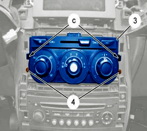

Once you've removed that you gain access to the heater control panel:
Remove the bolts (4).
Unclip and disengage the manual air conditioning control panel (3) (at "c") towards the interior of the dashboard.

It does;- have you disconnected the cable attached to the specific control that won't move more than 2/3rds to test whether it is the dial that is stuck (internally to the heater controls) or whether it is further down the line.
From my previous post, the last picture shows the triangular plastic piece on the left that is for the temperature adjustment (which controls the mixing flap between hot or cold).
A little more detail below:
"A" The user actions the Temperature Control.
"B" The temperature control operates a gear which pulls or pushes the cable depending on the command.
"C" The cable operates a gear on the aircon unit: The gear is connected to the upper mixing flap.
"D" The gear drives a rod connected to the lower mixing flap shaft.
So if there is a problem further down at the flaps, then I'm not sure what sort of access if any you have without some dismantling...
