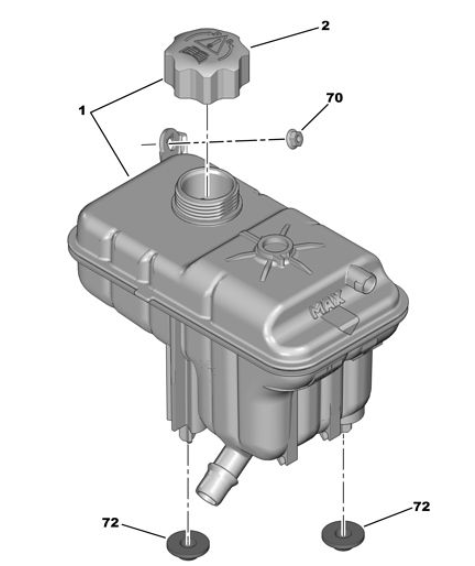

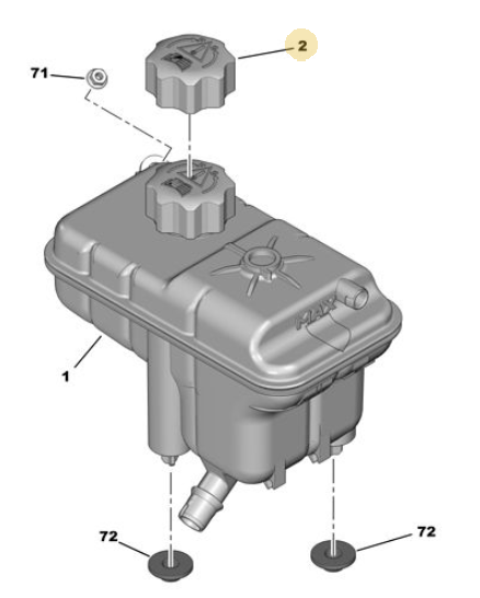

1323V2 was the part number for the actual expansion tank - no longer available. from Citroen.
Note the fixing points and specifically, the front centre cylinder mount is different on some of these alternatives.
The following were the alternative tanks, but there are some differences (I've put the part numbers in brackets for you):

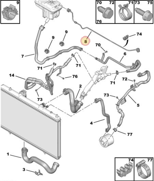

As for the hoses, it depends which one you are after:
Item (7) is no longer available, but item (8) is available.
Part numbers for both:
(7) 1341H0
(8) 1323H9 £18.78 inc UK VAT direct from Citroen.
This one is for an EW7J4 Petrol (1323V1) It has a slightly different top left fixing mount and the centre front cylinder has a cut out section. | This is from an ES9a Petrol (1323V2) This one has a float level on the top and a different rear right fixing. | This one is from a DV6TED4 (1323S8) This one has 2 pipe connections. |
(7) 1341H0

Re: 2006 C5 V6 expansion tank / bottle
Thanks!!!
I think I'll go with 1323S8 as it is the most avaliable and looks like it will fit with no problem.
The hose that broke is number 8 in the chart. I epoxied back into place and it works... could I replace that entire pipe with a standard hose and clamps?
Ok, so (8) is the Expansion Chamber Water Hose, part number and price above.
For the price of a new one at under £19 I wouldn't take a chance to be honest. I'd just get a proper genuine one.
