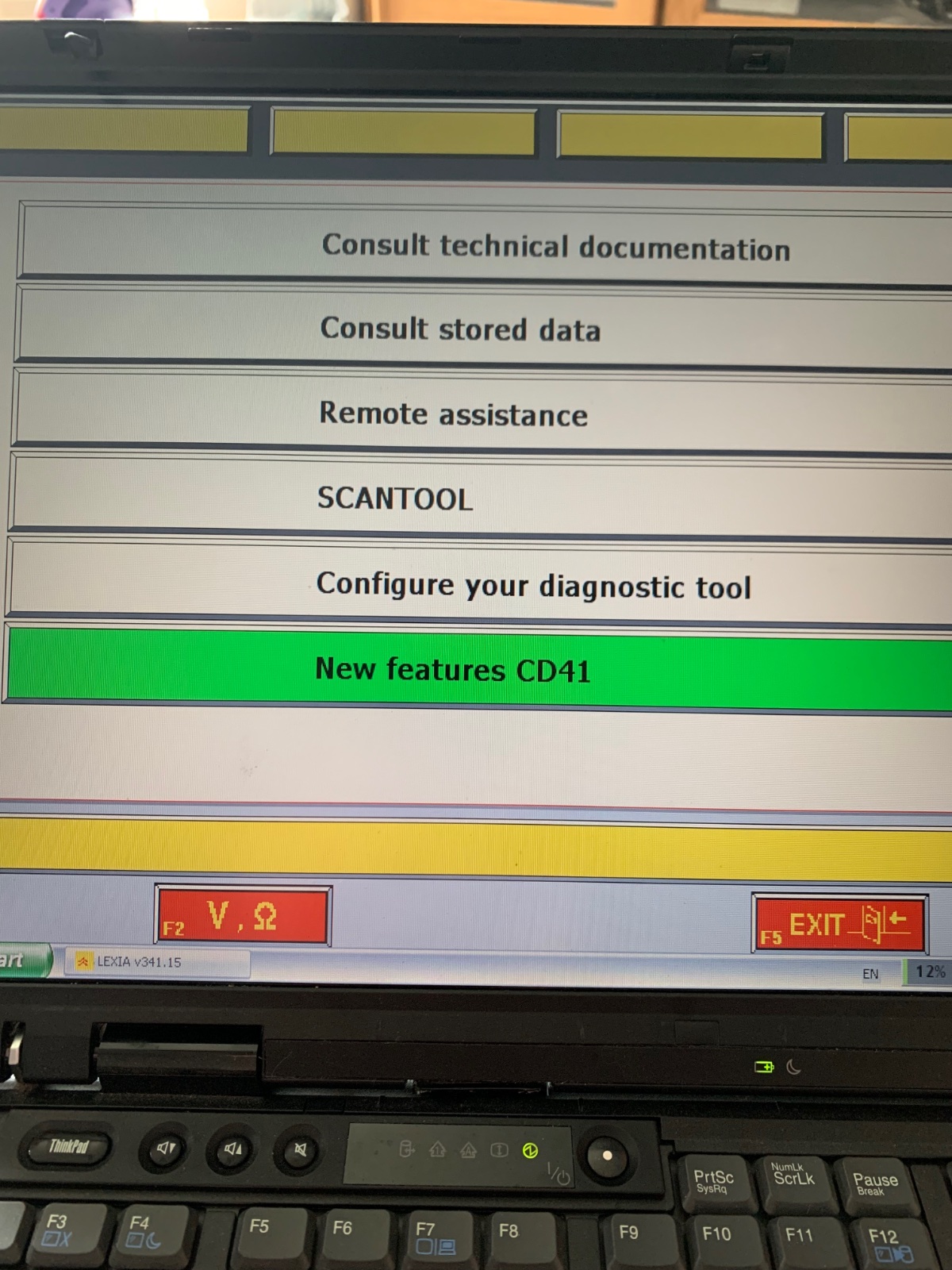

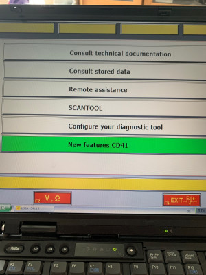

To see the Lexia version just go to the main menu & scroll down, you should see a menu “whats new in CDxx then when you select it you can see main new features that have been added. This one was for the release of the X7 C5.

To see the Lexia version just go to the main menu & scroll down, you should see a menu “whats new in CDxx ...
Sorry, my Lexia doesn't have the menu you mention.
