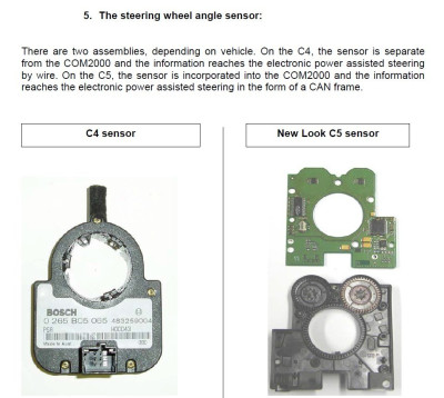

Had to check this as there was something at the back of my mind telling me the steering angle sensor is separate to the coms unit, on the fixed centre steering wheels the coms unit is horseshoe shaped & can be removed with the steering wheel still in place. Still leaning towards coms unit but not sure now how the ESP/ABS faults are linked.

I would guess that, if the steering angle sensor is playing up, the ESP would not 'know' where the steering was pointed, and so it (and, because they are linked, the ABS) would have a hissy fit.

I understand that & if it was a model without a fixed centre steering wheel then the steering angle sensor is incorporated into the com2000 unit which also links the Airbag, wiper & lighting faults, on this C4 The angle sensor is a separate part from the lighting & wiper stalks though. If it was a model with the angle sensor i would have said coms unit all day long.
I am still leaning towards comms unit though.

Well if you unplug the angle sensor the ESP/ABS light will definitely come on.
When the com2000 cant talk to the BSI it goes into backup mode which makes the lights & wipers come on.
