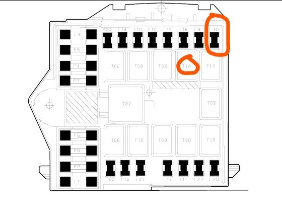

Re: Boxer heated mirror fuses
Well this one does seem a bit of a minefield, I can actually see 2 contradictions in the vehicle characteristics.
Can the OP confirm if there is a button for the heated mirrors on the dash?
I had a quick look at a wiring diagram based on the vehicle details as best as possible (as said there are loads of variations).
According to the one i looked at it shows the fuse to be fuse 30 in the under bonnet fusebox & the relay is T14.
I do know from experience however that the wiring diagrams on the Fiat based PSA vehicles are not always the most reliable & its not uncommon to have a mistake or two in them. Same applies to servicebox (not just on Fiat based vehicle here), there are often mistakes with parts even when checking with the VIN.
P.S. It is way easier to get into the under bonnet fusebox with the left headlamp removed.
