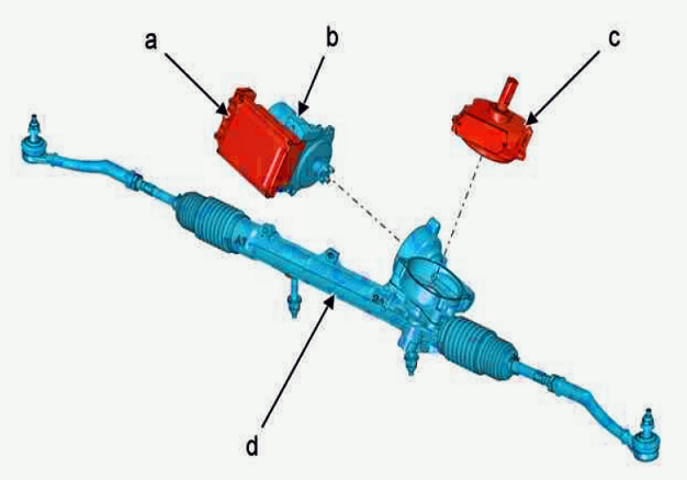

A p0606 fault can be the Power steering ECU, battery, connectors or electrical harness.
@Robert: It may seem a bit expensive, because they have to undertake several tests to ascertain the problem and if by some chance they cover it, they will need to follow guided diagnostic procedures before they themselves can claim the cost back.
Best of luck sorting it out with them.

Well I can see straight away from that diagnostic screen that the supply voltage is way too low, assuming that readout is for the power steering motor itself. It's hard to tell from the portion of the display shown.
The electric power steering motor consumes a minimum of 0.8A with a voltage of 13.5 V when it is applying no assistance.
The electric power steering motor consumes a maximum of 90A with a voltage of 13.5 V when it is applying the maximum assistance.
So with 3V not a lot is going to be happening.
I've just checked and the 3.0 V reading is for the Electric Motor Supply Voltage, so it's way too low.

They should find it easily enough, but I suspect they will just replace the ECU or the torque sensor or maybe even the whole thing.
"a" Electric power steering ECU.
"b" Power steering electric motor.
"c" Torque sensor.
"d" Steering rack.
"c" Torque sensor.
"d" Steering rack.

Today was the day for our Picasso C3's Diagnostic check after the recent Power Steering failure that we had in Portsmouth City Centre.
We went to Yeomans Citroen in Fareham in Hampshire and left the car with them at 09:15 and at 10 am we were told the following;
Carried out diagnostic checks read fault code
Checked all connections and electrical feeds and traced to electrical power steering module
Fault required new module - Replaced module under Citroen Goodwill.
Yeomans fortunately had a module in stock and fitted it to the Picasso and called us at 2.:45pm to say the car was ready for collection, as you can imagine my wife and I were delighted with this result and only had to pay the £126 Diagnostic Check charge.
So we have a big thank you to FrenchCarForum and its members for the information that many kindly gave my wife and I. We now feel it was a small price to pay for our safety on the roads as there was no telling just when it may have failed again, and who know what may have happened.
Thank you all once again for 'just being here'. Kind Regards.
