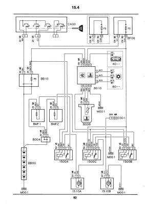

That is essentially the right circuit diagram for the 3-relay system, with helpful annotation for the two speeds.
For your car (1995 Activa, with A/C, RP6888=18Sep1995 - so Series 1) this is the circuit in Citroen's Electrical Wiring manual:
? click to enlarge If replacing the relays, they are all standard 30/40A 12v automotive type.
The changeover one is 5-pin, and must be in the right socket for the system to work.
Although the other two are only "make" 4-pin type, you can play safe by using 5-pin changeover ones in all three sockets.
If the sockets are "up front" near the nose-cone, they can suffer from weathering and socket/pin corrosion.
Check/replace the relays and their sockets first.
The non-working fan could be
- its (maxi) fuse blown or poor fuse contact
- fan gone open circuit - in which case Slow speed would not work at all, only Fast with one good fan operating
- fan gone short circuit or seized - Slow speed would show up as Fast, and Fast speed (fans in parallel) would cause a blown fuse
Hope helpful.
Let us know how you get on.
Hope helpful.
