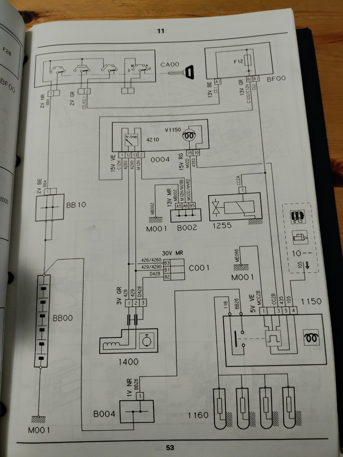

Hi. Looking for Xantia Mk.1, sinker, wiring diagram, 1.9D NON Turbo with lucas pump wiring diagram for the stop solinoid on the pump.. please.

Is that with or without immobiliser?

Sinker xantia 1994. With nothing but basic central locking..

No immobiliser in xantia diesels untill the semi electronic pumps with ecu to control the stop solinoid and keypad added.
I know petrols had them from the off though.

Hello this is injection wiring diagram from 1994, NA 1.9 diesel
feel free to ask what the device numbers mean

Ah cool. I can get the key from the wiki page. Cheers for that..

citroenxm wrote: 27 Oct 2021, 21:02 Ah cool. I can get the key from the wiki page. Cheers for that..
PS it is for LHD, but it schouldnt matter here?
