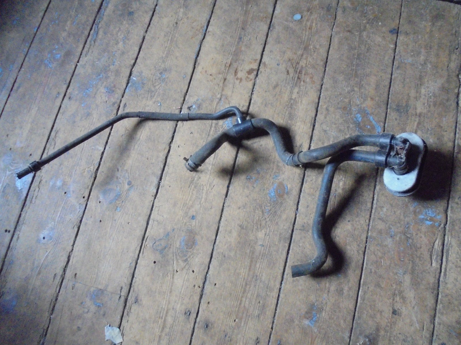

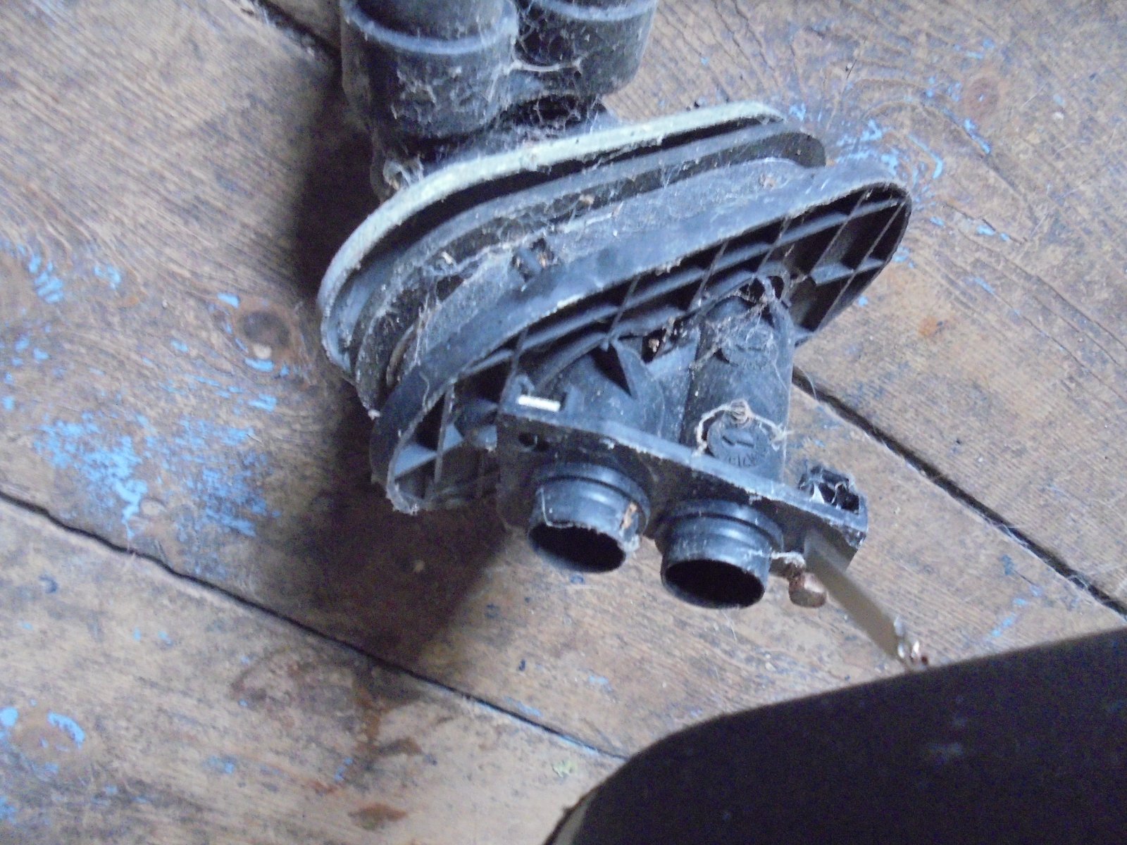

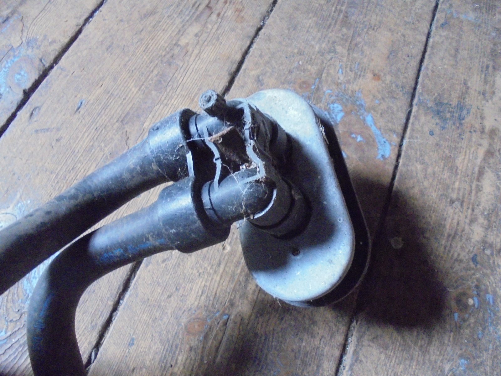

Should you break this very fragile item here, it is apart from a clutch pedal, the only item remaining in my shed from dismantling and scrapping my Xantia's (both series 1.9 TD's) many years ago. You can have it gratis of course, just let me know.Mandrake wrote: 27 Oct 2021, 10:38 Where do I sign up to join the leaky heater matrix club ?
Anyone have any pointers on how to do the matrix in a S1 Xantia ? Things like where to find all the bolts and how to disassemble the dashboard etc, any gotchas etc...(steering wheel removal?) believe it or not, I've never changed a heater matrix before in 30 years of driving Citroen's!
Can the car be started and run to test the new matrix and pipes are leak free before the dashboard goes back in ?
Its the bit and pipework that the heater matrix is connected to on the engine side of the bulkhead.
As far as dismantling to get the matrix out, I abandoned the job seeing as I broke said part (not the one in the pictures) by-passed the matrix connection with some copper tube, and ran the car without a heater from that moment on.
When I dismantled the other car I realised why the Dash proved impossible to remove.
If I recall right there are three dash mounting bolts poking through the bulkhead one at each side and one in the middle. Had missed the one in the middle in my previous unsuccessful attempt to do the heater matrix properly!
