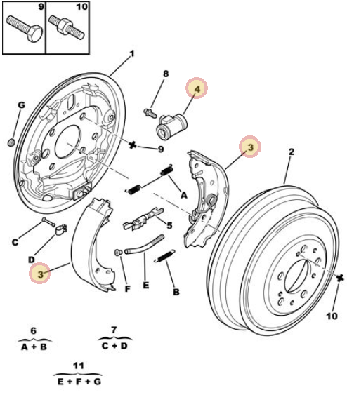

Good afternoon, could someone supply the parts numbers for the rear wheel brake cylinder please for this van VF7**************[VIN obfuscated, can be read by forum staff] . I'm also going to change the shoes as they are covered in brake fluid. Last time I looked there were 2 options. Get the complete kit (cylinder, shoes and springs) or get the cylinder and shoes without the springs.

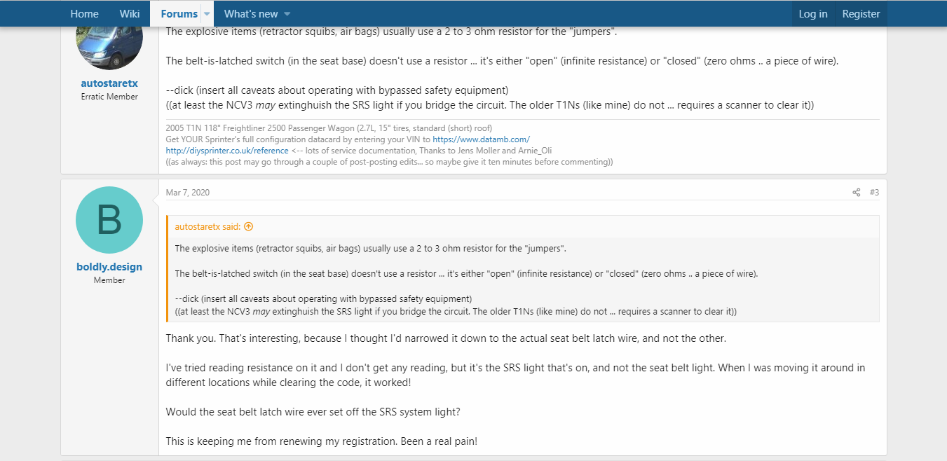

I take it the yellow lead comes up from the floor. If it is only for the passenger seat then it sounds like you need the yellow cable connected up to bridge out the lack of seat belt connections in the seat. How many pins/cables does the yellow cable have?

Ok, here you go:
Brake Shoes
OEM: 4241L2 £458.20 (set of 4)
Cheaper: E170305 £123.04 (unsure if this is for a pair or 4 - so you'll need to check).
Cylinder
The original Part (4402E4) £127.36 each may no longer be available, so they propose:
4402F7 which come in packs of 2. £214.28
Brake Shoes
Cylinder

if you put "seat belt latch" into "search box" above it brings up a few threads and I have seen this on the Sprinter Forum before. It kinda says it all.

More lottery style parts pricing from PSA!! If you can't get them much cheaper than this (and a quick google suggests a more reasonable price of around 1 / 20th of the Pug price) then I would get them relined.

Found some, bit cheaper
https://www.piecesauto24.com/ridex/8098349
https://www.piecesauto24.com/ridex/8150069
