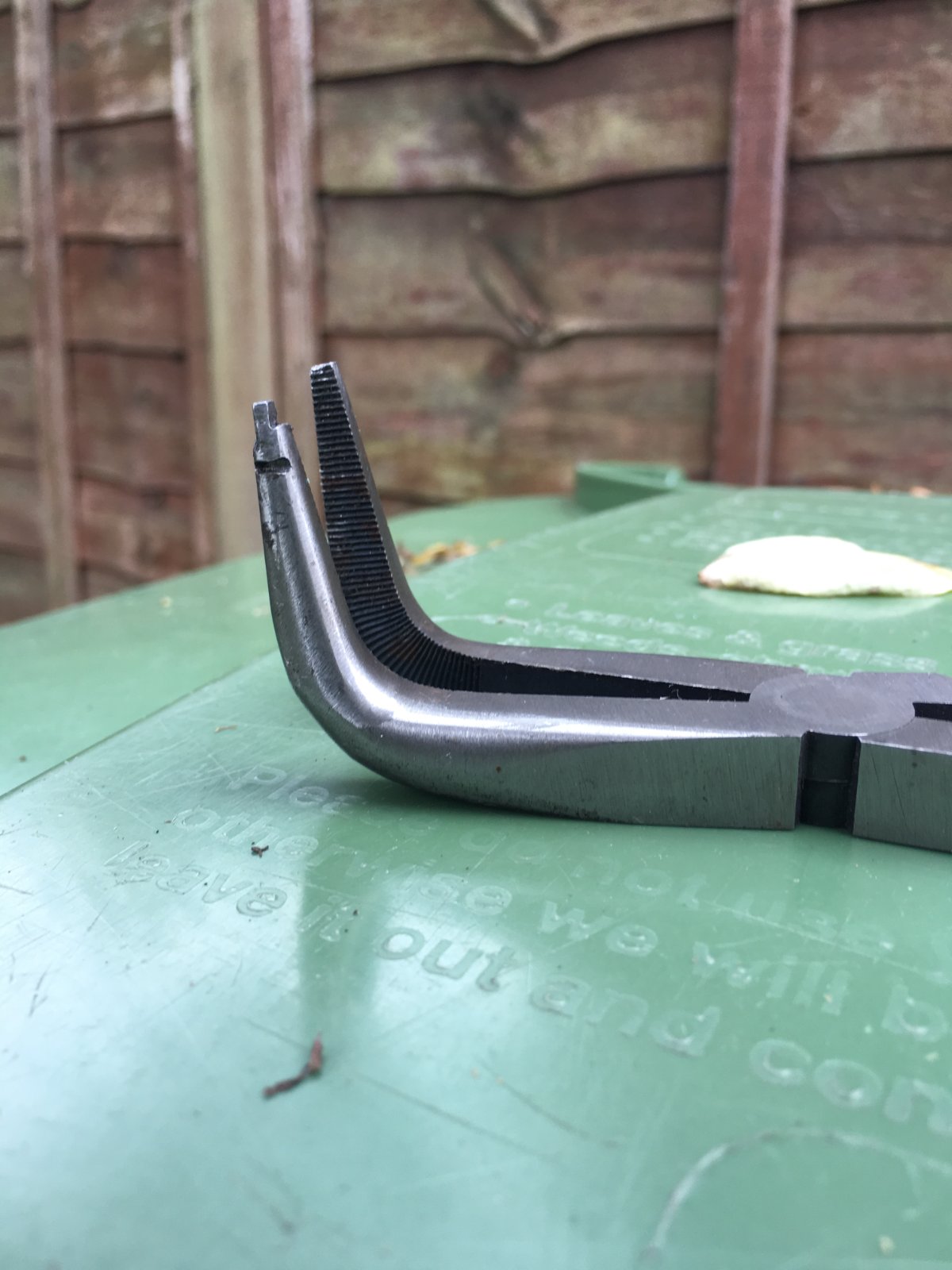

Also, the wire gaiter clamp is very difficult to get back on. Last time I made a tool by filing a 90 degree 250mm long nose pliers so that one of the pointy ends was shorter and thinner. The 90 degrees means both blades stay parallel and don't slip off the wires when you're closing them together. I guess there must be a factory tool.

I couldn't get the clip back on either until I made a tool to do it. If someone can tell me how to upload an image or how to email one, I will show you what I did.

gaiter clip tool. Nearest point filed to sit into "u" shaped wire on clip.
Farthest point is longer to sit over the wire you are trying to pull the "u" wire onto.
Tom.

Re: C5 2006 2.0 HDI Exclusive - rear hydraulic piston issues
Tom, can I borrow it for a couple of weeks please?
