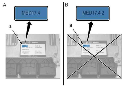

- x 6957
Re: Ep6 5fs 5fw help
This fault will depend on the exact version of Engine ECU that you have.
Check the Injection ECU label. You will have either on of the following MED17.4 or MED17.4.2
Let me know which you have as it makes a difference to the fault codes.
vladd.alex
- Posts: 71
- Joined: 06 Jan 2014, 18:34
- x 4
I will have a look tomorrow. But I can already tell you every accessory from the 5FS engine is present, including the ECU.

- x 6957
Engine ECU BOSCH MEV17.4.2
| Fault Code: | P15A0 |
| Description of Fault: | Lubrication system: Oil pressure too high in mechanical mode. Possibility 1 Comparison of the pressure with a threshold at 300 mbar Possibility 2 Too many successive transitions into oil pump downgrade mode while the pressure is too high (Greater than 5) Possibility 3 The pressure is too high in relation to the engine speed (Pressure gradient above 10 for 50 ms) Conditions of activation of the diagnostics The following conditions have to be met: - engine running - Battery voltage correct |
