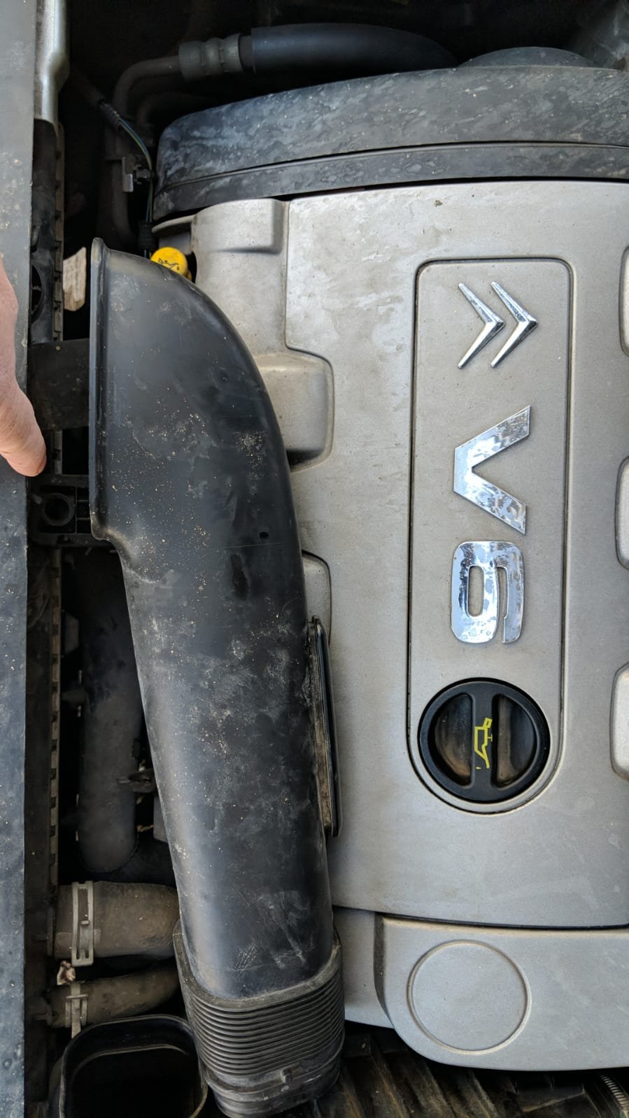

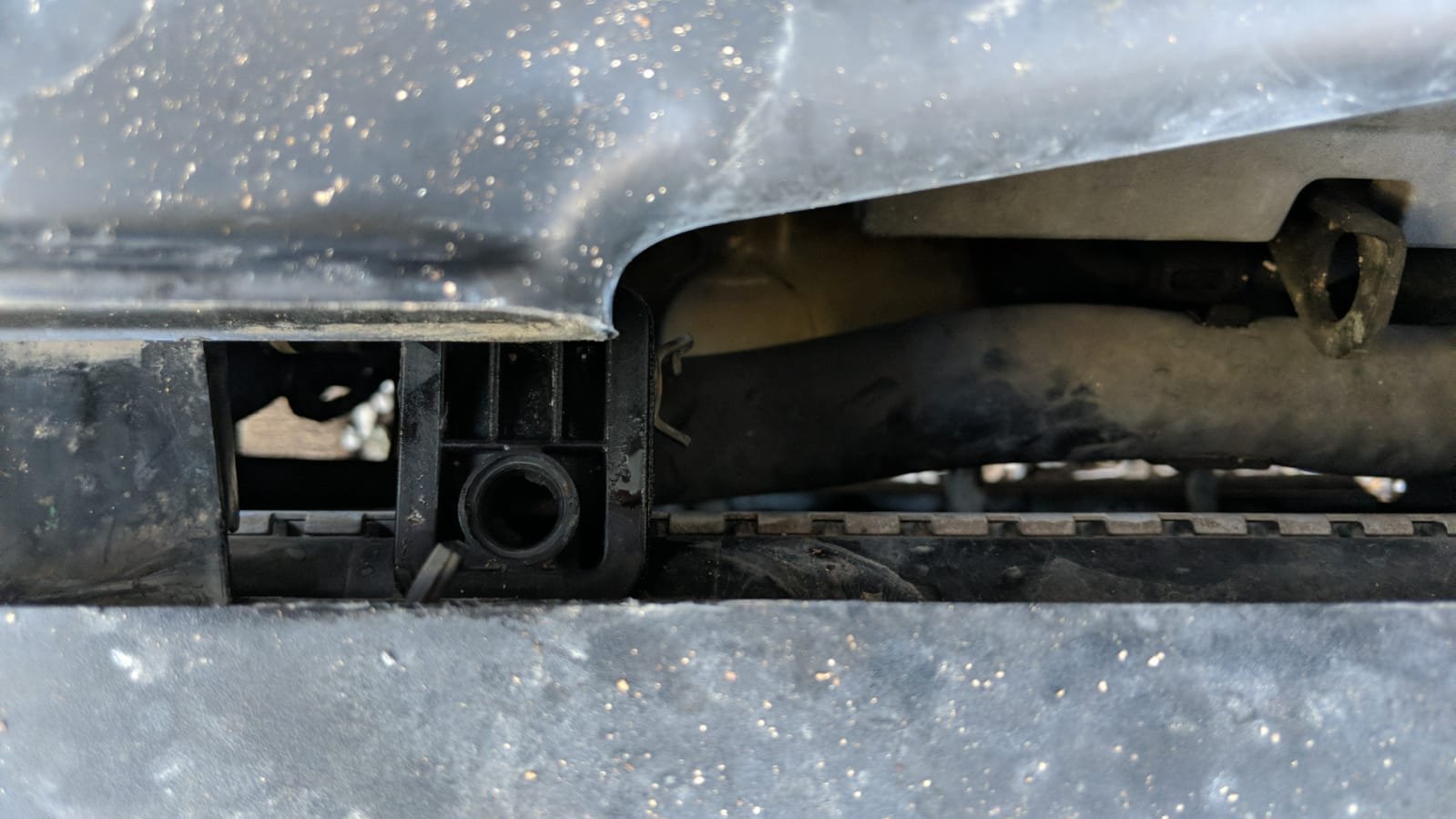

It looks like it was a M10 plastic bolt, with an oring and a large round head.white exec wrote: 04 Oct 2021, 20:23 If you could post a photo to show where it's missing from, that would help.
This is where the screw was... And this is where that hole is in a larger picture (finger is pointing)

So.... the correct screw arrived and it was not the screw that was broken... it was the radiator itself.
So I bought a couple of these:
And JBWelded one to the radiator...
I hope it holds
