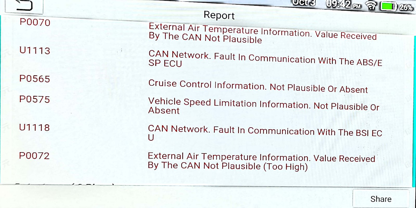

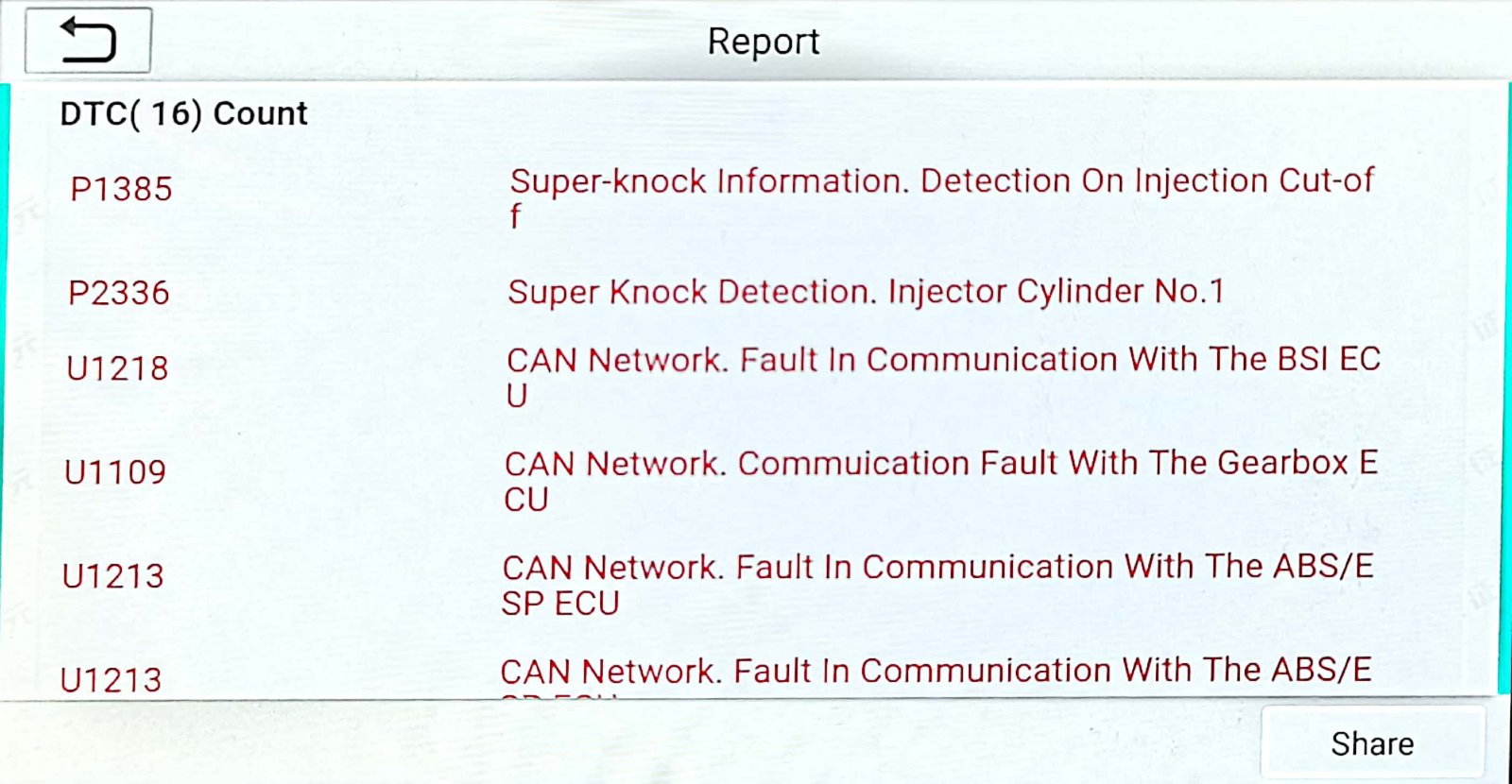

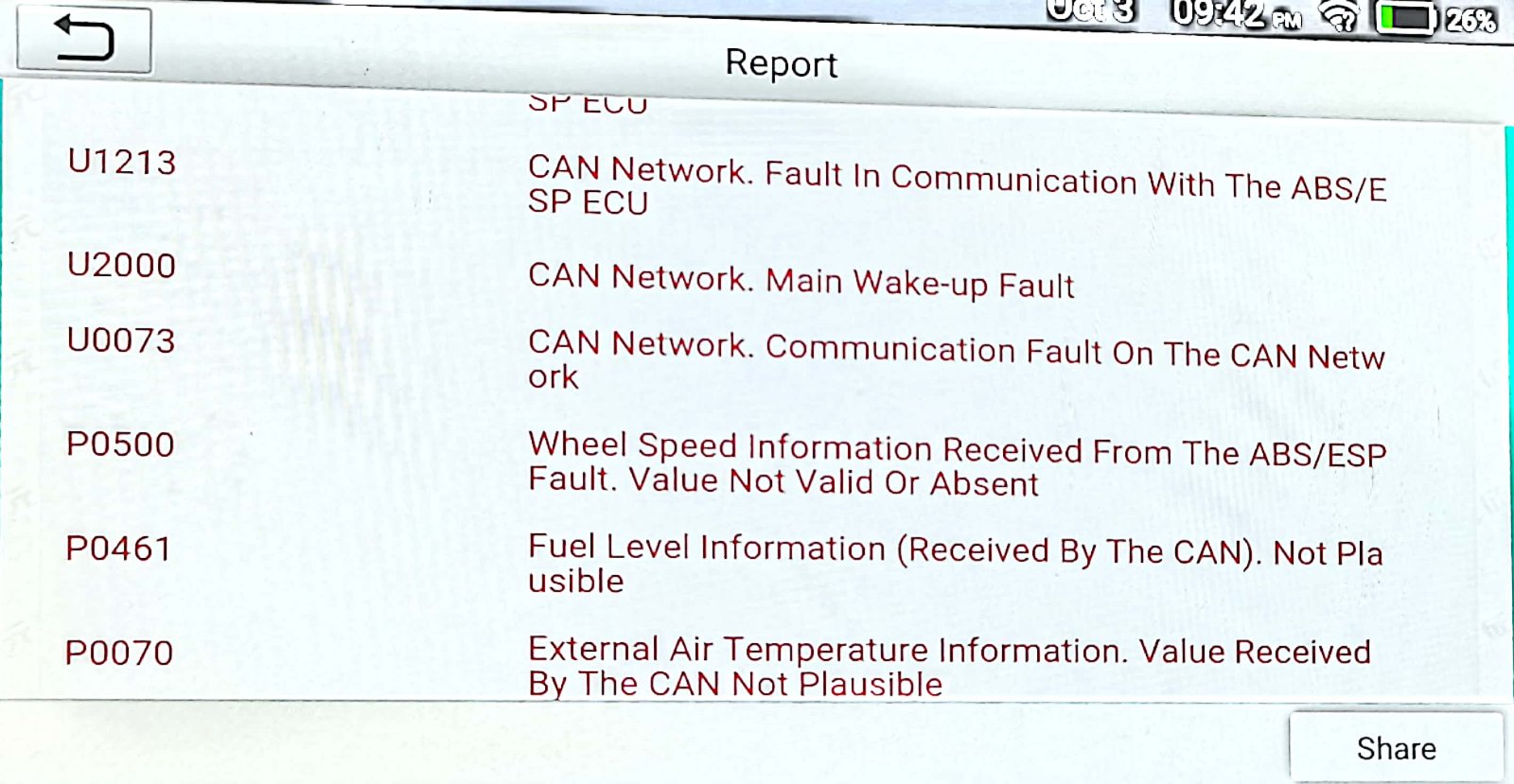

this is report for error code form a obd11 device
pls help till me how i found the reason
3008-2016 - multiple error at once pls help

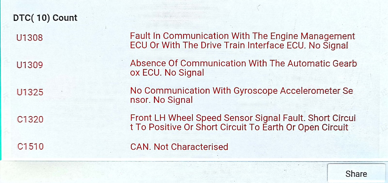

Thanks for advice, some one told me to chek sensor for speed on Lh Wheel can you til me how to chek it if it was damage, and where its fuse
u1308 fault in the gearbox electrical control on the can network . incorrec value recived
u1213 can network . fault in comunication with the abs/esp ECU
U1313 Absence on comunication with the esp ECU. NOTcharacterised
u1108 fault absence of comunication with the engine management ECU and the hybrid management ECU (if the hubrid management ECU is present) no signal
u1213 absence of comunication with the esp/ECU . Incorrect value received
engine ecu
u1213 can network .fault in comunication with the abs/esp ECU
u1109 can network .comunication fault with the gearbox ecu
c1320 front lh wheel speed sensor signal fault .short circuit to posittive or short circuit to earth or open circuit
u1325 no comunication with gyroscope accelerometer sensor . no signal
And whats about that
p1385 super-knock information . detection on injection cut-off
p2336 super-knockdetection . injector cylender no.1
engine ecu

Re: 3008-2016 - multiple error at once pls help
If you have a faulty wheel speed sensor, this will cause a malfunction of the ESP / ABS system and cause a lot of the faults. Start with checking front left wheel sensor pins and connections. Sometimes they can get knocked and it can cause a loose connection. Check the electrical plug, pins and connectors are clean and fit tightly.
However, having said all that - I think you have bigger problems, as if you ignore the ABS / ESP ECU CAN errors, you still have other CAN network errors concerning the Engine ECU, the BSI, the Gearbox ECU etc,. so there seems to be some communication issue with the CAN network.
This can happen if any of the CAN wires have been cut or spliced / damaged or connectors missing of the ECUs, fuses, etc. You need to get some investigation done by an electrical specialist with CAN BUS systems.
Has any work been undertaken lately that may have caused these issues? There's not a lot we can do at this end as we could put all the ESP, Cruise control, handbrake issues down to the wheel speed sensor, but not everything else.
