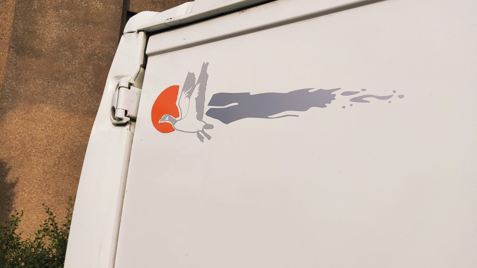

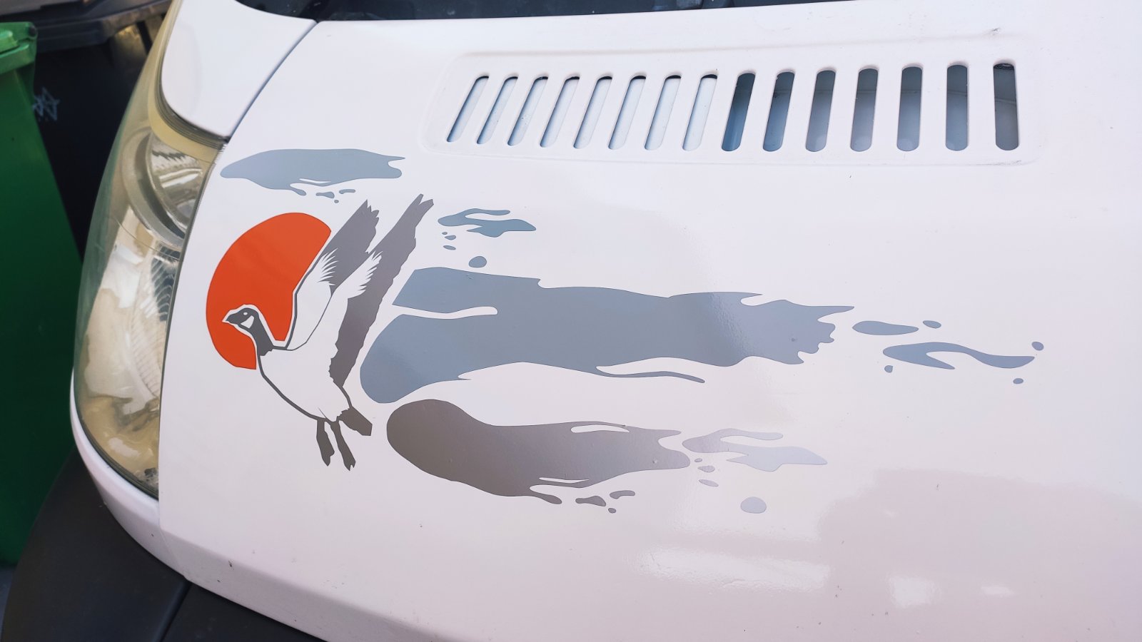

Hi. In years gone by I would protect pinstripes and stick on badges with good old Simoniz polish. I am in the process of applying decals to Pint Pot and have been given various suggestions for protecting them. Some of the vinyls are very thin with very fine details whereas some of my own hand made decals are from thicker stock. Suggestions vary from spraying lacquer over them to applying clear stonechip film. Has anybody got any experience of this or got tips?

The next decals to go on are 4ft long forest/mountain scenes. I have bought 2 sets - one in green for the trees and one in silver for the mountains. I plan to cut them into 3 sections and apply them along the broad swage panel that starts at the rear light and goes forward to the door.
I also plan to cut out an orange Sun to add to the decal between the trees and the first mountain to tie in with the suns I added to the Duck graphics. They also came in only one colour and I replaced the sun part.

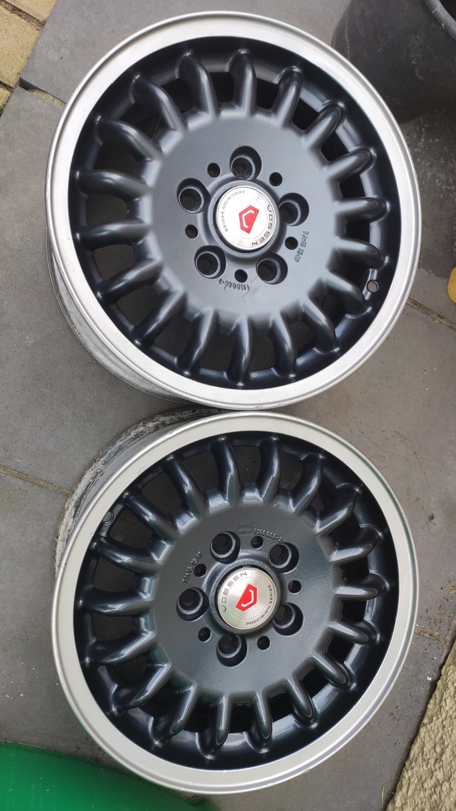

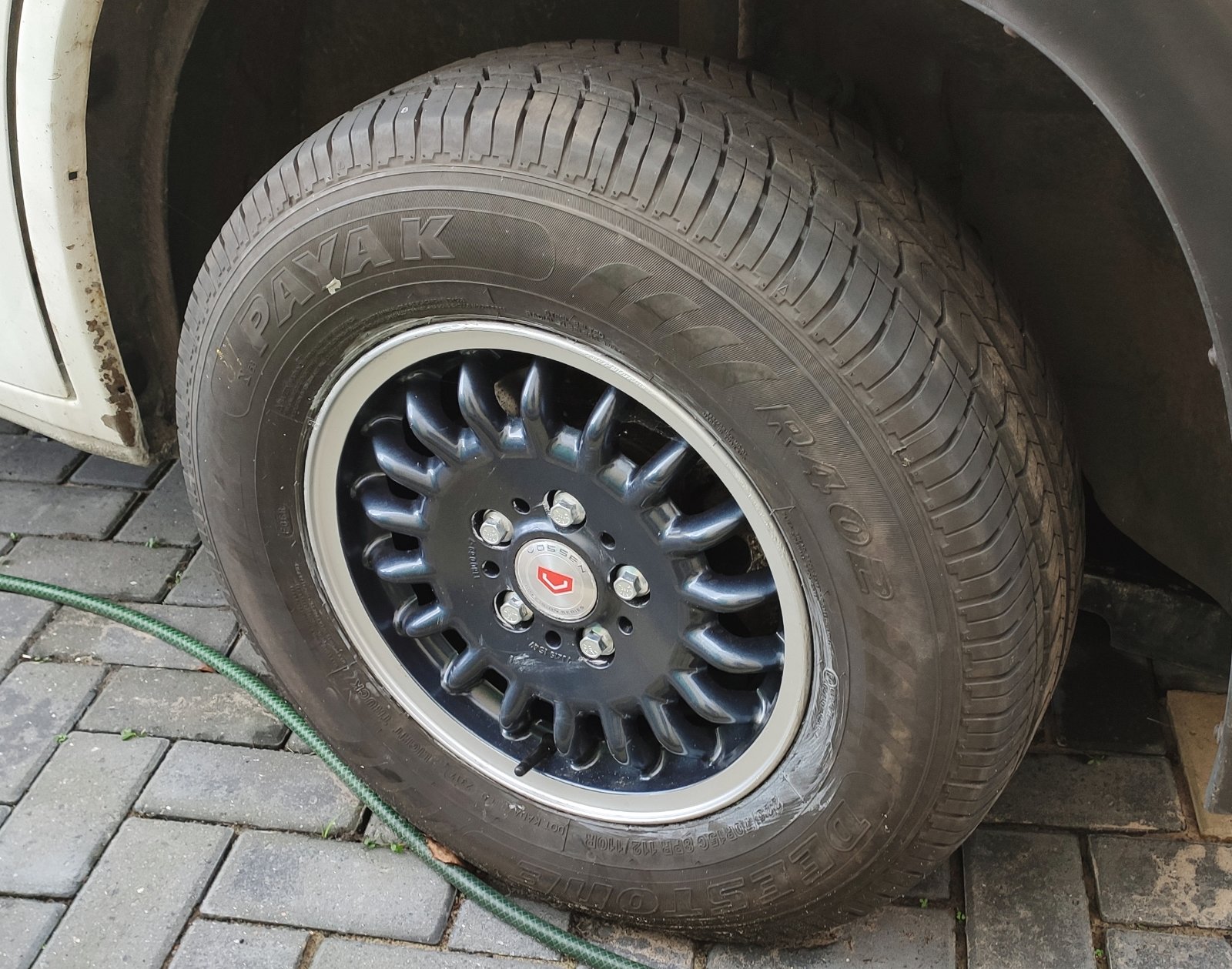

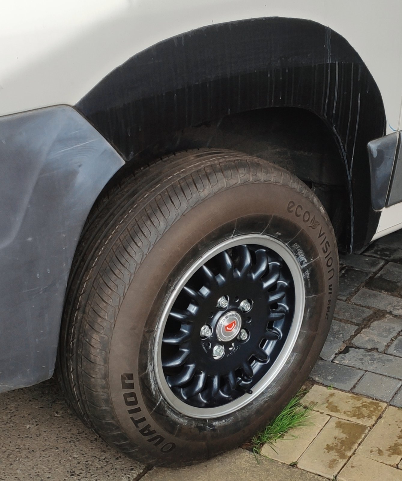

The steel wheels were replaced with 15" old style BMW 5 series alloys and painted Citroen Shark. 1/2" wider rim. Run well on the road too with no adverse effects on the steering or feel.
I resisted the temptation to go mega wide 17" plus - I think they just look stupid. Plus I got to use the proper original (heavy duty) tyres.

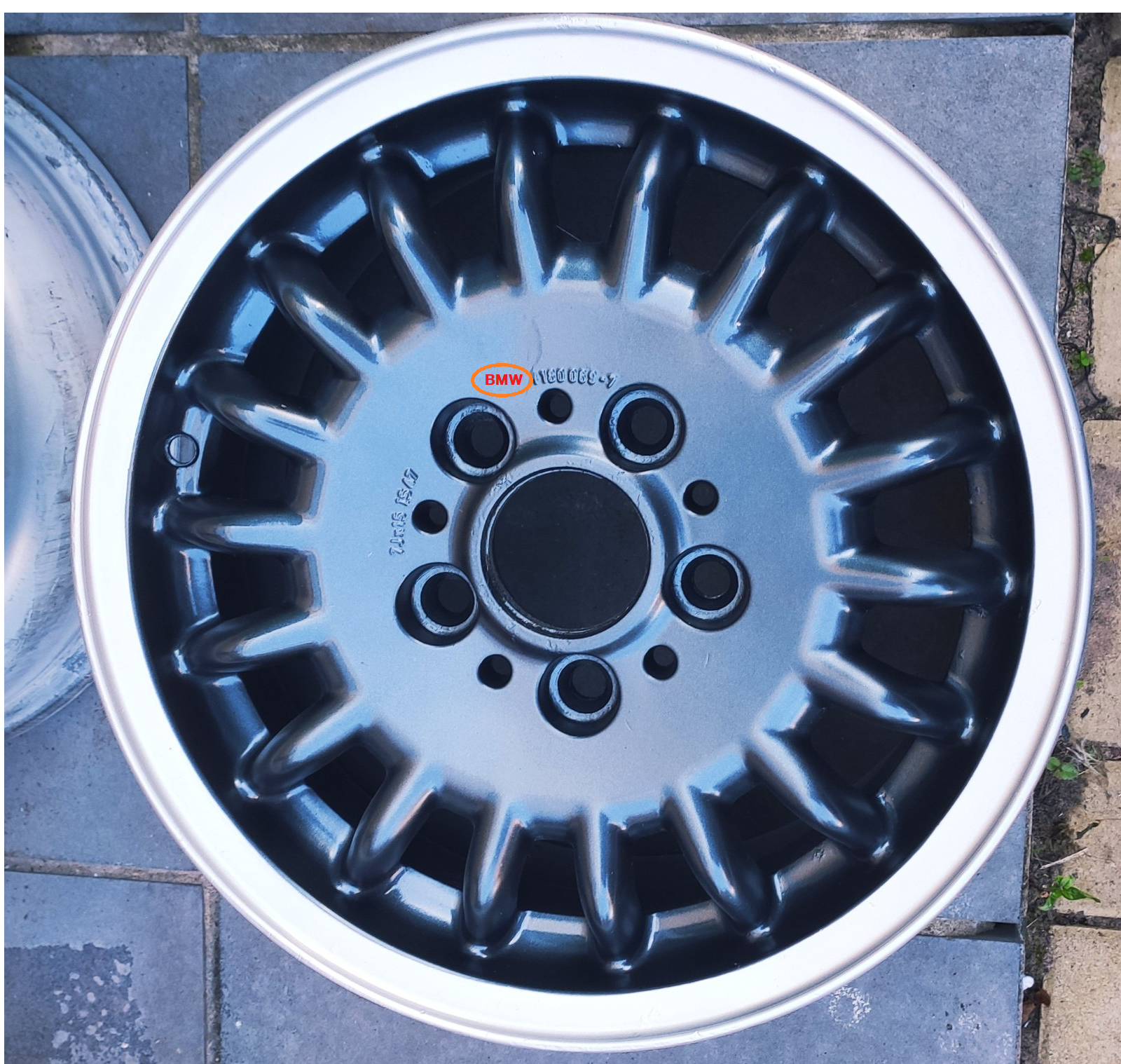

Just to keep the rest of you interested, what is missing from the BMW alloys now?

Looks like someone may have ground off the "BMW" before the ID numberDormouse wrote: 03 Oct 2021, 15:40 Just to keep the rest of you interested, what is missing from the BMW alloys now?

No flies on you then! Just all over our kitchen. Attacked the offending Letters with a Dremel and finally ended up with these.

That has to be one of the best uses anyone has ever put a dremel to!!! Well done that man!

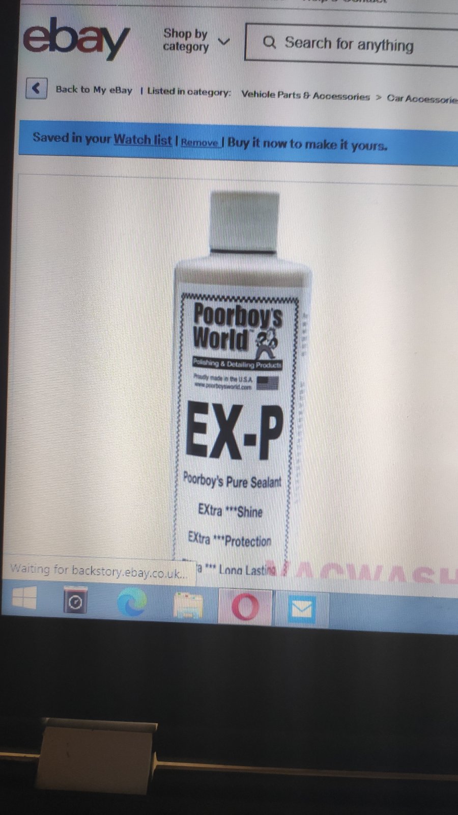

Does anybody out there have any experience of using these products or similar ones and could they seal vinyl decals.
