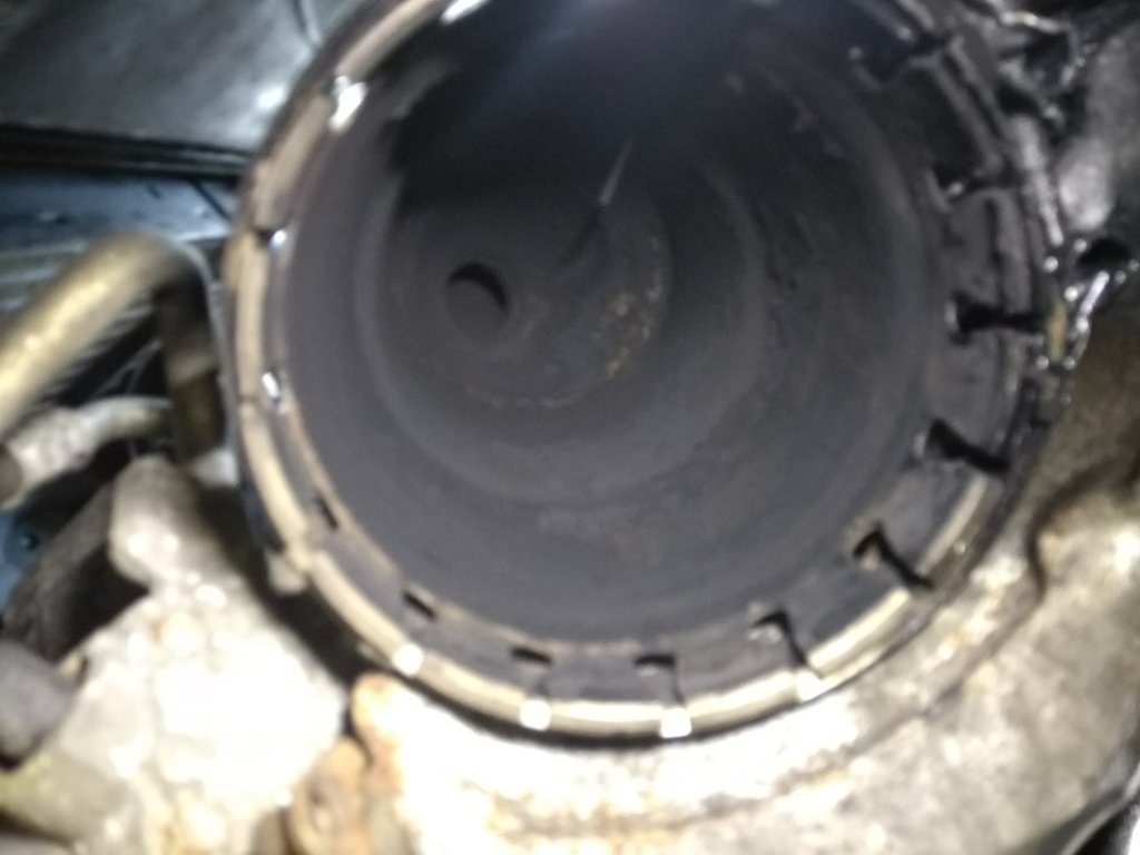

out in it last night it smelt a bit diesely, as in fumes, my injectors are sealed right, when I put new dpf in the cat pipe had no cat in it [previous owner must have knocked it out] so that wont help, will putting an empty dpf in work? [to clear dpf full fault?]

could it be the lack of CAT might have caused it? if the cat isnt burning off residue/unburnt fuel then its going straight into the DPF?
I am gonna go on with diagbox and set it to a new DPF, if it flags up right away then will have to go from there, I have found a secondhand cat/dpf locally for a reasonable price

I expect that the catalytic converter is necessary to pre-heat the exhaust gasses to kick off the re regeneration reaction in the DPF.

I think I want to get the whole thing mapped out, I am wondering if a cat pipe [the one that has just a cat in it] will fit off a berlingo of the same size engine.
I told the ECU after fitting the new DPF that it had been replaced, but I think the lack of cat in my existing chamber isnt helping things, somebody has been there before and done that bodge.

It wasn't immediately obvious to me from your earlier posts that the CAT was actually missing - but yes, that will have an impact.
It's unfortunate if this has been done outside of your ownership - I've heard quite a few cases of similar stories from others and it's the owners down the line that get nobbled for fixing it.
Of course, we can't condone any crippling / removal of emissions devices for legal and moral reasons as it's illegal to remove them, but I'm surprised it wasn't picked up when the DPF was fitted. You may have issues at MOT time as the tests are a lot tighter now.

I fitted the dpf, I knew it needed one when I bought the car [car was cheap, I knew it had some faults], while it was off I looked up and cat is gone
