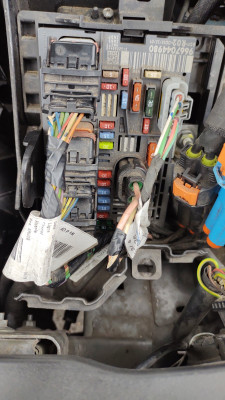

The second suspension ECU is in the rear of the car - so I would rule that out for the moment - the other ECU is on top of the BHI which is the assembly on top of the pump, with the ECU uppermost integrated on to the unit.
I think you've probably answered your own question regarding the thump and having the tools on top of the engine fusebox.
There are CAN multiplexed wires going from the Engine ECU to the BSI and similar to the suspension ECUs / Dash etc.
Have a look at the 24 pin Grey connector on the engine fusebox - Pins 11 (CAN High Speed) and 12 (CAN Low Speed) are the CAN wires to the BSI in the glovebox. Make sure they are secure and undamaged.

So I have an update. I've taken the pump off to inspect. I also need to check the can bus wires going to the BHI.
Does any one have a wiring diagram or knows where the wires go to. I'm guessing it's one of theses plugs.
