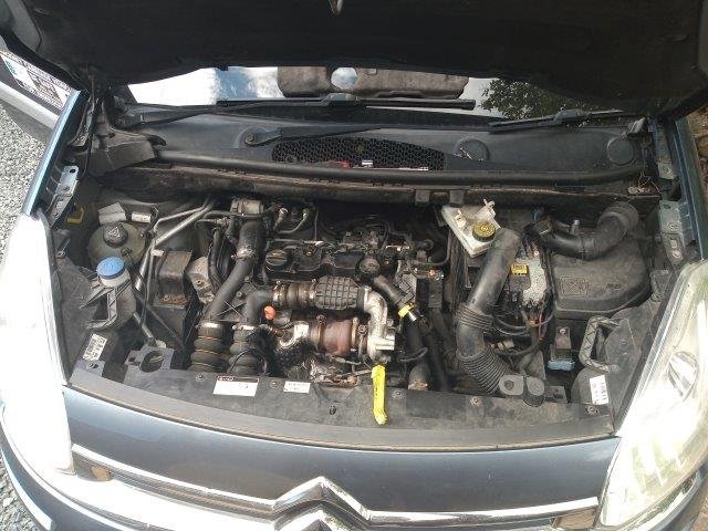

In order to get a some meaningful responses, consider updating your profile to show the vehicle model and year as a minimum, as there is nothing in the title either, so nobody has any idea what you have. Better still, pop the VIN up here (which is preferred) so we can liken the fault codes directly to the relevant engine ECU.
I suspect from the picture you have a C8, but we need the VIN to assist further.

Very sorry!! :oops: I really didnt mean to leave out such vital information..!
It is a Citroen Berlingo Multispace 2012
