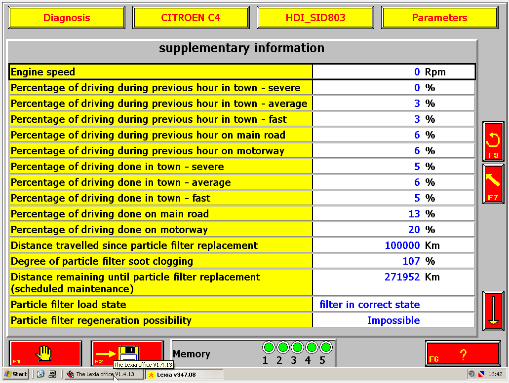

In Lexia I have seen there a number of DPF related state:
"soot load" which goes up to 100% then drops back to 0 after regen.
"Degree of particle filter soot clogging" (the ash content?) which has now reached 104%
"Particle filter load state" which reports "filter in correct state"
If it is just an estimate does that mean that potentially I don't really need to do it yet?

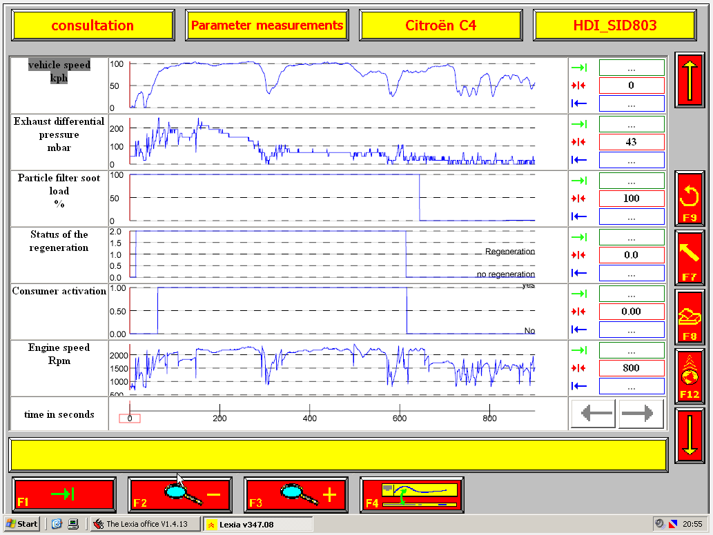

I did a test drive with Lexia running and recording stats, at a point when it was about to do regeneration as the soot load was approaching 100%, I will try and show it here.
Is the differential pressure a good measure of if it is really getting clogged? I saw one document that seemed to be saying 800mbar was the point the ECU would raise a fault for it being blocked. it looks like mine did not get about 250mbar at any point, and did go down after the regen.
I realised after recording it that maybe exhaust flow would have been a more useful parameter to have recorded too.

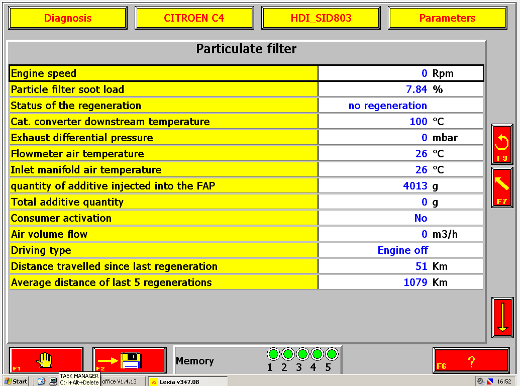

So it's been a while since I posted this. But in the end I went for the hybrid DIY approach and got a mechanic to remove the DPF from the car for me to clean this weekend, and is coming back tomorrow to refit it once I've finished the cleaning.
As expected there wasn't very much soot in it, as it had regenerated only about 50km prior to being removed, but there was a lot of red ash that came out of it.
I did largely the technique shown in one of the videos on the other thread, using caustic soda, then diluted brick acid (hydrochloric), then lots of rinsing and back flushing.

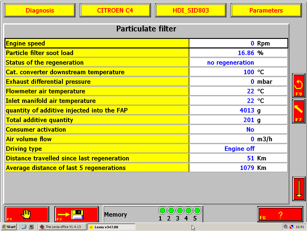

This evening I plugged Lexia in to tell the ECU that the particle filter had been replaced ready for the refitting; this seemed to work quite painlessly I use the particle filter replacement option on the additive ECU and the counter has been reset to zero, this is also reflected in the injection ECU display of the counter too.
One thing that puzzles me slightly is that I would have expected the soot and ash levels displayed to also be reset to zero as it had been told it has a new/cleaned DPF. But they have gone down, but not to zero.
Before the reset:
Then after the reset:
So it thinks there is a soot load of 7.84% and ash clogging of 27%. Anyone got any idea why it didn't go all the way to zero?
If I had driven it I might have assumed it had some how measured that it wasn't completely as clean as a brand new one, which I'm sure is the case as the cleaning almost certainly didn't get everything out. But when I did the reset the DPF isn't actually physically installed in the car yet.
Did I do something wrong, does the reset need to be done after the car has been started at least once post the cleaning/replacement? The additive counter has reset and the fault code is no longer registered, but I was just curious where these numbers came from, as I expected them to be zero.
Rob
Before the reset:
Rob

You have to bear in mind these values are theoretically calculated - not actual...I'd also make sure you do fully top up the additive too while you are at it - as you have notified the engine ECU that you have done this. This will affect the warnings and calculations going forward and it is now expecting that the additive has been topped up.

I think that is what surprised me more, if it was measuring something it would have been less surprising for it to say it wasn't quite as clean as a new one, so didn't reset to zero. But as a theoretically calculated value it seems even more surprising that it didn't just go to zero when it was told it had been replaced. I guess it is harder to understand without being able to see what the calculations are it is doing in the background. Oh well, the counter is reset so at least the light is off and it will hopefully know it has more capacity than it did. Removing that much ash will hopefully mean there is less resistance to the exhaust flow than there was before.
That's an interesting point about the additive though. Does it always assume that more additive has been added when the particle filter is renewed then? I'd have to look again, but on the additive ecu, where I told it the DPF had been replaced, I thought there was a separate option to tell it that the additive has been topped up, I didn't do that one only the particle filter replacement. Though that option I think was labeled something like "additive topped up where low additive warning is on" or something like that. So does it always expect a full top up as part of the DPF replacement?
I couldn't see any figures for how much additive it thinks is currently left. But there were two counters; one described as counter 1, which I assumed was the total quantity added over the life of the filter, this was 201g and reset to 0 when I told it the filter had been replaced.
The other, counter 2, which read 83g both before and after the reset; I was assuming this was the quantity it had added since the last top up?
I couldn't see a current level, just a parameter "low additive level" which had a value of "not reached"
