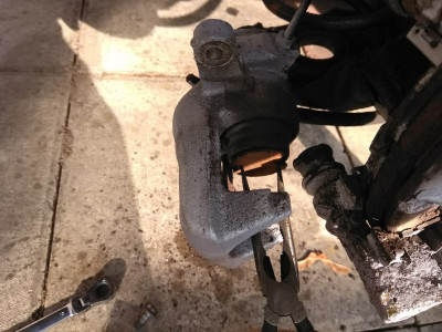

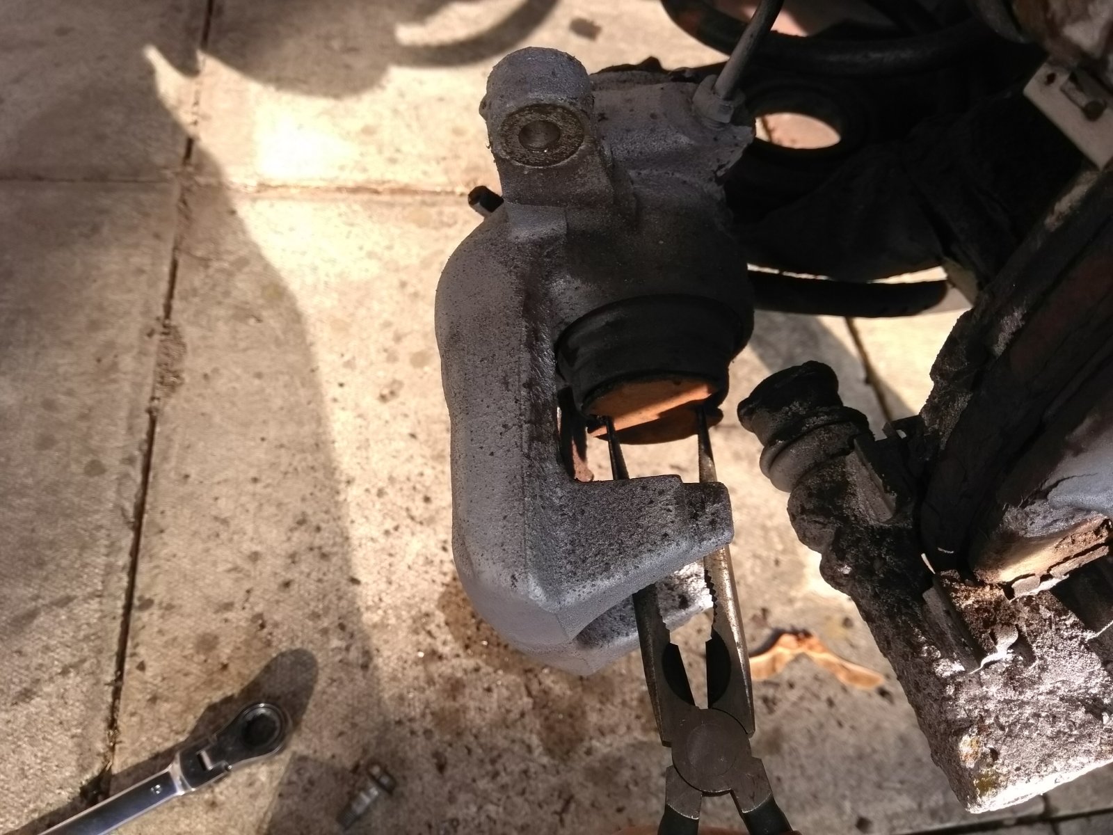

the rear pads on right side [drivers side uk] are quite thin about 3mm each, I have got the caliper away from the carrier but I cannot turn the piston in its bore as I was going to wind it in a turn to see if that would free it off slightly
I dont have a proper tool but dont mind buying one - ebay?
the pads will need replacing anyway but to do that I will need to wind the pistons in, it doesnt want to turn!
in the pic, I have my pointy pliers in the piston

I had a similar problem with my wife's 207cc. 1.6, petrol.
The rear brakes did not function, locked in position. As the car had not been used for a year, maybe not a surprise. I eventually stripped down and re-assembled, using the existing seals. They work ok after that. There are rebuild kits on EBay.
To push the pistons back in you need a "special" tool, but they are cheap on EBay. Some people can wind them back with a screw driver/chisel but I have found you need the special tool if they have not been moved for some time. Also they are handed; i.e. clockwise for one side, anti-clockwise for the other (after half a bottle of Pinot Grigrot don't ask me which!). You need to crack open the bleed nipple. Also you may have to replace the dust seal as it may have aged and cracked.
I found I had to take the callipers off the car to do this; greased them heavily and put them back and then all ok.
Bleed the rear brakes after this.

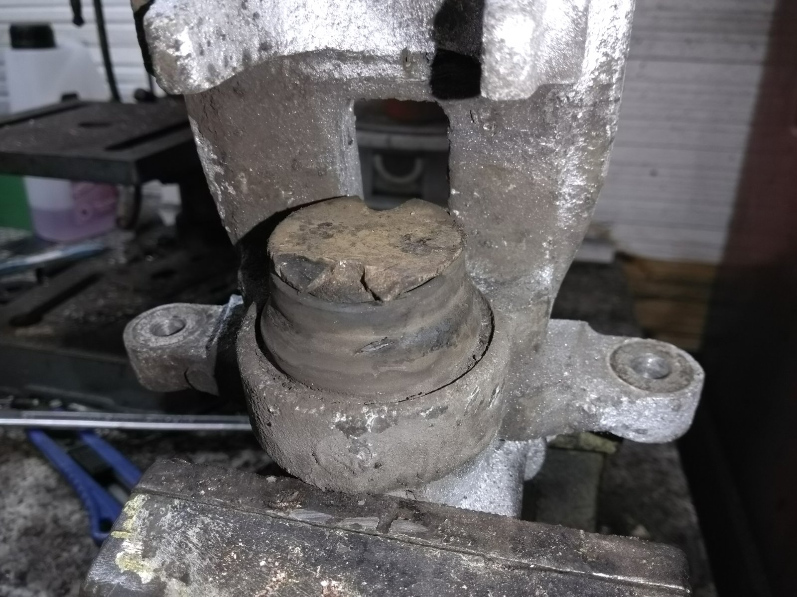

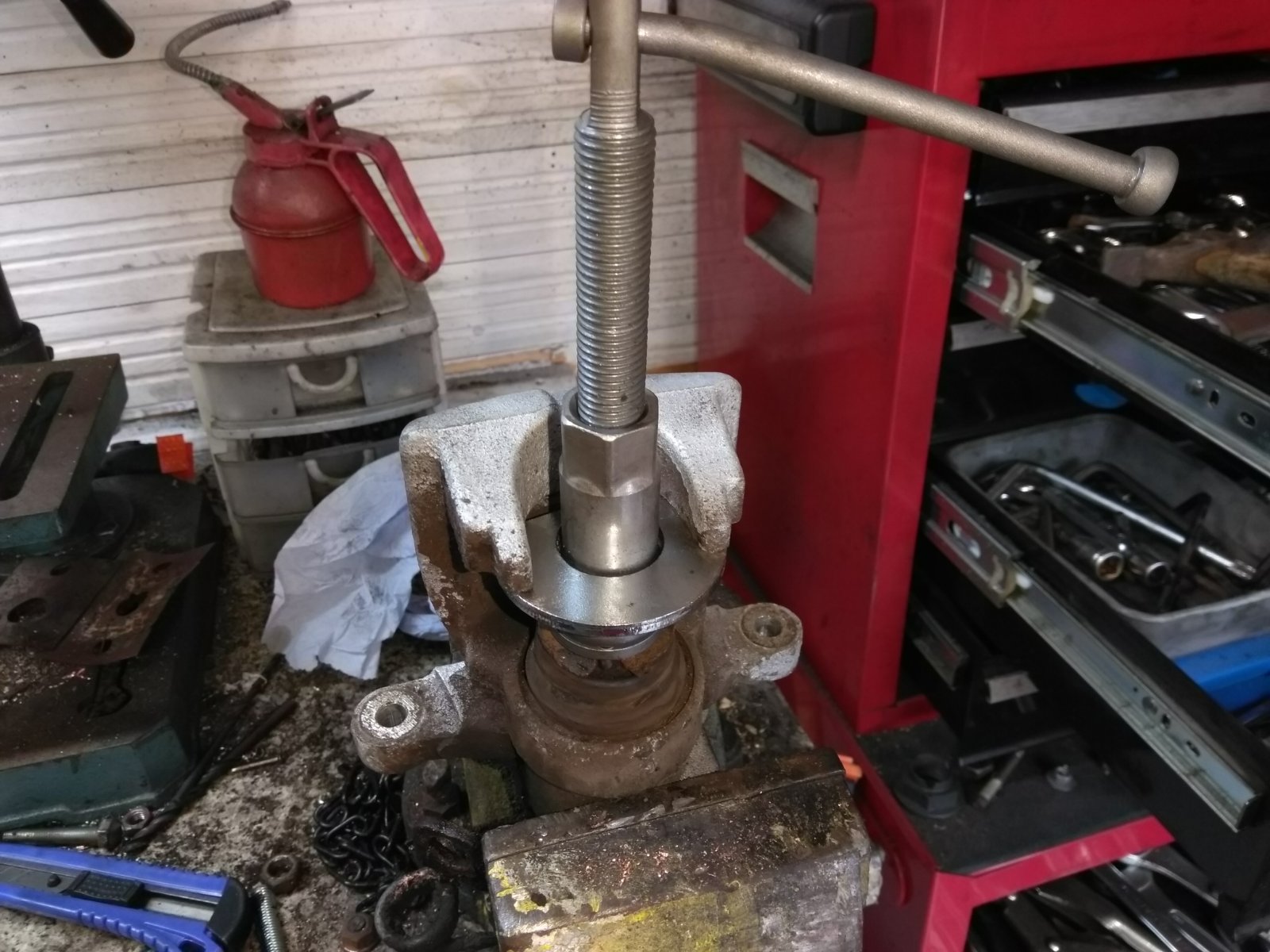

wind back tool arrived, caliper off and on the bench vice where its easier to work on and can get decent leverage if needed
sadly, this piston is not one for moving! have tried it both ways [this is the right side caliper, uk driver side] and I have tried stilsons on the piston itself.
so, yet another part I will have to buy! I may as well buy a pair just in case the other side doesnt want to move.

Try looking for something called "Plus Gas" (you should find it at most motor factors). I have been using it for a while, and (given time and a few applications) it has freed off stuck items well. This is what you are looking for;
https://www.ebay.co.uk/itm/202951224018 ... Sw1LdegkR6
If you WERE to use it, I would give the calliper a thorough cleaning afterwards, juts in case.

I have some PG, I have filled the piston up with it from the brake pipe hole
have tried hammerage, heatage [not much], its not worth wasting my time over, I think piston has been at full extent for ages with no pad material [well, about 2mm], I will just buy a pair of good used locally or via ebay.

the plusgas didnt do anything, it was still rock solid this afternoon
I have bought a brand new pair of calipers, should be here monday, the rear disc on the side that was sticky is a little rusty, I will clean most of it up with a flap disc on a grinder, the other side [good side] is ok as it was actually working.
once this car is on the road, I will be replacing the front discs and pads as well.

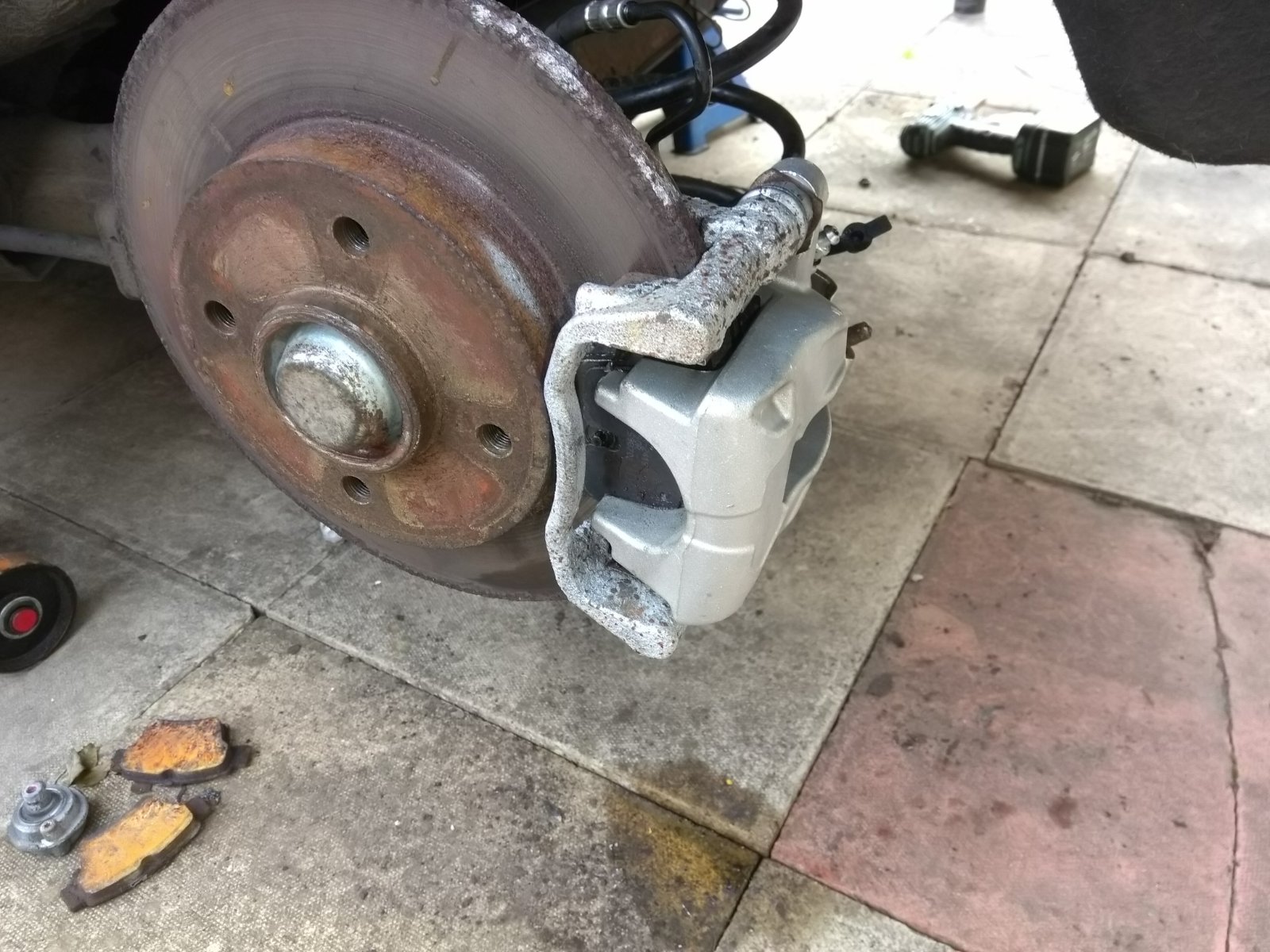

new calipers now on and all good, bleeding the right side [uk driver side] was a pain, but I got there in the end
although I slackened the handbrake cable a bit at the lever end before taking old calipers off, with the new ones its only about 2 or 3 clicks so wont need any more adjustment, just right
