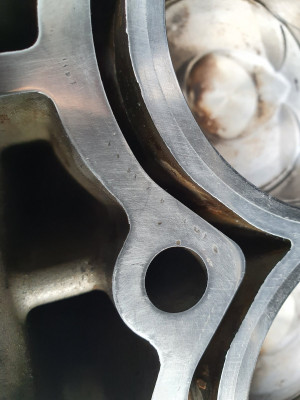

Hello all,

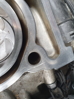

I'm new to this forum and apologies if this discussion already exists but I'm seeking advice on a particular issue I've encountered. While cleaning the surface of the engine block I noticed a small chip/crack in-between the 1st and 2nd cylinder liners (attached photo). The liners themselves look fine but not sure how far the crack or chip extends below. Also it looks like a repair has already been carried out prior to me removing the head?? Firstly, does anyone know if this would likely be cause to a head gasket failure with this defect and if so can a repair be carried out on such a small area?

The aluminium web between the cylinder pairs does not really serve any purpose, and won't cause a problem with the head gasket because the head gasket seals to the liners.
Do check that the top face of the liners are parallel and level across the engine.

xantia_v6 wrote: 14 Sep 2021, 08:16 The aluminium web between the cylinder pairs does not really serve any purpose, and won't cause a problem with the head gasket because the head gasket seals to the liners.
Where was your previous head gasket leaking?
Thank you for your reply xantia_v6,
That is a relief. The liners do look parallel using a straight edge, albeit I bought this from Amazon so not sure how level it is...

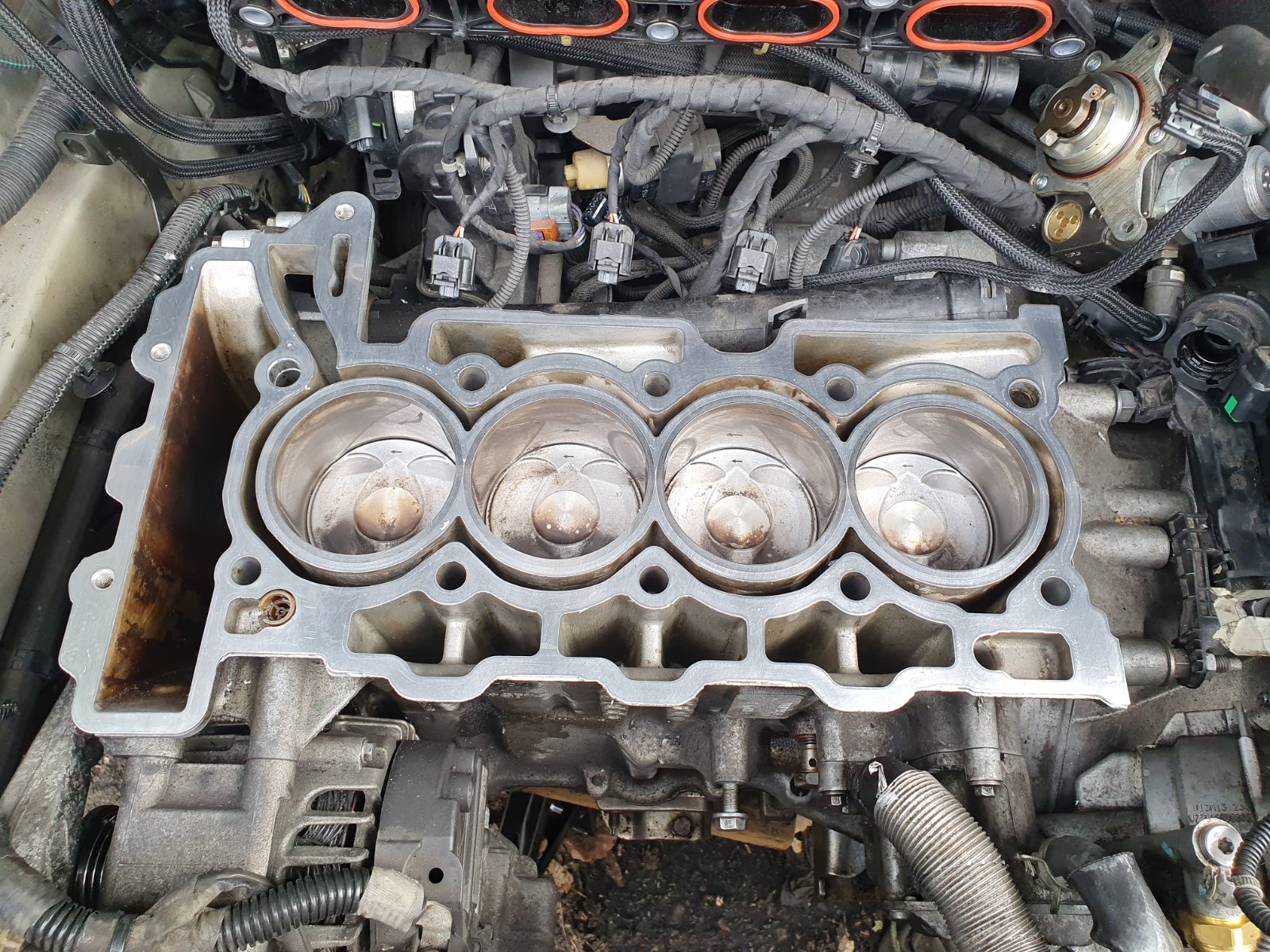

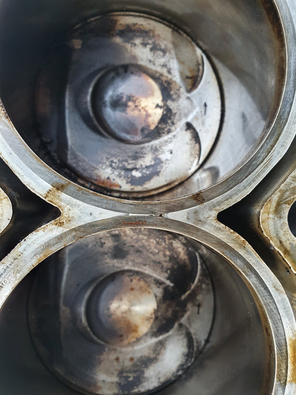

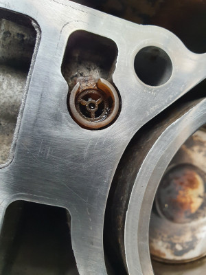

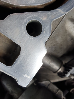

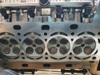

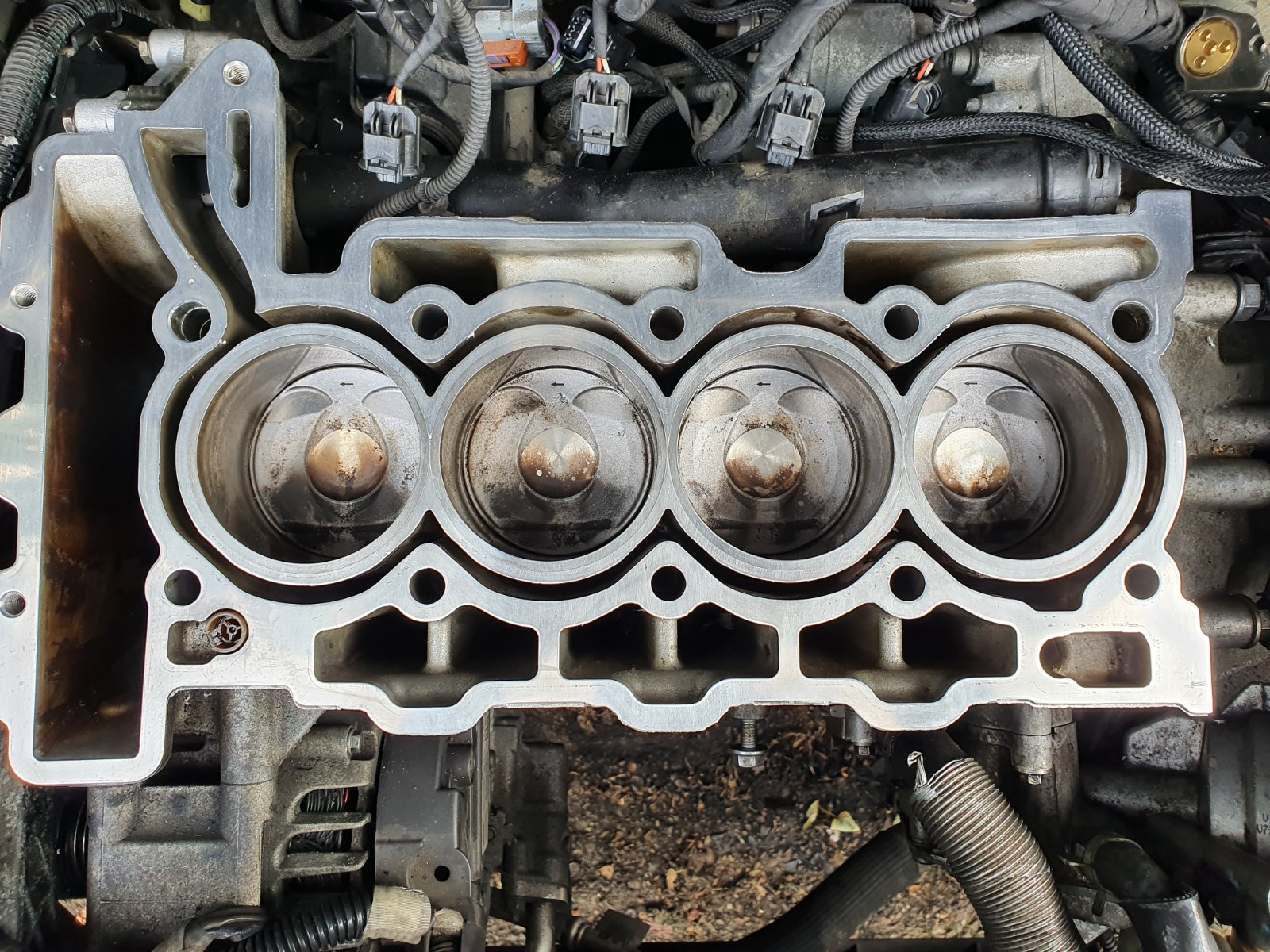

Finally got a chance to "fully clean" the mating surfaces. I think I may have commited a faux Pas by using sand paper. I used only p1000 grit and above. I couldn't get all the gasket material off but not sure if that's because there is corrosion and pitting at the gasket joining areas.. The block and head are level enough though...
See attached and let me know what you guys think, do you think it still needs more work?

From this distance it looks OK.
Good luck.

As long as you have a flat surface and have cleaned all the debris as thoroughly as possible. Water jackets are ok but pay special attention to areas where oil goes and you should be fine.
