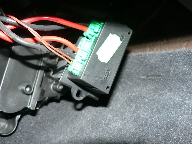

Does it start and stop and changes speed ?
Most likely a control module fault.

The fan is only visible and accessible by removing the glove box.
The pollen filter is accessible from the left side foot well.
Air filters there rarely get changed because they’re a contortionist’s job.
