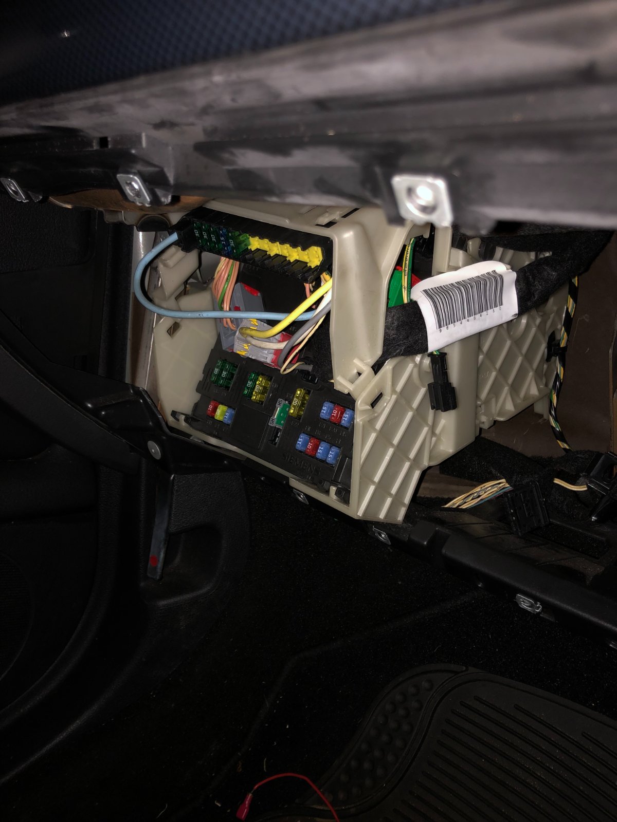

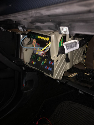

Hi
Having pulled the glove box out of my right hand drive 407, I've located the fuses and BSI but am having troubling pulling it out of the white cage.
I took all the wires off and the top fuse holder, can swing it forward but can't seem to disconnect it from the pivot points.
Any tricks ? Do you really need to take the whole dash off ?

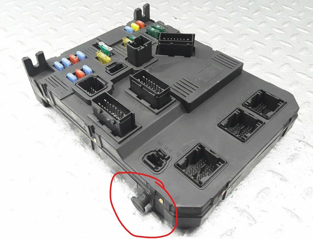

sample pivot point
sample pivot point
BSI behind glovebox / dash

If I remember right it will only release once you pivot it up high enough. The pivots have a flat bit on them so they only slide out at the right angle
