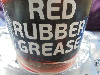

Today I have taken the first steps to being a Red Rubber Grease tycoon.
With a quick cost benefit analysis, a big tin in the hand for just over £10 from the Agricultural engineers was a better deal than spending at least £6 in petrol consumed, and probably 1.5 hours, going to the nearest factor who would have something in stock and paying another £5 for a little tube, or a few sachets.
When I said thats a big tin, the guy at the agricultural engineers said..."What you really want is a bit from our tin".
Couldn't do it, far too cheeky
Always good to cultivate a decent relationship, and over the years their Aladdin's cave of stock has saved me a fortune.
