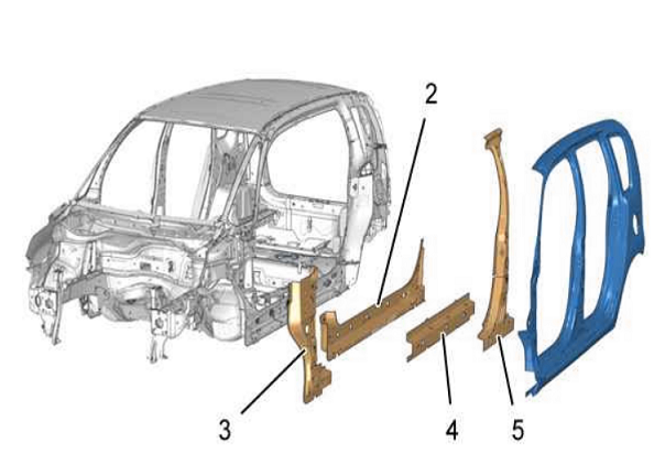

Re: C3 Picasso outer sill internal access.
These sill components seem separate without a cavity as such:
| Reference | Designation | Thickness (mm) | Nature/classification |
| (2) | Inner sill | 1,95 | High strength |
| (3) | Front pillar strengthener | 1,76 | High strength |
| (4) | Inner sill strengthener | 1,17 | THLE |
| (5) | Stiffener : Lower centre pillar | 1,17 | High strength |
Hi Marc.
Thanks for the diagram, very helpful. I've some bubbling about three inches behind the centre pillar, it's on both sides. I have carefully looked to see why. Removing the trim from the centre pillar and those covering the sills above the carpet reveals a complex inner sill and a strengthening piece, you cannot see the outer sill. I don't see how water or moisture gets to the area. I've removed all the paint and sealer from the outer sill and cleaned off any small amounts of rust and treated it from the outside. At this point I'm not too sure if it was water under the sealer or from internally. I suspect from inside as it's in identical positions on both sides. I want to spray Lanoguard inside to see if it halts the issue, if not its a job for a bodyshop and a little welding, rather do it before it spreads.
Cheers Trevor
- x 1751
#4 in Marc's diagram seems to partially divide the sill cavity into two, albeit not for the full length (which is done on XM, for example).
If there's no rear bung for accessing the outer part of the sill (ie immediately behind the visible outer panel), you might be able to drill a hole on the top side (door shut area), maybe under a tread-plate, if you have such things. Alternatively, a small hole and a grommet on the top side might be better than not waxing the sill at all. Sills do tend to rust from inside outwards.
