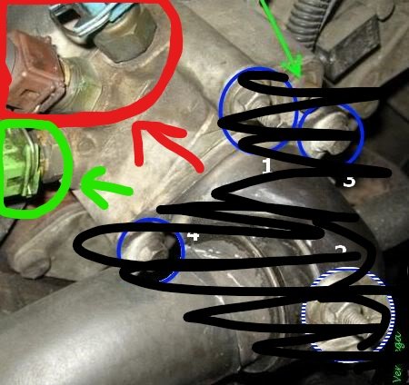

Hello im new here, but i recently bought a very nice Citroen Xsara from 1999 with the 2.0 16v engine, car runs great, only problem i have is that the cooling fans dont turn on automaticly, ive had to make a switch on the dash to turn them on myself... so i have changed the blue and brown sensor that sits on the thermostat housing, i havent been able to find the green one in store, do anyone know which one is actually the thermoswitch for the fans? ie, the one that registers when the car is hot and sends signal for the fans to turn on
sorry for the bad picture i stole it cause i was to lazy to go take a picture.
Xsara 2.0 16v Cooling Fan

Does the fan come on when you switch the A/C on?
If i remember right both the Brown & Green are used for switching the fan on brown one for the A/C system & green for the engine management system.
My initial thoughts though are its not a sensor fault as when the sensor fails they normally fail safe & bring the fan(s) on full speed.
If you disconnect either the brown or green sensor with the engine running after a few seconds this should also bring the fans on full speed, can you try this?

Thanks for the input wheeler, I tried removing both one at a time, the brown one made the left side fan spin up, and the green one made the RPMs shoot up for a quick second, but not the any fan, but that might be because i removed the right side relay and placed the wires for my switch where the relay used to sit, do you have any further ideas or things i could try to narrow in the problem causation, Thanks alot so far.

Usual colour codes for the 3 coolant temp sensors on the water outlet have been
GREEN - Injection ECU input (for fuelling control)
BROWN - Coolant temp for Water Temp Contol Unit (WTCU), incl radiator fans and temp warnings
BLUE - 'Dial' (dash temp gauge).
On some later cars, the first two were rolled into one, and the engine ECU given control of radiator cooling, as well as air conditioning.

Ah okay, thanks alot for the information white exec, i have really been wondering, and those wiring diagrams can get a bit confusing!

wheeler, i plugged everything back in as it should be, then tried disconnecting the green connector on the thermostat housing and both my fans came on at full howl, but when the car gets up to temperature nothing happens, but i did swap out the sensor when i bought the car since i thought back then that it was the cause, what is more likely, that i got a defective sensor from the shop, or that its something else?
