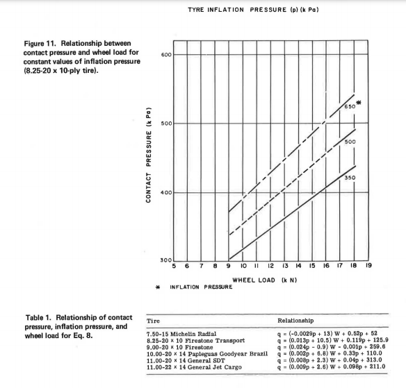

I have done a quick calculation for the final axle weights of Pint Pot and I suspect that my final pressures will be 46/48 front and 48/50 rear. Anyone who studies my posts will think I pull these figures out of thin air but I can assure you there is a wealth of technical information for calculating tyre loadings and hence pressures out there. The only problem is finding it.
This is part of an engineering paper primarily for commercial vehicle tyres but such information is also available for caravan tyres to achieve the best performance within the tyre's operating envelope.
- x 1750

I haven't digested all of your figures, so must acknowledge that.
However, for saloon cars like C5, running on standard tyres, there would be precious little comfort to be had with such high pressures. This is particularly true of Hydractive suspension, where the first line of shock absorption is the tyre itself. We know that over-inflating by even just 2psi (above the standard 30psi or so) produces a hard and thrashy ride.
Calculations of loading, foot-print, etc may well produce a result for commercial vehicles - especially those carrying a heavy load - but the lightly-loaded rear end of a lightweight passenger car is possibly something else.

I agree. Tyre Safe . org have an online calculator for tyre pressures and it is ok as far as it goes = like most databases it is not totally correct. So understanding this limitation is essential. When I tweak tyre pressures and wheel alignment I do it fully understanding the negative effects as well. Most of the comfort in a car comes from the suspension so playing around with other bits is more personally subjective than definitive science. All I will say with certainty is that all cars are different, all tyres are different and all people are different.white exec wrote: 18 Aug 2021, 10:53 I haven't digested all of your figures, so must acknowledge that.
