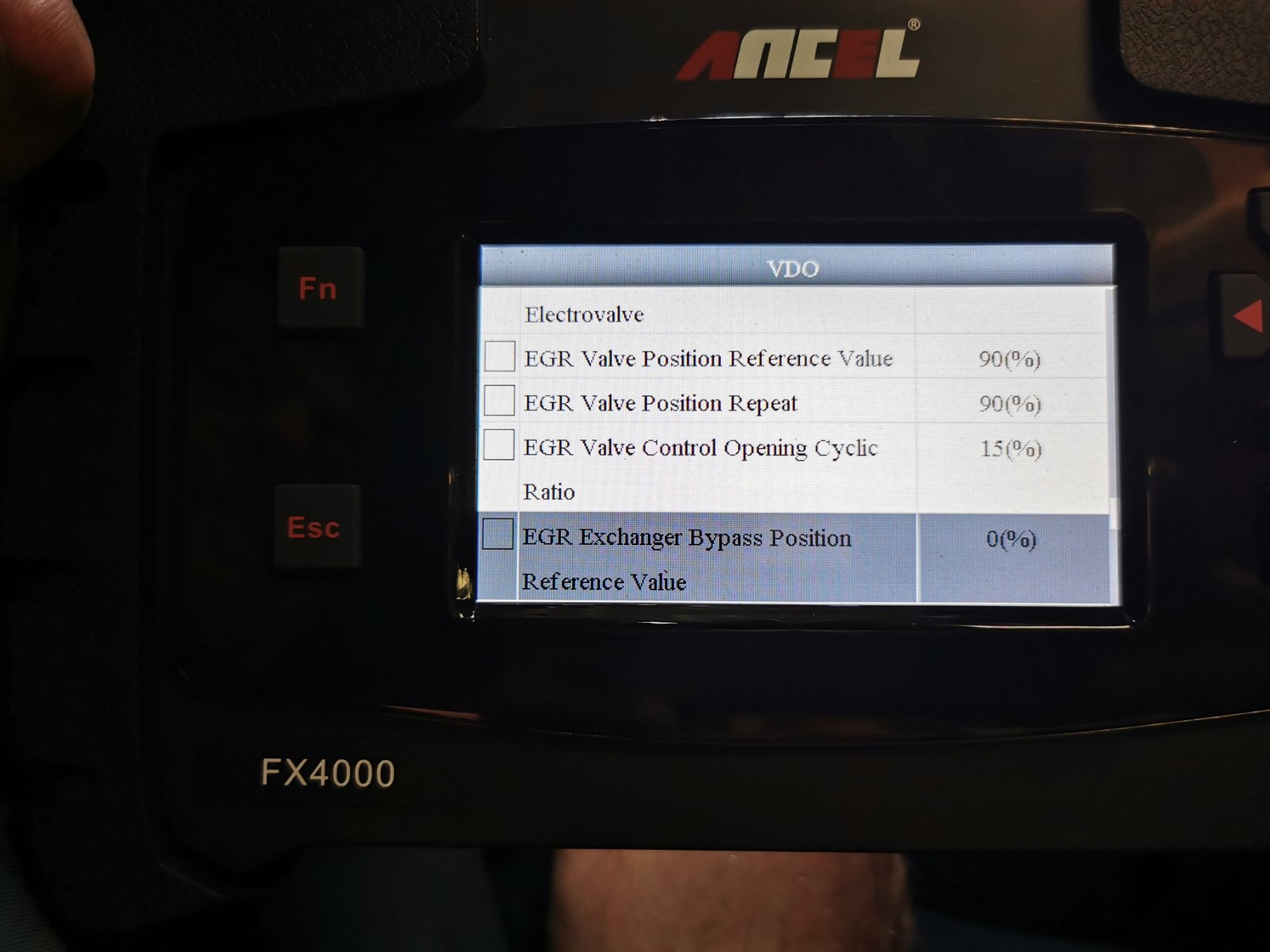

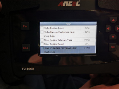

I measured the voltage on the throttle and EGR plugs and everything is correct, and the problem persists. Also after turning off the engine and listen to the EGR, you can hear that as if the hatch wanted to set itself. This sound is repeated three times and stops.
I also took pictures of the airflow circuit on my diagnostic tool, so I provide it for inspection, maybe someone will see a problem there. Can also provide other system information if needed.
I have reviewed all vaccum curcuit.
I found nothing, everything looks good.

I'm sure that someone will either confirm or shoot me down in flames but the sounds you hear from the EGR are normal with some engines. It is operating the 'throttle' to confirm operation and clean it.
