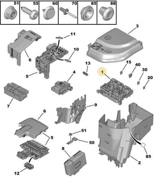

Hello all I have just purchased for my sins a c4 grand piccasso this car has been off the road for nearly 10 months with many issues which I am currently working through. The wiper motors are not working and have purchased another pair from a breakers yard with no luck yet. However on checking my fuse box layout the pictures are different from mine. After removing the PSW FUSE BOX from the car it has obviously come from a breakers yard aswell. As I did not fit this I suspect the wrong fuse box may of been fitted. I have connected diagbox 7.83 and have no connections to the car which I suspect the BSI Can Bus to be suspect pins 3 and 8 at the Diagnostic socket 120 ohms. Pins 6 and 14 normal can bus read 60 ohms so I believe that tobe OK. The car start and drove until yesterday when the battery died. I would like to resolve the fuse box issue is there someone who could identify which fuse box I should have fitted in the car please. My vin is VF7**************[VIN obfuscated, can be read by forum staff] AND RPO 11184 Many thanks in advance.

Item (1) Engine Fuse Box
You need revised part number 6500FG, currently retailing at Citroen today at £305.69 VAT inclusive. Incidentally, you have the first part of your VIN the wrong way round. It should be 'UA' not 'AU'
No problem give me a second.... and thanks for your donation.

how does that compare to the one I have please 9661682980 bsm - l11-00 s118983011a

OK nothing like it 9664055680 thank you Mark

The part numbers we have are the official PSA part numbers and these are what Citroen use. The numbers you have are the more recognised 'international' numbers - where these are applicable, but as you suspect the incorrect fuse box has already been fitted, there would be no value in asking you to use the '96****' number from the old fusebox to find a replacement.
9664055680 is the 'international' number, so this is correct. A reliable supplier I can recommend is Eurocarcare.net, but they are selling these the same price as Citroen - and are genuine parts:
