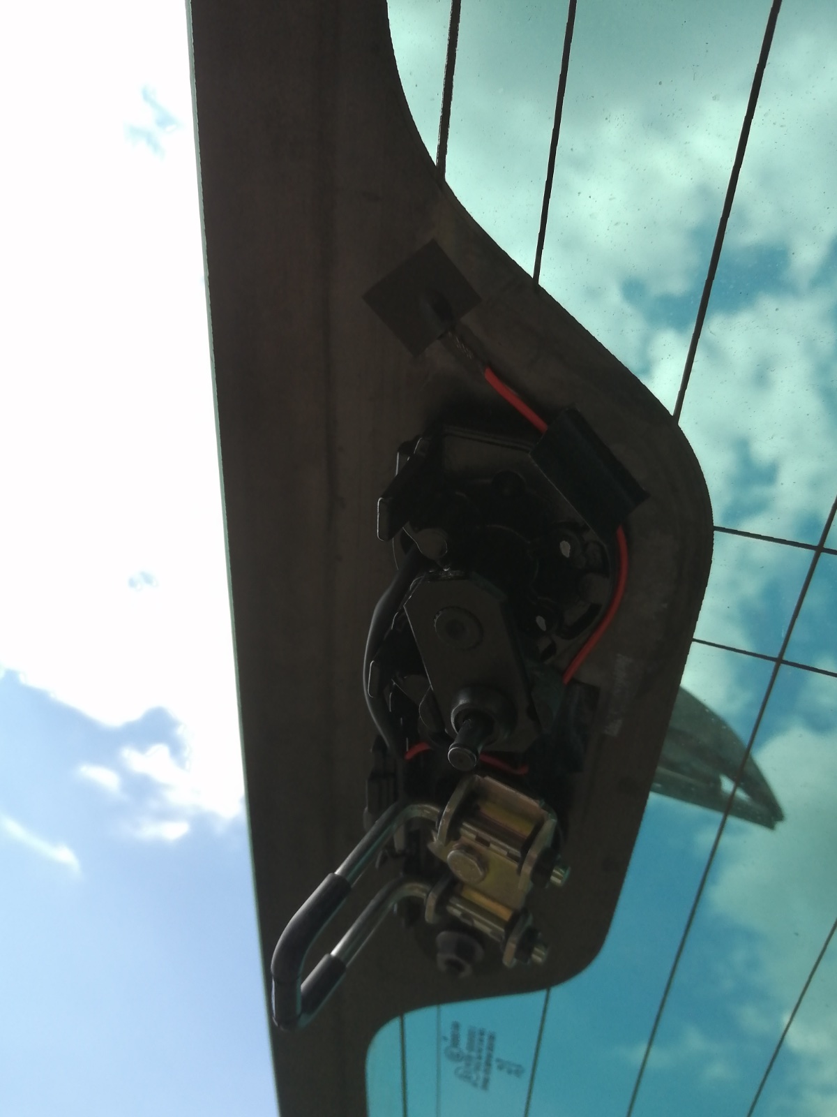

Here's a photo of my fix with the plastic cover removed. The red jumper wire connects the brown wire at the plug to the switch and the screen element on the right hand side of the car. It's tucked and taped so it is fully protected by the plastic cover when it's clipped back on.
