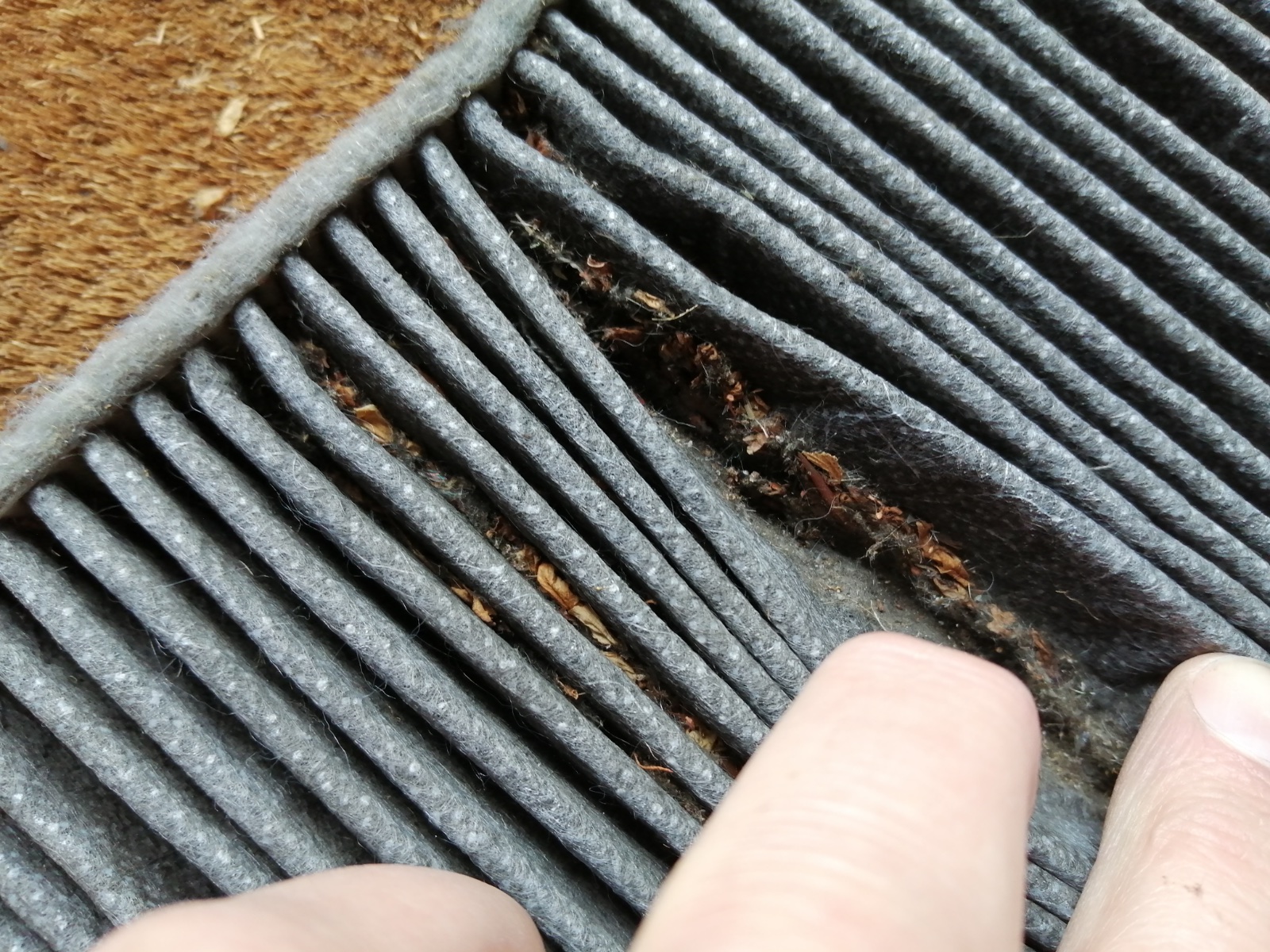

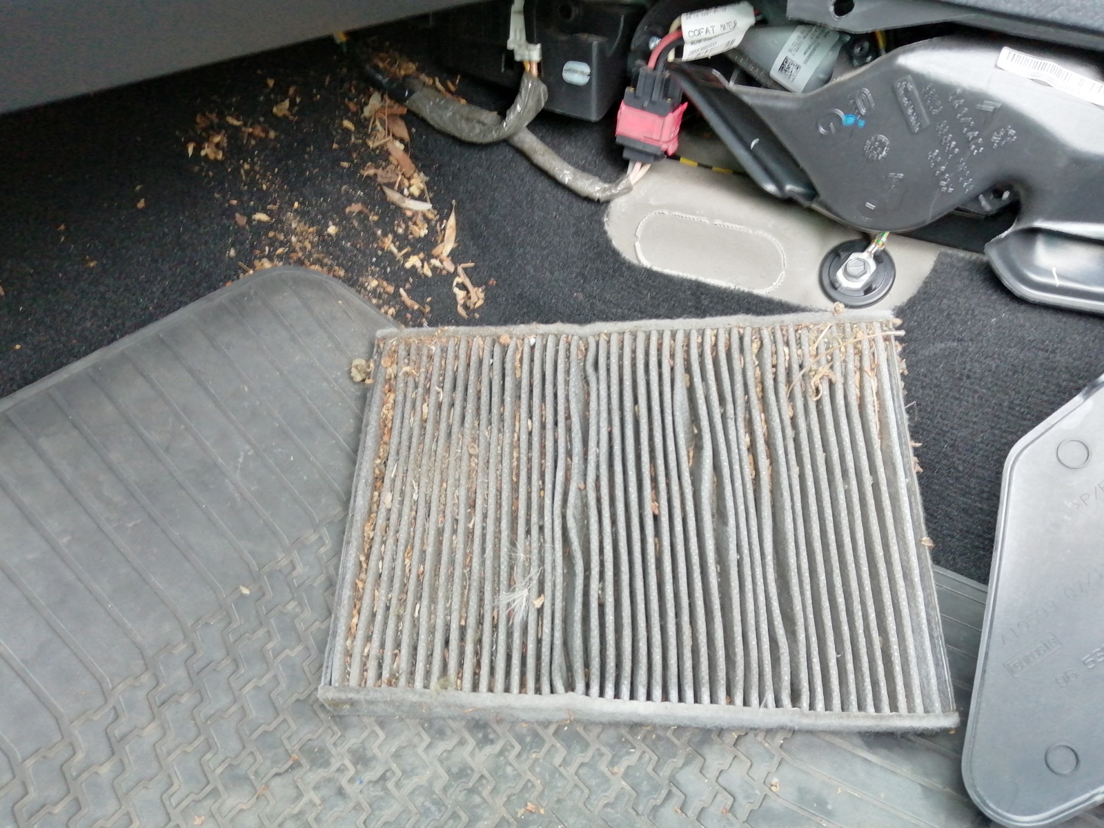

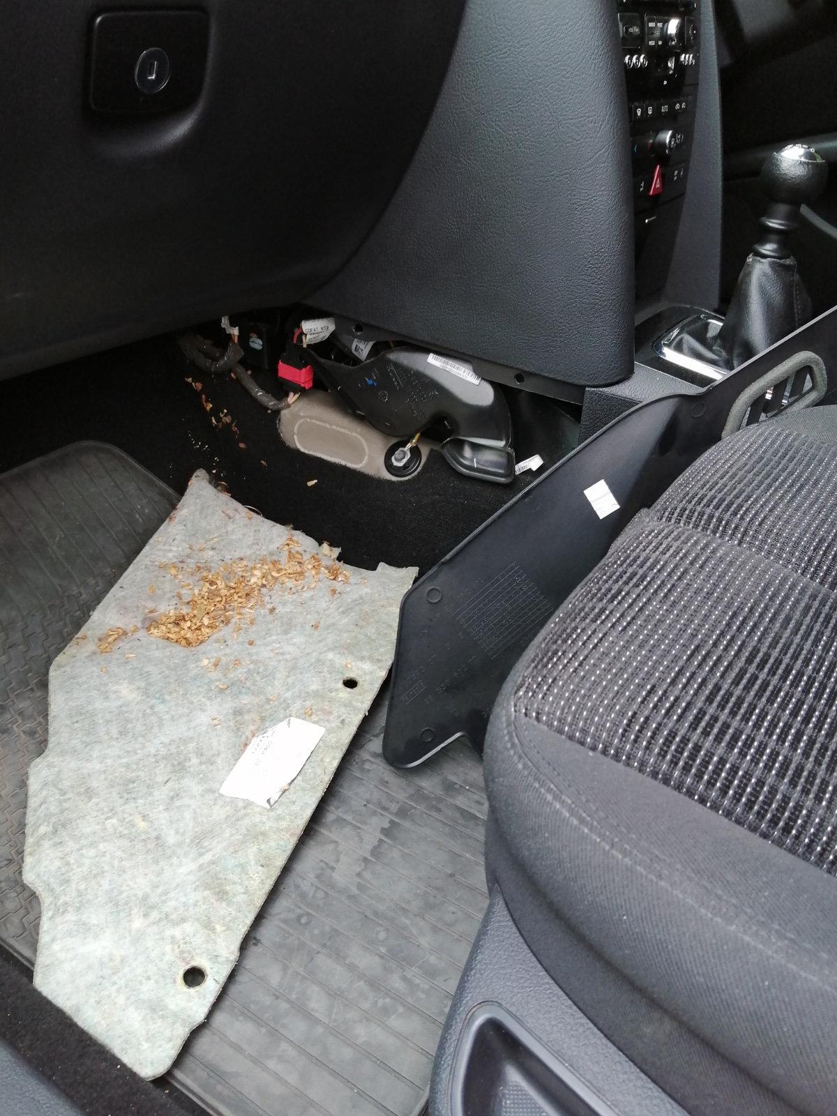

Last year I spent a lot of time clearing leaves and detritus out beneath the windscreen scuttle, removed the choked cabin filter and thoroughly vacuumed out the filter housing. The car had probably lived under cherry trees or in the woods! The ventilation improved hugely (and the centre screen doesn't reboot so often :) ) but no cold air :(
