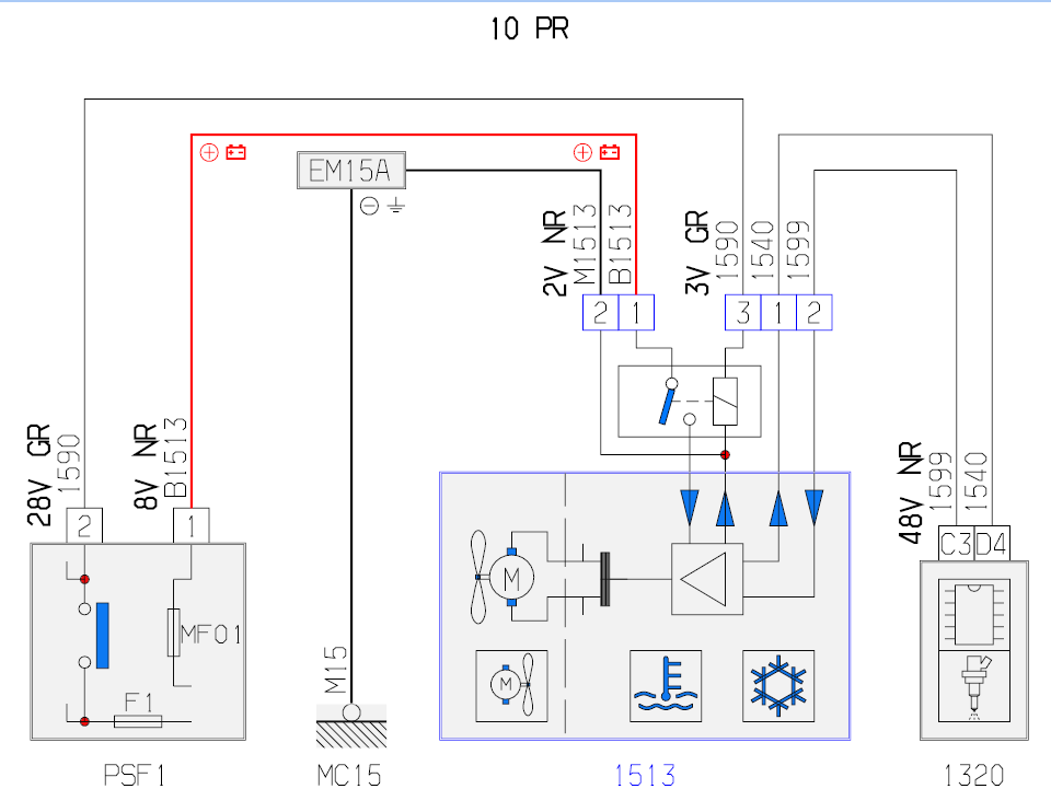

The wiring diagram is attached here:
(https://ibb.co/G3rS90W)
I assume the fuse Nr. F1 and MF01 are fine as well as the relay, because the cooling fan kicks in at high speed and when the A/C switched on.
I measured the control signal coming from the motor controller using an oscilloscope.
I checked the control wire (Nr. 1540) coming from the motor controller to the fan's controller. The control signal is PWM. When the high speed test was running from the diagbox, I saw a correct PWM signal on the control wire. When I turned on the A/C the result was the same.
Now the interesting part, when I run the low speed test with the diagbox, there was not any PWM signal on the control wire (Nr. 1540). Very interesting.
And the most interesing thing is when the engine temp reaches 98°C, the motor controller doesn not send an increasing PWM signal to the cooling fan controller (commanding the ecu of the cooling fan to start spinning), neither at 108°C. It only sends almost a full PWM signal to the fan when the motor temp reaches 111°C.
I assume the cooling fan is fine as well as the wiring loom. There should be some isse with the motor controller itself.

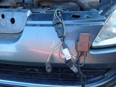

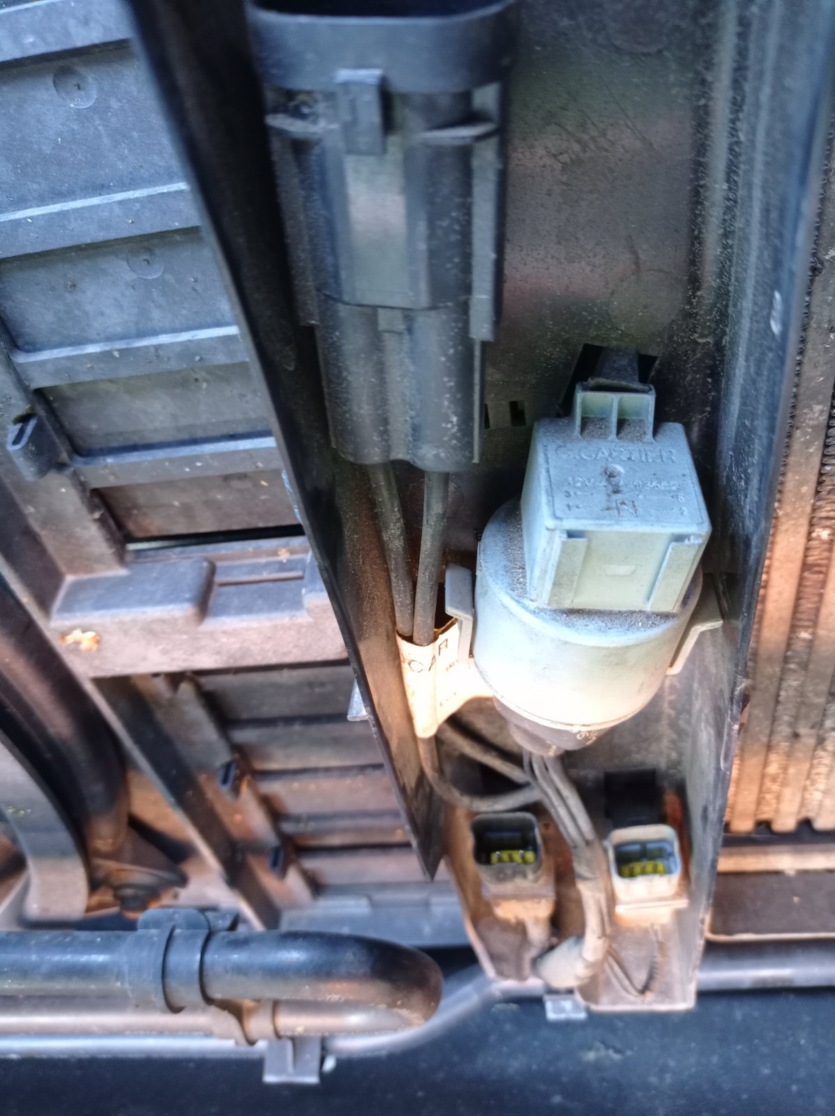

Unfortunately, my fan has 3pcs connectors. One power supply and two another, (407; 2004; 2.0 HDi RHR 100kW).
I attached a picture:
Connector of original fan
So, I connected the reference fan on the car's cable harness, see below picture:
Reference fan connected to car's harness
In this configuration the fan works in high speed mode but low speed does not. Unfortunatelly, I could not find with my car compatible fan on market yet.

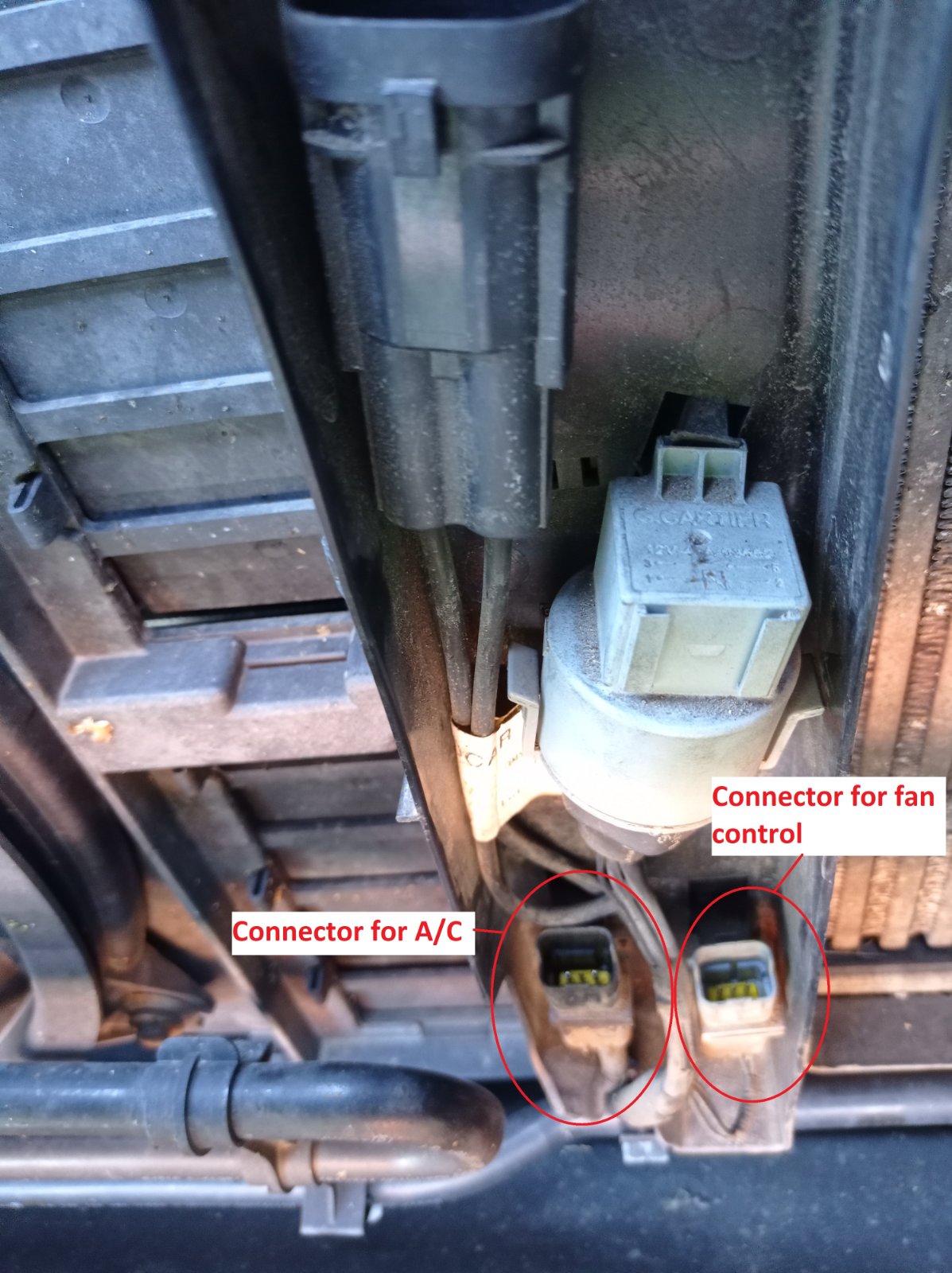

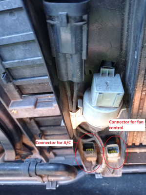

Sorry, my reference fan is good for my car. Yesterday I assembled it and works as well.
I misunderstood roles of connectors. The another connector is for A/C.
