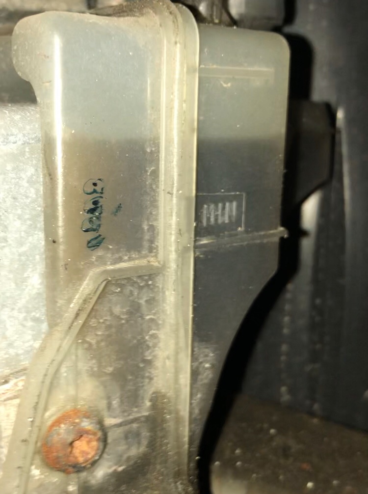

Hi, im attaching the photo of the my Peugeot Partner Tepee Actuator Hydraulic tank. My question is the level. Should i top up it or it’s the normal level ?

The level is only checked with the system depressurised, which needs a diag computer, and can lead to a world of pain. If it's working and not leaking, I would leave it well alone!!
x 6954
Re: Peugeot Partner Tepee Semi automatic Actuator hydraulic level
^ Absolutely, as Richard says ^

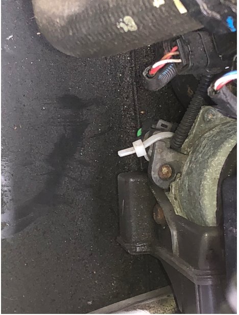

Hi Richard, thank you for your helpful response. My car judders in 1st gear when pulling away. And it happens from time to time not always. Some days absolutely work very well. Some day Juddering at after every stop-pull away. The car still under warranty, when I took it to the service place, the car stopped juddering and I couldn't prove the problem at all. They didn't do Diagnose with a computer because no obvious juddering at all...
I noticed that if I drove it over 50miles juddering stops a while. In another case, if I do over 50 stops in a day (in the traffic jam) then juddering starts. Sometimes just in the morning from the first start pulling away juddering terribly even you can't go forward until you stop the engine and start it again... then everything goes well...
i didn't see any oil drops on the ground (parking place) but my car has engine shield under car and i noticed that the around actuator little bit wet (I'm attaching an other photo for it) . That is why I've got suspicions about the hydraulic level.
