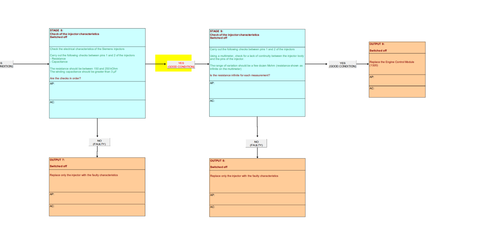

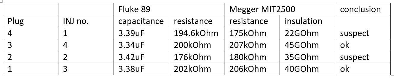

I carried out some further measurements on the injectors and came up with the following results:
The two that have tripped the ECU are INJ 1 and INJ2 we can see there is a subtle difference between the "coil" resistance of these two versus the other two. However, all are still within the tolerances put forward in the P0262 diagnosis tree, an extract of which is included below. The engine is running fine with balanced operation at all other times. The insulation values above include the ECU to injector wiring harness and this has been inspected to verify there is no damage or contamination etc.
So, currently, without any clarity on the normal operating voltage for these injectors, my suspicion is that Injectors 1 & 2 are in the process of failing, which is in line with RichardW's initial diagnosis, and I assume the ECU voltage I'm seeing is normal otherwise it should show up as an ECU error.
However, as it stands, the fault tree would direct me just to replace the ECU.
Both are costly experiments to get wrong, so it would be really good to have some form of confirmation regarding the normal peak voltage levels the SID 807 ECU puts out to these injectors Part no: 9802448680 (Siemens VDO part No. A2C59513556).

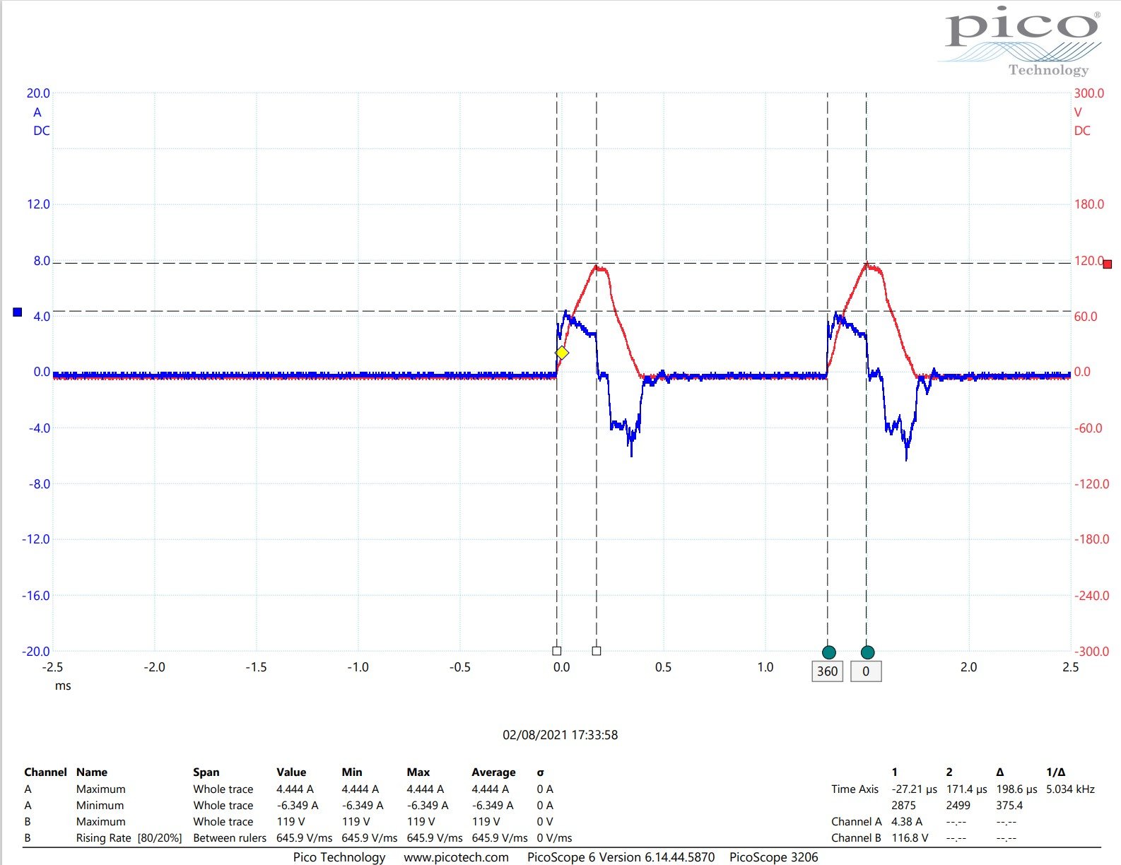

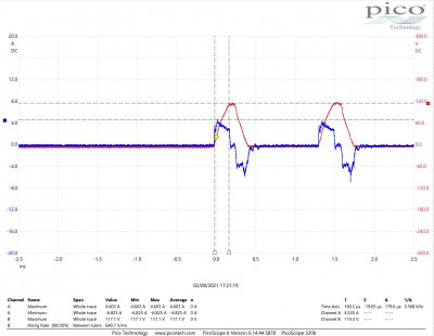

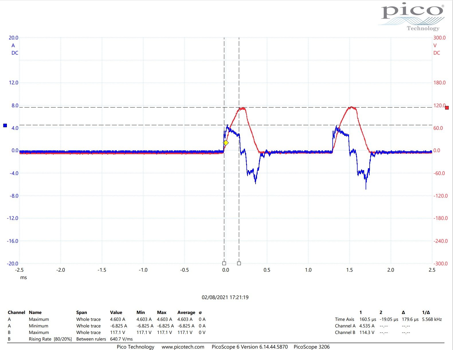

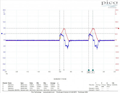

Ok, so I have now carried out scope voltage and current measurements on the car and can confirm that the control voltage reported in diagbox is not the voltage which ends up at the injectors:
Injector 1 (suspect)
Injector 4 (assumed ok)
Here we can see that the peak voltage at the injectors is around 117V. So I assume the internal ECU power electronics structure is such that the injector peak voltage is limited to approximately half the value reported in diagbox. So my initial concern was unfounded. Occupational hazard of trying to learn as you go along....
Reassuringly, my scope plots are actually quite similar to the one published by markstammersdiagnostics.
Needless to say, there is very little obvious difference in the scope traces between the "failing" injectors and the "good" injectors so its still a difficult call as to what's actually going on.
Intermittent faults are just the worst!
