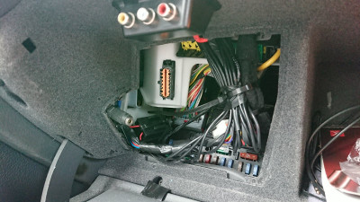

For the RAC thing, I did get a picture of it:
It's tucked behind that pop-out panel on the side of the glovebox, visible when you open the door. Flashing red light on it, and has a round aerial looking thing stuck to the windscreen behind the mirror too.
Not too bothered about it being there really, it looks fairly well wired-in so I don't really want to go pulling it out and risk disconnecting something else, but I may unplug it if it's not an original accessory or something.
Incidentally, now I look at it, it was added in May '06 and my car was registered in March, so must have been added after-sale.

Right that's a Smart Nav MC45 - it's an aftermarket Sat Nav unit - so a bit ancient now - a few of them on ebay. I'd be interested to know if they have replaced the multifunction screen with the one that comes with this or whether it is separate? The Factory fitted units units for this year were the RT3/4 systems with large colour screen - so maybe it had a fault and they fitted this aftermarket system. I would be wondering whether that has compromised other vehicle functionality as a result...

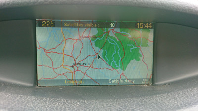

Do you have your VIN so I can see what you had at factory? A picture of the MFD display screen would be useful to.

- RT3 I believe? Seems standard to me, but I'm no expert. CD in the player is a NAVTEQ "ON BOARD Cartographic CD with the Major Roads of Europe" IT/Telecoms System, 2005/2006 second edition.
That's the glovebox, you can see the wiring for the Smart Nav, it's off to the left behind the left wall of the glovebox, that 3.5mm jack is part of it.

olliejolly wrote: 23 Jul 2021, 15:56 RT3 I believe? Seems standard to me, but I'm no expert. CD in the player is a NAVTEQ "ON BOARD Cartographic CD with the Major Roads of Europe" IT/Telecoms System, 2005/2006 second edition.
That's (what I assume to be) the GPS aerial.
I had one of these.
Yes that's the RT3 and looks unmodified - not standard - was top of the range at the time.
If it 's the system I'm thinking about, it was a Trafficmaster solution with various options and is supposed to have a small LCD screen that is attached to it. I would get rid of it as it's nothing to do with the original RT3 and yes, the NAVTEQ CD is the mapping data for the unit for the specific year. You load in different countries form the various multi CD pack that came with it - I suspect you have the UK loaded - so leave it as it is, although it will be well out of date by now. That may be another reason for fitting an aftermarket solution that itself is likely now longer supported now and is useless without the screen in any case.
