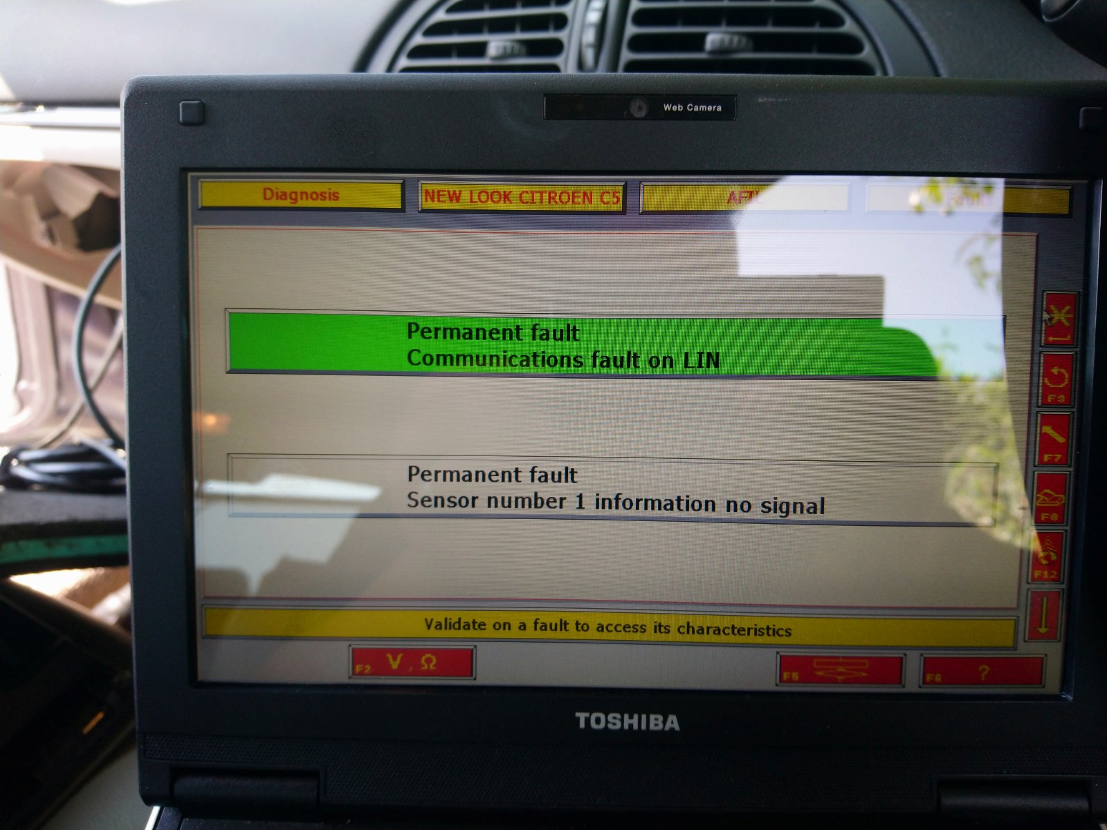

Here are sequence of shots of the lexia report. Interestingly sensor 1 has now developed a fault..
Interestingly the fault last time was a short circuit. But this time its different..

So there's the likely culprit I think. There are no codes I have for the LDWS - so if you are keen on replacing it, you'll need to carry out the programming procedure on all the sensors Paul.

Re: 2006 C5 Ldws
I'll try it next week when the weather is cooler. I don't have that much energy in this hot weather.
But I'd not think unprogramed sensors would cause a communication fault.

Re: 2006 C5 Ldws
No, but the system won’t operate unless all the sensors are operational and programmed for safety reasons.
