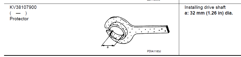

I've ordered the ATF and Moly grease from opie oils, and also a small bag of split pins for the hub nuts from ebay, so onto the next problems....!
The first is that I can't for the life of me find the size/thread of the nylock nuts for the lower ball joint and track rod end for the hubs so that I can get some new nuts in. I've scoured the digital copies of the service manual that I have but it just doesn't seem to be in it. (It gives torques but not nut diameter/thread)
Would this information normally be in a separate parts catalogue ?

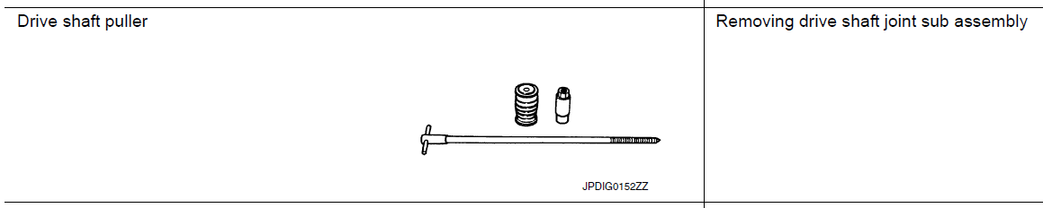

While browsing the procedures they also make reference to a couple of special tools - one a driveshaft puller, and another a guide tool to insert the driveshafts into the gearbox without damaging the seals:
How necessary are these tools ? The Seal protector is around £125 alone.
Another thing I'm wondering about is what holds the driveshafts in the gearbox - is there a split spring in a groove that prevents it pulling out and if so how is that released ?
Just by pulling adequately hard or is this where the drive shaft puller tool comes in ?
Even though I have the full service manuals a lot of this just isn't clear.

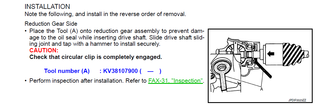

IIRC, there's a similar drive shaft seal protector recommended for PSA cars, but it essentially just consists of a short length of thin polythene tubing, pushed into the seal opening first, and then the shaft inserted.
I think BoLs has pics of it.
Even just a piece of builder's polythene put inside the seal would protect it while the (oiled) splined shaft goes in,

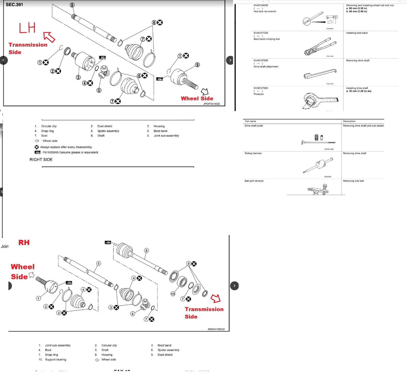

Well for viewers if not for yourself Simon these are the pictures from the Manual.
Can't see anything on them which would point to any special method of removing the driveshafts.
Gibbo would have removed driveshafts in say 10,000's, me probably in the dozens and some time ago
They should just pull/pry out. In amongst my 12 or so was an driveshaft on a ford Mondeo which wouldn't come out. Eventually did with a painstaking use of a clamp on the shaft giving a surface to exert backwards force with a few blows of a lump hammer in a painstaking circular, hammer, turn, hammer, turn repeat.
Don't think any of the Nissan specific tools listed will be necessary, but a set of pry bars if you don't have them would assist.
Click the pic a couple of times and it gets readable edit just to add the e-bay Nissan Leaf Driveshafts as mentioned by Richard Regards Neil

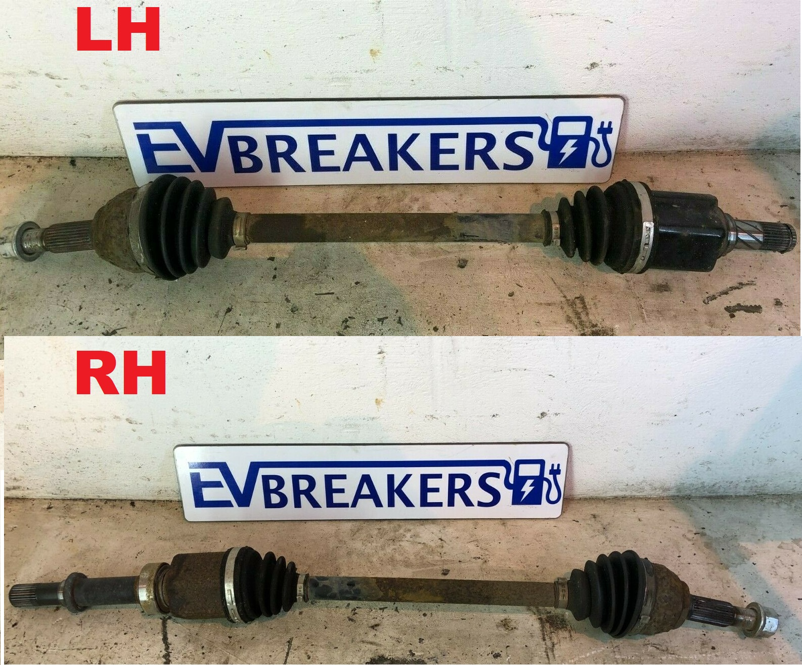

- Posts: 12585
- x 1488
Re: Simon's new Xantia V6 and Leaf blog
A look at a LH drive shaft on e-bay shows a good difference between the splines and the seal surface, so unless you are completely cack handed the seal won't get wrecked even without the protector - the RH driveshaft the difference is less, but still do able.
A Juke appears to use a very similar driveshaft and front end lay out. This video of a Juke clutch change shows the removal of the LH shaft at about 4min in, it doesn't seem to be too hard to overcome the circlip. Re-installation at about 50min, again seems to go back pretty easy, so I can't see a need for the driveshaft tool, that is probably for dismantling the shaft for boot changing. Early part of the video shows the process of splitting the lower ball joint. Should be no need to undo the track rod end, but that doesn't help with the nut size of ball joint (of course here the original nut is re-fitted) It shouldn't be too hard to whip one of the nuts off the car and measure it.
Grease for the motor splines should be clear once off - if t's all black use the Moly grease, if it's not, use a std grease

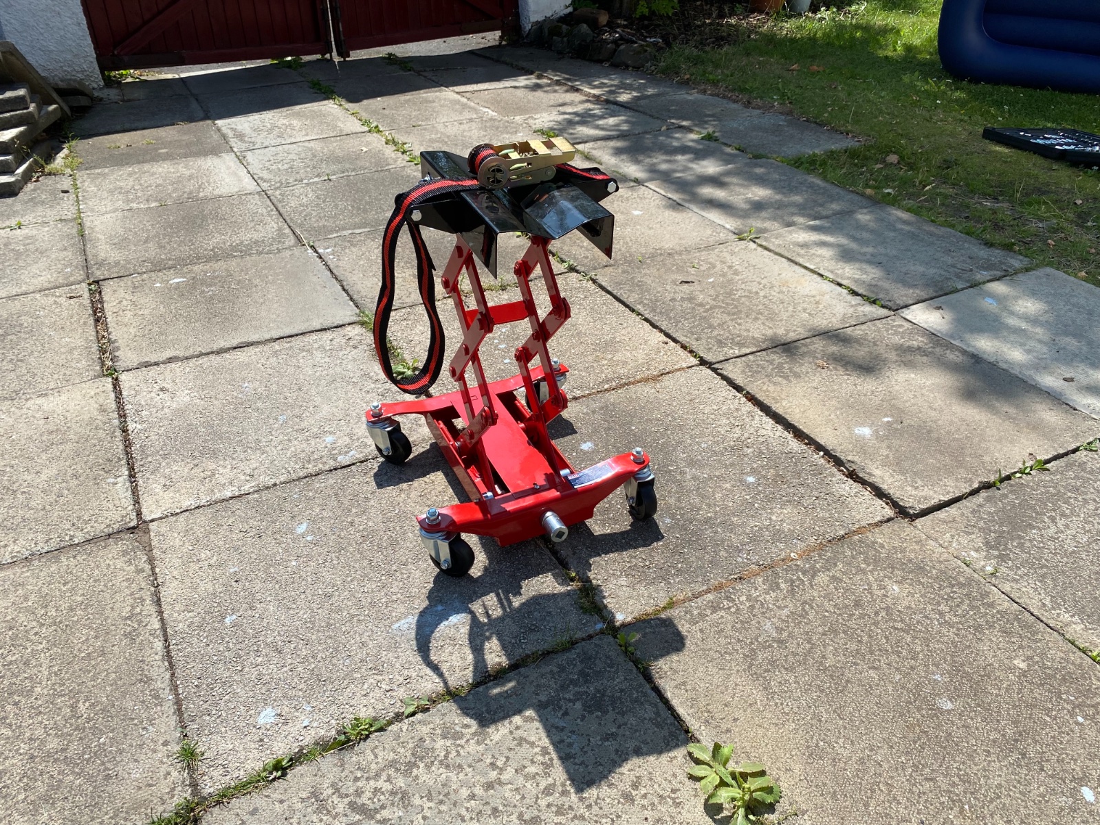

This arrived today
Looks like it will be perfect for the job. As soon as the gearbox is pulled slightly apart (but still engaged with the motor shaft) I should be able to slip the strap up between them and strap tightly onto the gearbox before I finish pulling it across and then lowering it down, so no real risk of losing control of it.

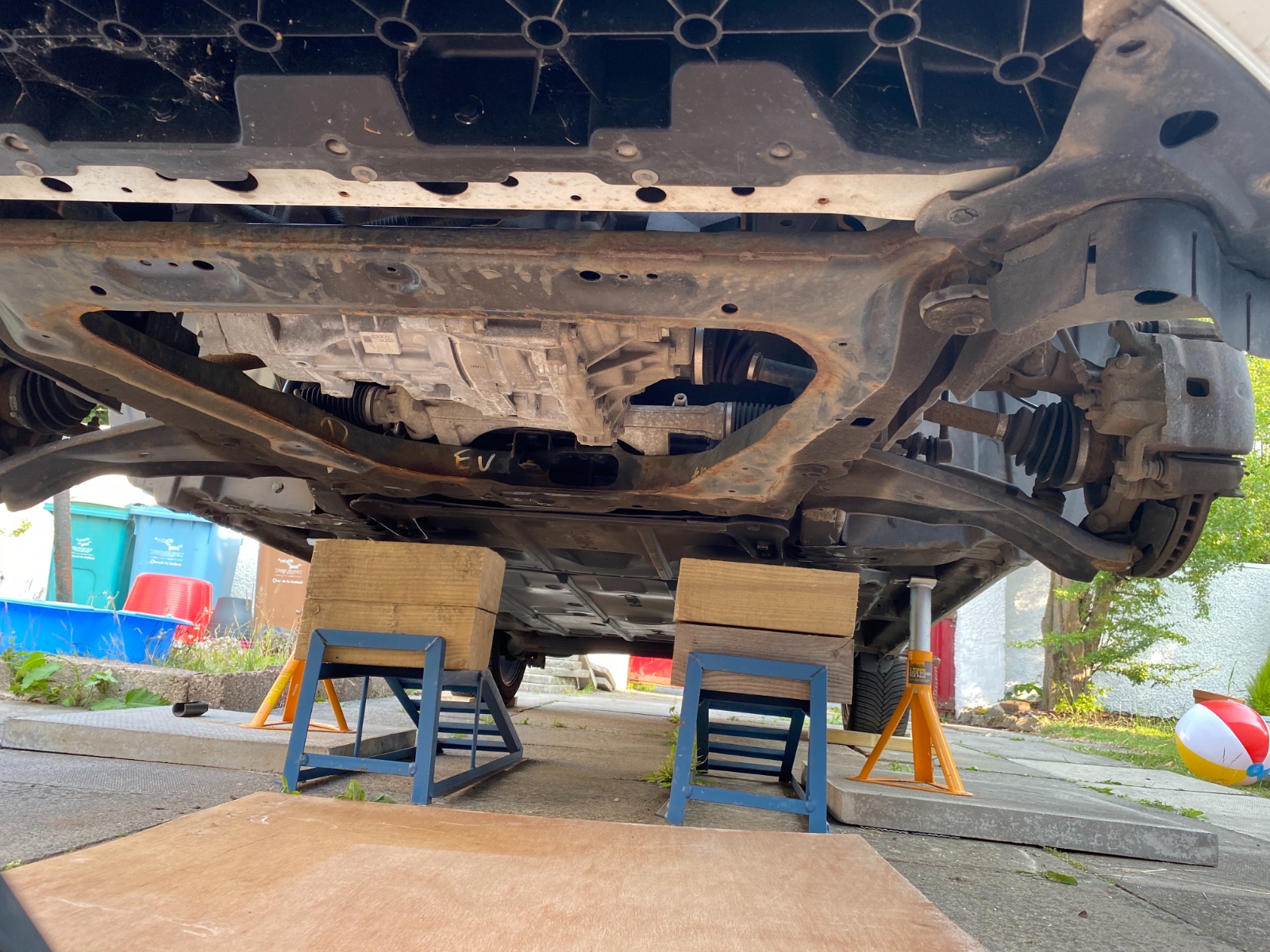

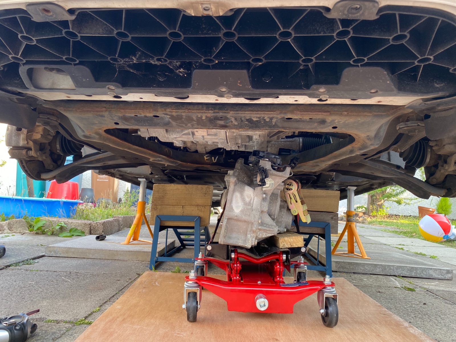

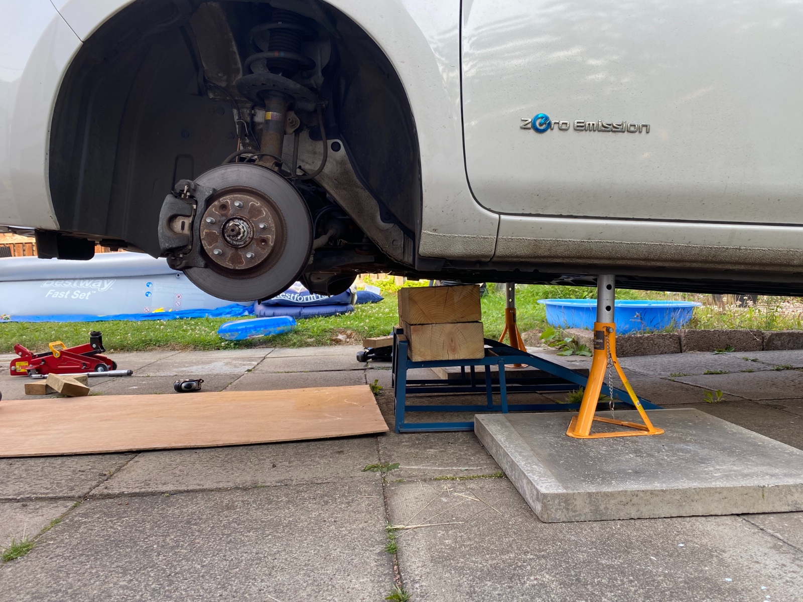

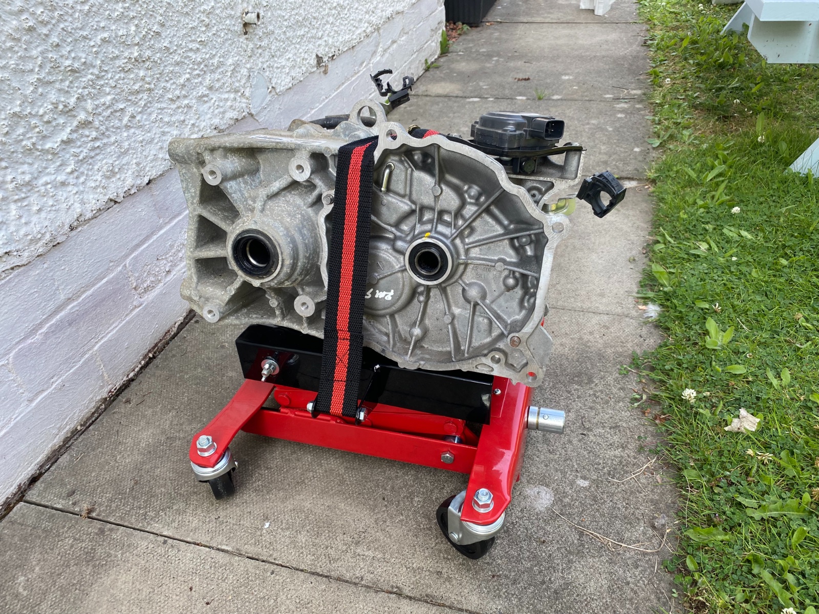

Well I didn't get as much done today as I hoped, but I keep forgetting that I'm old, out of shape and unfit so everything takes twice as long as I think it should. I'm certainly going to be sore tomorrow.
I gave the "new" gearbox a try on the stand and it fits well, being quite a small gearbox!
A lot of the challenge was getting the car at just the right height with what I have available so the transmission stand could reach the gearbox but also let it roll out underneath. I ended up with the front crossmember being 550mm from the ground which gives about 100mm clearance when the stand is down and 100mm of spare reach available at the top:
The "new" gearbox sitting below the old one still in the car:
I ended up having to use axle stands on driveway slabs to get the right height although I have ramps with sleeper blocks underneath as well as backups if the stands tip over or fail for any reason! It seems pretty solid though so I'm happy working under it.
I think I'm ready to drain the gearbox and tackle removing the driveshafts next. I plan to take a day off work on Wednesday as I need to be at work tomorrow and to be honest my body will thank me for the rest...
I've had all the plugs out of the "new" gearbox to check they all come out easily - there is a filler on the top, a level plug on the side near the back with a magnet and a drain plug near the bottom also with a magnet. There was a tiny bit of filings on the bottom plug magnet but nothing you wouldn't expect.
The only thing I haven't quite figured out yet is how to support the motor stack with the gearbox removed - it's too high for my new jack or axle stands. One possibility is a wooden beam underneath strapped to the cross members however I forgot to order any ratchet straps. I do have some chain and shackles that might work but its probably not ideal.
