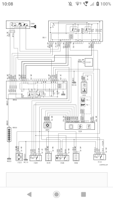

white exec wrote: 15 Jul 2021, 20:07 Single fan, so there must be a dropper resistance there somewhere, to provide slow speed.
Is the resistance and its connections ok?
It's slow speed that should happen when AC is switched on.
Pulling the temp sensor normally triggers high speed (a fail-safe mode).
Fan likely to be 100...150W, so use a couple of H1 bulbs in parallel (or an H4 both filaments) as substitute.
I don't have the wiring diagram here. Can you post it?
Yes. Here.

Re: 2004 c5 hdi 110 cooling fan woes
Hi Paul,
That looks like a 3-speed fan set-up, using 3 relays and 2 dropper resistors.
I don't have a list of those components codes, so am just following the connections.

MGmike
Posts: 182
Joined: 29 Aug 2020, 18:29
x 63
Unread post by MGmike »
I agree with Chris, it's a three speed fan determined by the relays and the dropper resistors.
1509 is a straight forward full speed controlled by the ECU when the coolant temp gets too high.
1508 is the slowest speed, again controlled by the ECU but probably when the a/c is on but it may actually be on all the time.
1548 is the stranger one as its controlled by the BSI, possibly when the a/c is on? However it gets it's main power feed from 1508 and therefore unless 1508 is activated it does nothing. That said, when both are activated they feed the motor via two resistors providing an intermediate speed.
I would concentrate on relay 1508 to start with... If you pull the relay and insert a bridge wire on 3 & 5 the fan should run at a low speed.
If it does... great you have a relay fault (note: is a special(ish) relay with a diode in to protect the ECU and must be replaced by one of the same type). If the motor doesn't run you need to check the wiring and resistor 1506. (let us know what the resistance measures at and we'll be able to work out what the operating voltage and current will be for each speed).
The big kicker here is you might still have a fan motor fault! You know the fan runs at full speed but you don't know what voltage is needed to run it at the lower speeds. Stiction in the motor could require more volts/amps to overcome than the resistor allows. To partly prove this, bridge pins 3 & 5 on both 1508 and 1514. Hopefully the motor will run but probably it won't be as fast as it should be.
