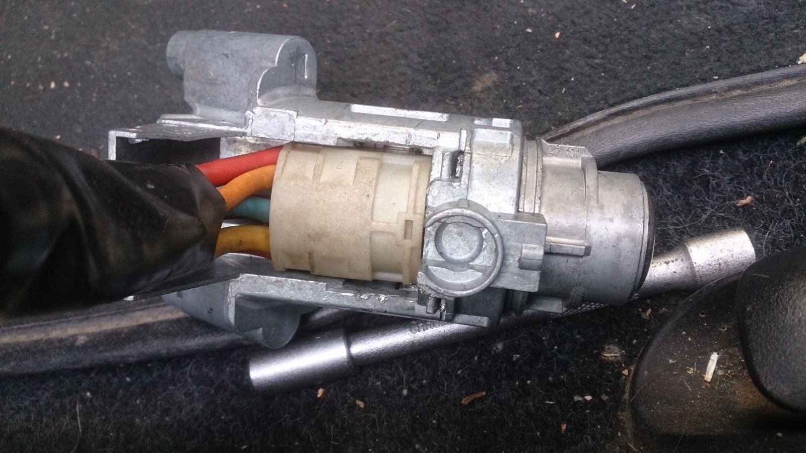

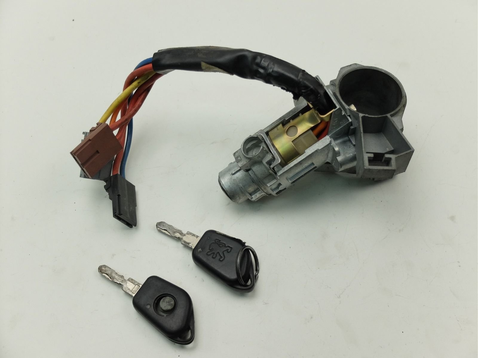

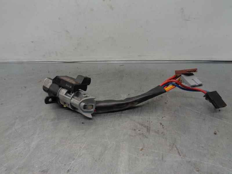

I'm glad I took the covers off... did it today and was easy. It's in fact the other one that exists. The key barrel is 447022. Here are some photos (not so good... hard to take...) I took of it and also a couple of images off the net. Now I know how to find the right one and order. I think it won't be very easy to fit, though, because the cables are all very tightly packed together and access is difficult, I also remember reading in Haynes manual about some "locking pin", but I'll research well and maybe there's even some video on Youtube, you never know. It also helps that I found pics on the net of the whole thing dismantled, helps to understand how it goes all together. Most of them are the complete unit. One of them shows only the ignition switch itself. Images from the net:

I already ordered a used key barrel with ignition switch that I found online here in PT for a very low price and appears to be in very good condition.
Now, there are a couple of things I'm not sure I understand well: this comes complete with keys and everything - if the barrel happens to be in much better shape than mine (which seems very worn), can I exchange it? This would mean that I'd have to use the old key for opening the doors and the "new" for ignition? Wouldn't that raise a problem with the transponder security thing? I mean, that black chip that's contained inside the key fob. Or does the car have the ability to synchronize to more than one key at a time? This makes me remember that I tried to resynchronize with the existing key (as the remote control is not working, although I'm positive I might have repaired it, at least red light goes on), following instructions found on the internet, but the car didn't reply to this (no beeps) and the remote didn't start working, Could this mean there's a problem with the electronics responsible for this and could this make the use of a different key barrel and key impossible? I don't want to end up having to take the key barrel out again because the car doesn't start anymore...
If there's any risk of this happening, I will only substitute the ignition switch, not the key barrel.

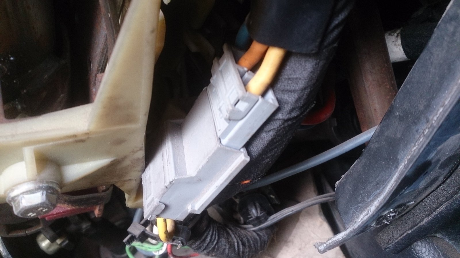

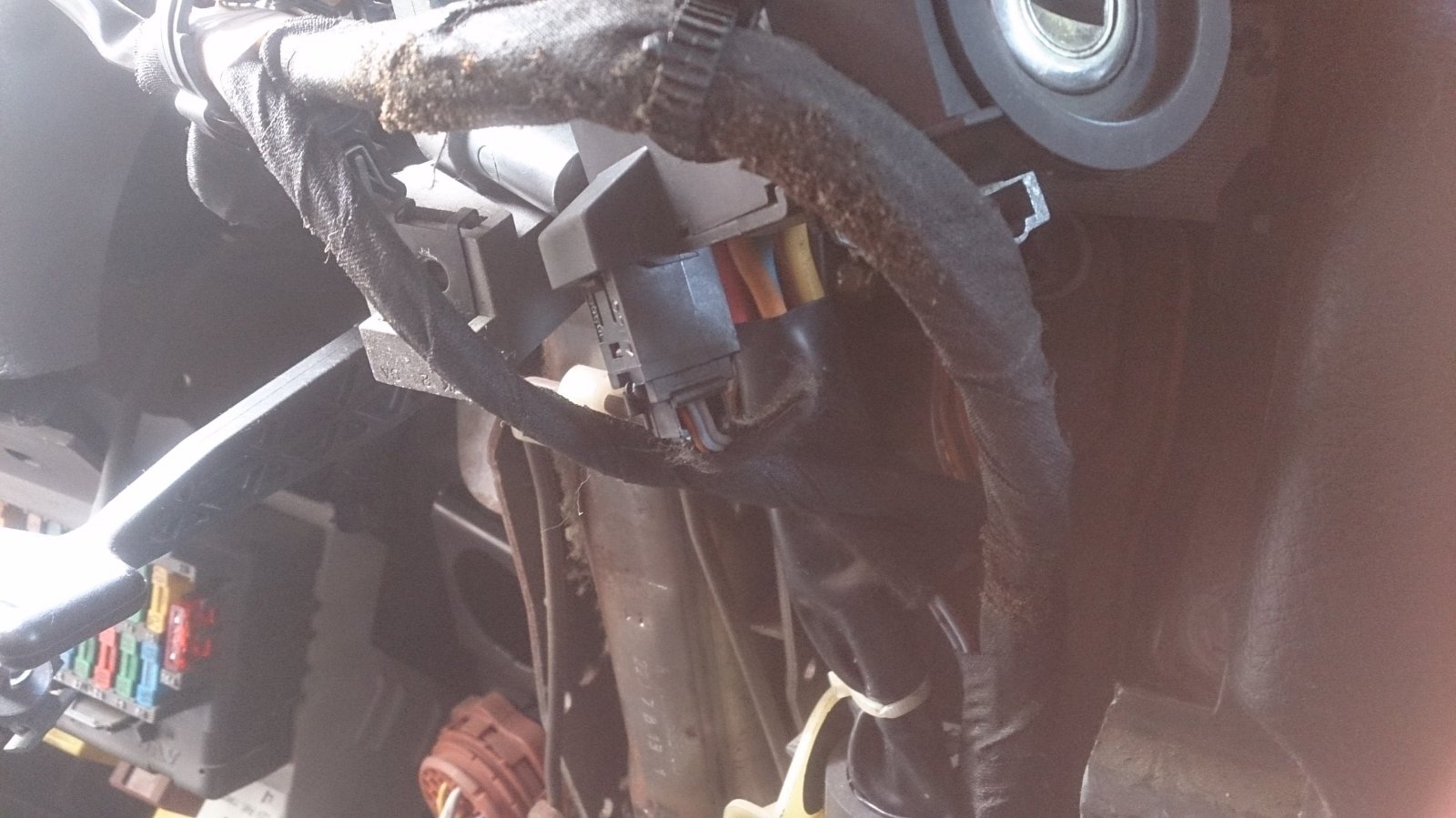

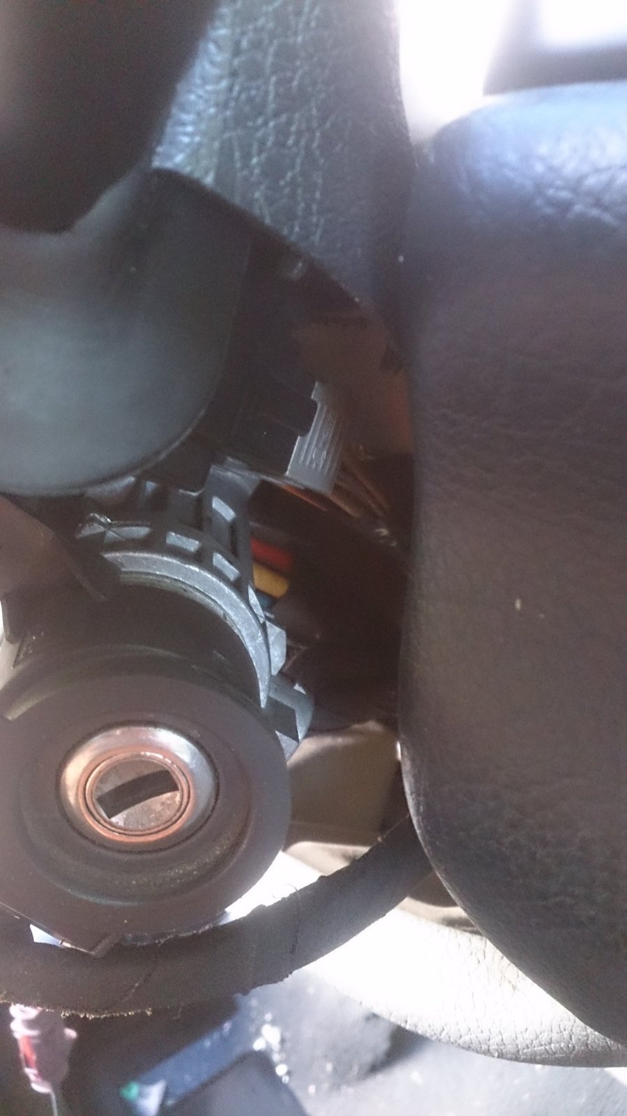

So, I just replaced the ignition switch. While unmounting, I discovered that someone had butchered the locking clip, possibly when the contacts for the blower motor were destroyed: probably they didn't know about the fact that key has to be put into position 1 to be able to release the clip. Incredible. So, they had just broken off the clip at its base, then probably managed somehow to press them out from the top, I don't know, and later fit in back the remains so that barrel wouldn't fall out. It meant that I had to unmount the whole barrel/ignitions switch assembly from the steering column (fortunately easy, just two hex screws) and spent a good half an hour with trying to remove the two remains of the clip, finally I managed to do it. I then unmounted the ignition switch from the barrel I bought (decided not to change the barrel - although it is in better shape, key springs well into positions, because I didn't want the trouble with the two different keys and all) and mounted it into the existing barrel, attaching the "new" clip and also the wiring retention clip (they hadn't fitted it - it simply wasn't there). Assembled it all back together and works fine. I now think that the problem would have been caused by a combination of two things: the barrel being worn, which means I have in fact to be careful as a lot of keys on the key bunch or my knee might turn the key slightly back, which could switch ignition off. But the other factor would surely have been the ignition switch itself, not only because it was probably worn, but also because they didn't mount the wiring retention and the locking clip was broken, so the whole thing was kind of loose.
So I hope it will be fine now, even without changing the barrel. Let's see.
Btw, interesting side note: the used ignition switch I bought, although looking good and measuring well (and working well for me) has a tiny problem, guess what? those damn blower motor contacts are gone... They really made a design fault with this, no matter usually has to be fixed in the vast majority of Peugeot and Citroen which used this method from that time. For me it's no problem, as here it has already been fixed, being the blower powered by a different wire.
Here's how it looked like when I got to it: no wiring retention and locking clip broken into two bits which were stuck in there. Second photo shows them out, after hard work...
