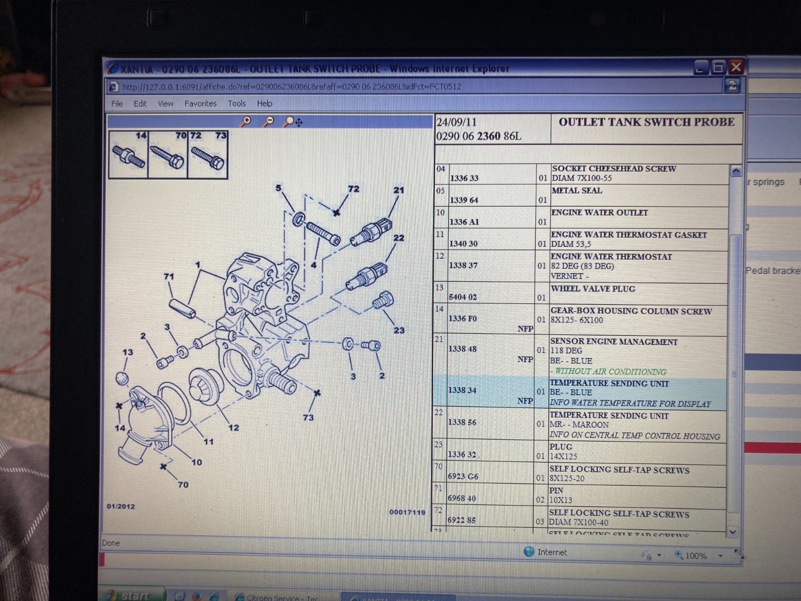

Thank you for that. I’ve just taken a look on service box and found the following sensors:white exec wrote: 11 Jul 2021, 18:53 Yes it does.
Two, or even three, temp sensors on the water outlet:
- gauge (referred to as Dial on many circuit diagrams)
- injection ECU*
- cooling fan(s) control*
* rolled into one on later cars.
So as I have air conditioning (which works!!) I would imagine I have the two sensors labelled 1338 34 and 1338 56. I wonder whether my blue sensor is the problematic one?
Thanks for the suggestion on the coil pack, I did actually change my coil pack and the igniter (I think that’s what it’s called anyway, a little flat plate device mounted to the chassis with thermal compound for heat dissipation) just as a matter of course. I might try and refit my old coil pack if the temperature sensor comes back as working, so thank you again for the suggestion.

Re: 2.0 CT Engine Hot Idle Issues
Typically the sensors are very hard to reach.. Doh! I was considering disconnecting them to see which exactly does the gauge and which does the ECU. Presumably if the ECU one is faulty, removing it either won't make any difference (if it is open circuit), or it will make a difference (if it's reading one set value).
I've found an OE blue sensor for £15, and unfortunately for the maroon sensor I can only find non OE, on ebay at least:
https://www.ebay.co.uk/itm/362502896369 ... SwVCpcCOdg
It's part number on the advert title is different, but the list of part numbers in the description cover the one I need. I can't tell whether it's the right one though, maroon, brown, who knows!
