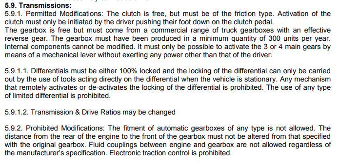

Now, how am I going to get back on track and pass muster? By printing out a bit of regulations for the 2019 British Truck Racing.
So, automatics, fluid flywheels and DCT's are banned. Everything has to be basically driver operated, mechanical and a single friction clutch initiated by your foot is all that is allowed when you read further into the regs. So how does that square with modern trucks and transmissions? Answer. It doesn't! It just makes policing the racing easier.
Monster Trucks are pretty much universally automatics and they race a lot. Paris Dakar Raid Trucks are often automatics and more recently automated manuals. So it seems that Trucks could race with Auto boxes - it is just convenient to not allow it. Bit like formula ford for HGV's.

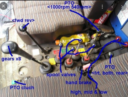

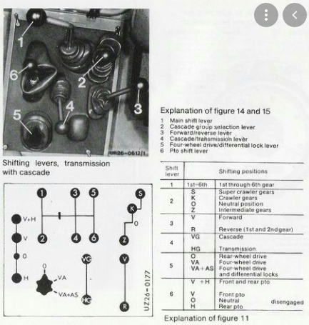

You mean a bit like these.
If it was a Scottish spec Unimog the bottles would be Irn Bru

Yep, the B&W photo is the one
Brings back memories
There were also 2 levers on the steering column for front and rear hydraulics for those that thought 5 levers and a switch weren't enough
My boss never could get the hang of all the levers and many's the time I'd climb into it and have to put the levers in their correct position before setting off

Yip. the top one is an old style 406. The lower one is it's newer, bigger brother.

I will admit I struggled with the gears until I got the lock out spools idea into my head that limited the number of reverse gears available. After that I wasn't so bad.

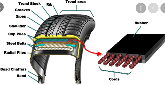

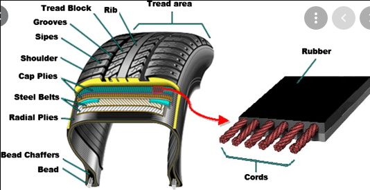

Now seems a pretty good time to head into tyre technology since it seems I have some extreme/non mainstream views on tyres if you have followed all of my postings.
F1 is awash with theories about Pirelli tyres just now, but in the defence of both Pirelli and the F1 teams, tyre specifications are there to be pushed to the limits ( just, hopefully, not beyond ).
this picture is a good guide of how tyres are made up.
Now, I went for a job where I ended up arguing with the Head of Vehicle Maintenance about tread grip and block pattern during the interview and I got the job in spite of him. Probably ( no, actually ) because no one else wanted it. It reinforced two things - one, when I know I am right I will not back down, and two, it is amazing how many people don't fully understand what they are talking about.
He had seen all these types of pretty pictures but just didn't understand how it all worked and had relied on the mainstream, straight down the middle advice given out to people like him who didn't/couldn't ask more probing questions.

What this diagram, and many like it, doesn't detail is side wall construction.
The way a side wall behaves is absolutely crucial to tyre life and behaviour. Everyone obsesses about tread wear, sipe efficiency, block pattern, compound et al, but no one seems to worry about side walls. They batter kerbs. They scuff obstacles. They wear to the point where you can't read the writing. And yet they never get mentioned. But they seem to get blamed for a lot of things.
If they crack, it's their issue.
if they cut, it's their issue.
if they separate and bulge, it's their issue.
It is like they are not part of the tyre.
