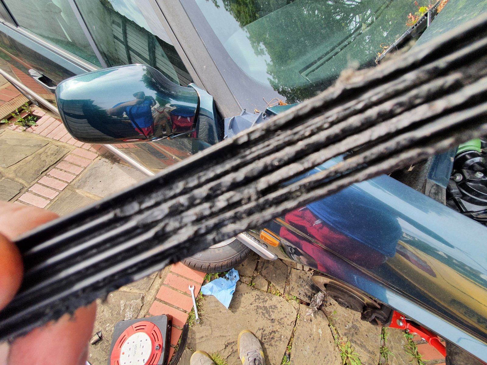

I decided to try and sort out the auxiliary belt noise to see if I can find the source of the other noise when the chirping is gone. I have the aux belt off, it was shredded so didn't have much time left. The alternator is noisy when spun backwards but not in the correct direction so not sure if that is the cause of the noise. however I did find a bit of movement (end float) in the LHM pump shaft when I pull on the pulley, you can move shaft in and out a few mm axially (but not in any other direction). Is this normal or is my pump knackered?
thanks
thanks

Thanks Chris. Appreciate that. I have the alternator off and the bearings are noisy. Just need to go through the minefield of figuring out what the correct replacement is. The alternator doesn't appear to have a one way cluch pulley from what I can see, but its not the original alternator. Is it possible to check the part numbers to see what it should be?
As for the belt, Its more worn through than shredded. perhaps someone tensioned it too much. it does have a one piece crank pulley damper not the one with the four bolts. It looks in reasonable shape from what I can see
