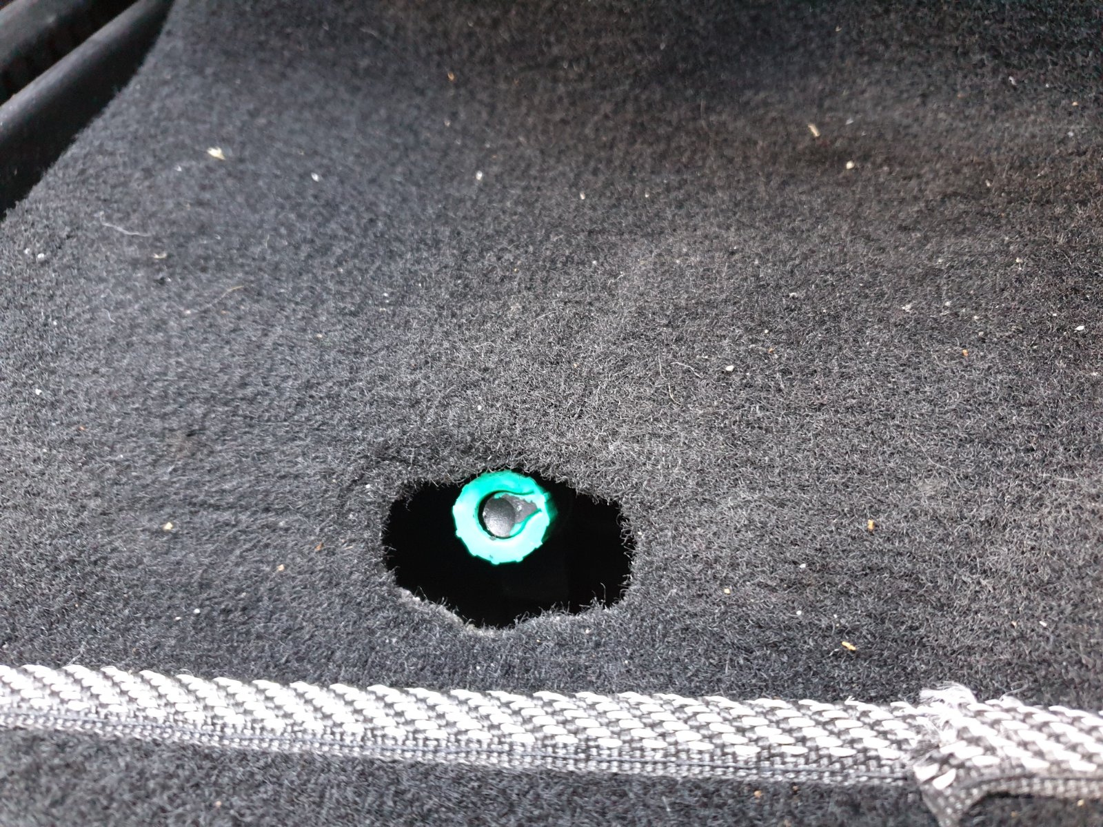

On the floor c4 grand picasso passenger side

MK1? Under the front passenger seat? Suspect that is the handbrake emergency release, it's supposed to have a plug in it

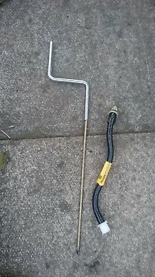

That’s exactly what it is. There should be a tool either in the rear underfloor storage compartment or in the tool kit.
Like the tool on the left.
