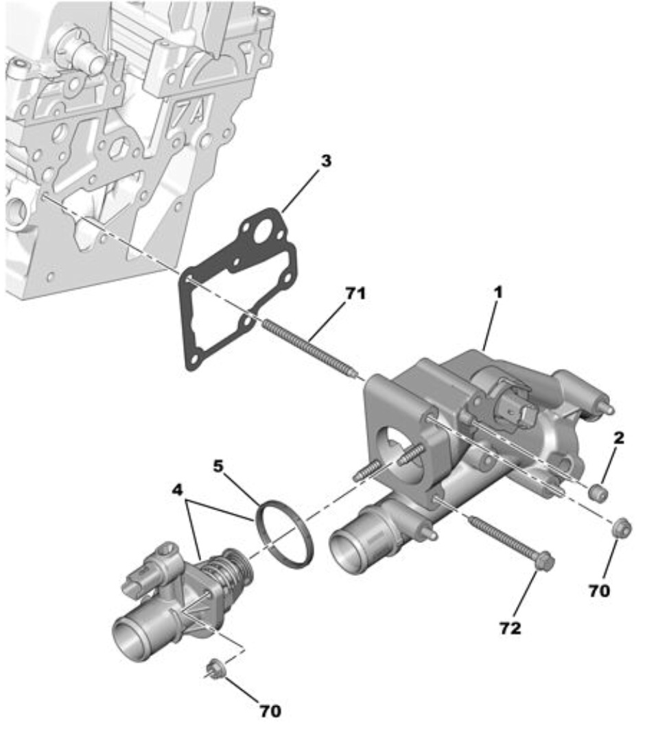

Hey all.
My engine, am gonna tackle the t'stat removal.
I believe its open and is why my fan never turns on. But am going to need pics of it's location on my EW10A RFJ engine.
You can say what component its next to, but then I'll need a pic of that also as reference!
The Haynes manual is no good, my engine not covered.
I have already changed the sensor, easy to reach.
Thermostat. C5 Petrol. 2.0 L

Here you go Sean.
This is the coolant outlet tank and the Thermostat is shown at (4).

Re: Thermostat. C5 Petrol. 2.0 L
Excellent.
That's my bank holiday taken care of!
I'll test it and the sensor also. Found some online guides.
