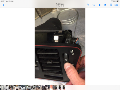

I should be getting the A/C pipes from the stand alone unit fitted this week, one to the drier bottle that’s already installed and we’ll leave the other one ‘long’. This way, I can re-plumb the water, and finally ‘button up’ the bulkhead area, fit the ducting inside and get it all blowing properly. Because I want to keep the interior looking completely standard, and because this heater A/C unit requires that the water is isolated before the A/C is turned on, I’ve converted the hot-cold dial on the centre vent to run a length of bike brake cable that still works in a rotary fashion, like the dial, but pulls/pushes so can be attached to the on-off water valve as it entered the heater unit, and yes, I’ve plumbed in an H piece ‘upstream’ so the engine still circulates water...!

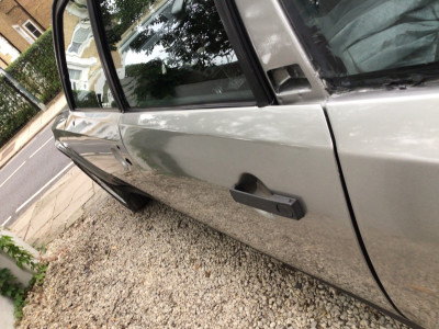

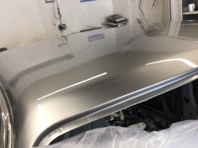

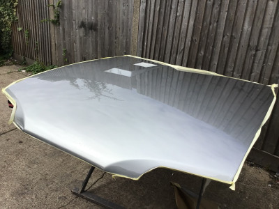

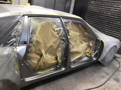

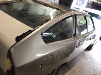

I’ve also been hard at work on the exterior appearance as the car is booked in for paint in about 5weeks!!!!

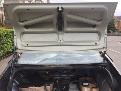

So, brand new bootlid, and very good bonnet and 4 very good ‘Turbo’ doors with all the correct trim, etc and working electric windows and central locking.

Edlandy
Posts: 13
Joined: 11 Feb 2021, 12:11
Re: GTI T2 ‘restobuild/mod’.....
Unread post by Edlandy »
Where the ell did you find a new boot lid!? ..and do they have another!

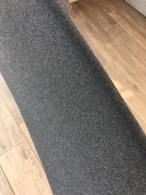

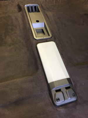

Lots and lots of progress. I’ve redone the headlining and had the A,B,C and other interior trim pieces ‘flocked’, the results are STUNNING!
AND………….
x 1751
Tell us about the flocking - who, where, cost?
And a few more pics, of course.
Looking increasingly splendid!

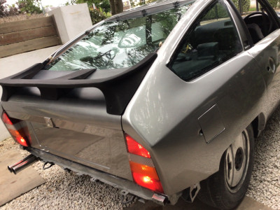

Ok, now this really is getting exciting and nerve wracking

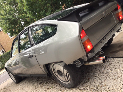

I’ve had the car back for a few days now and it’s slowly but surely coming together
