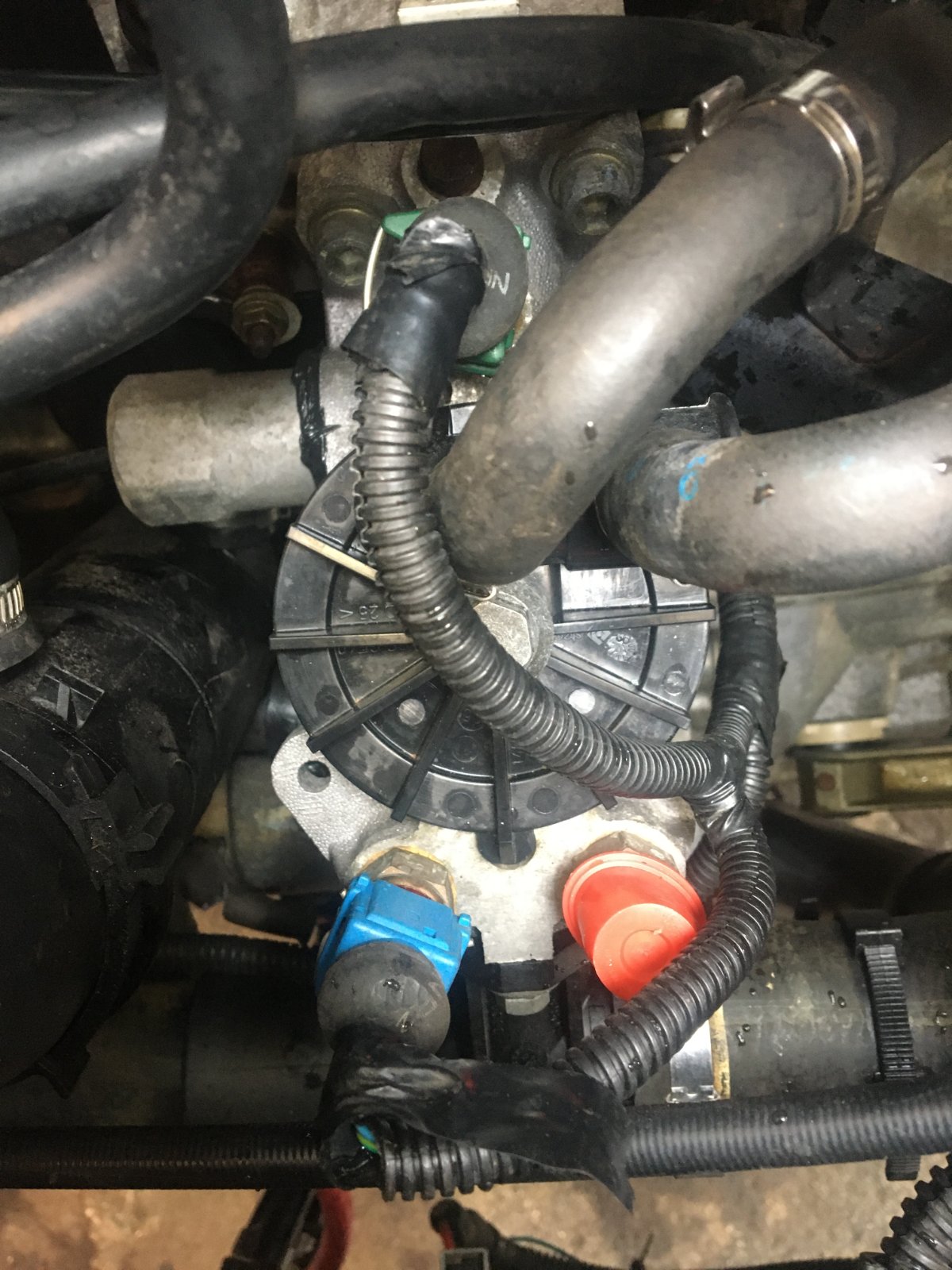

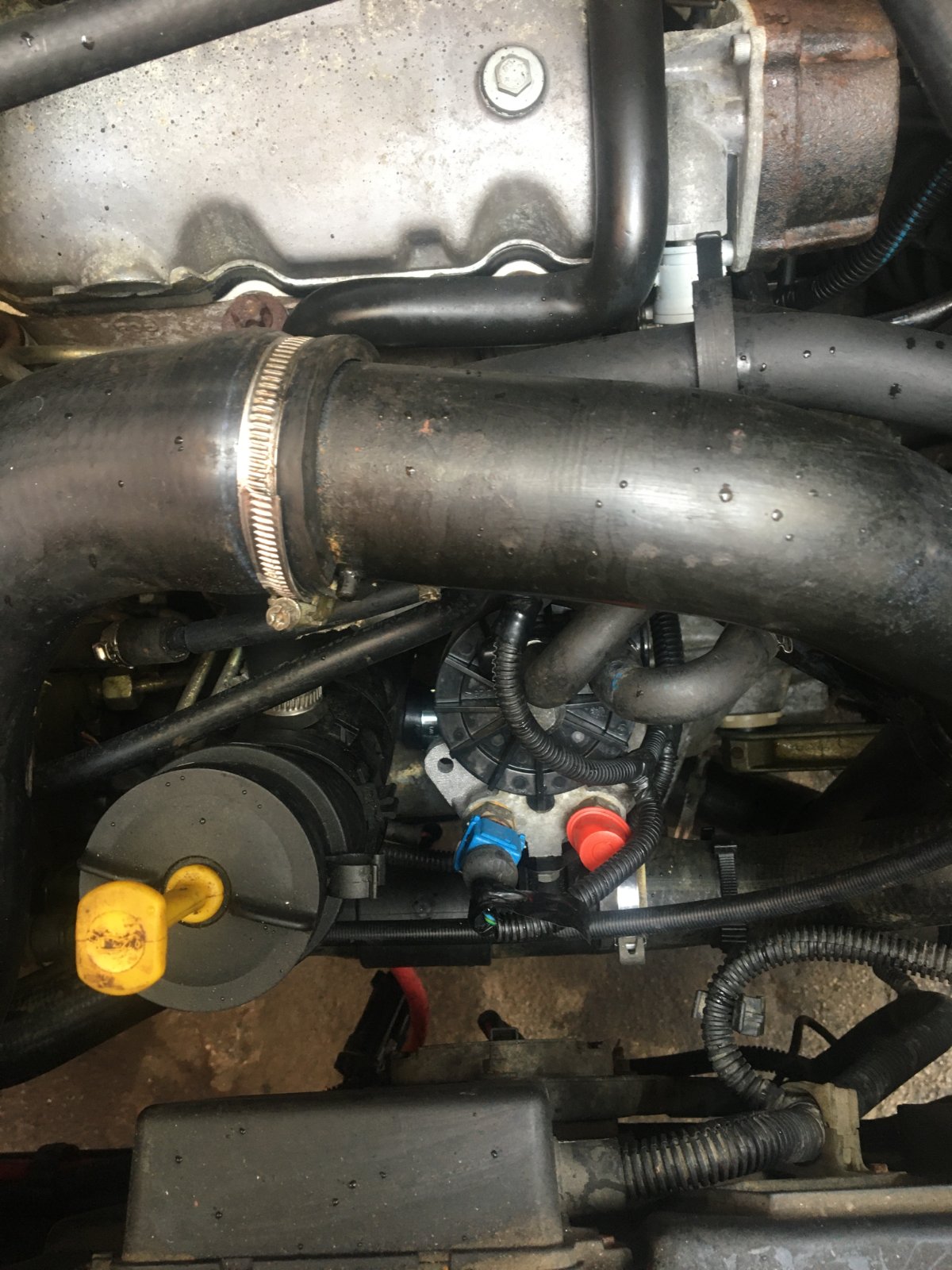

Re: Cooling fans.
Hello again,
The engine number is 6001644 (1.9TD ).....I think its XUD. It's from a (2002) Peugeot Boxer it's exactly the same as the 1998 engine that I took out.
It's a mechanical injector pump I think.
The thermostat housing has only two connections....one is blanked off with the red plug.[img]
I don't know where I'd find the relays unless theyre housed in the box attached to the radiator...you can see it in the image directly in front of the dipstick with the large wiring going in.
When I shorted the connector on the green plug to the sensor I could hear a clicking sound but I don't know where it was coming from...maybe the relay/s are damaged?
Hope this helps!
Thanks

Re: Cooling fans.
What is in the black box close to the yellow dipstick top?
How many wires are there at the blue and green sensors?
What is under the red cap - a sensor or a blanking bolt?
Can you also post a photo or two of the complete engine bay (not closeups), and one of the fuel injection pump?
