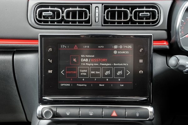

Hi all just purchased a c3 flair 2019 plate and it has a display screen like the photo attached
The issue I have is the external temperature on the screen stays at 85degrees top left does not change
Anyone aware of any issues with this thank you Simon

I suspect the sensor in the wing mirror may need replacing. On this model it should be on the passenger side wing mirror - there is a little dimple underneath that is the sensor.
So yes, take it back because this affects the Climate Control / Air Conditioning system as it uses the outside ambient temperature to determine operation.
