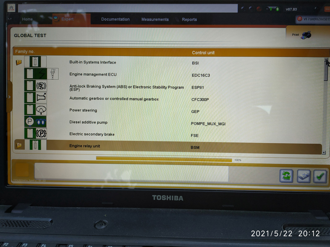

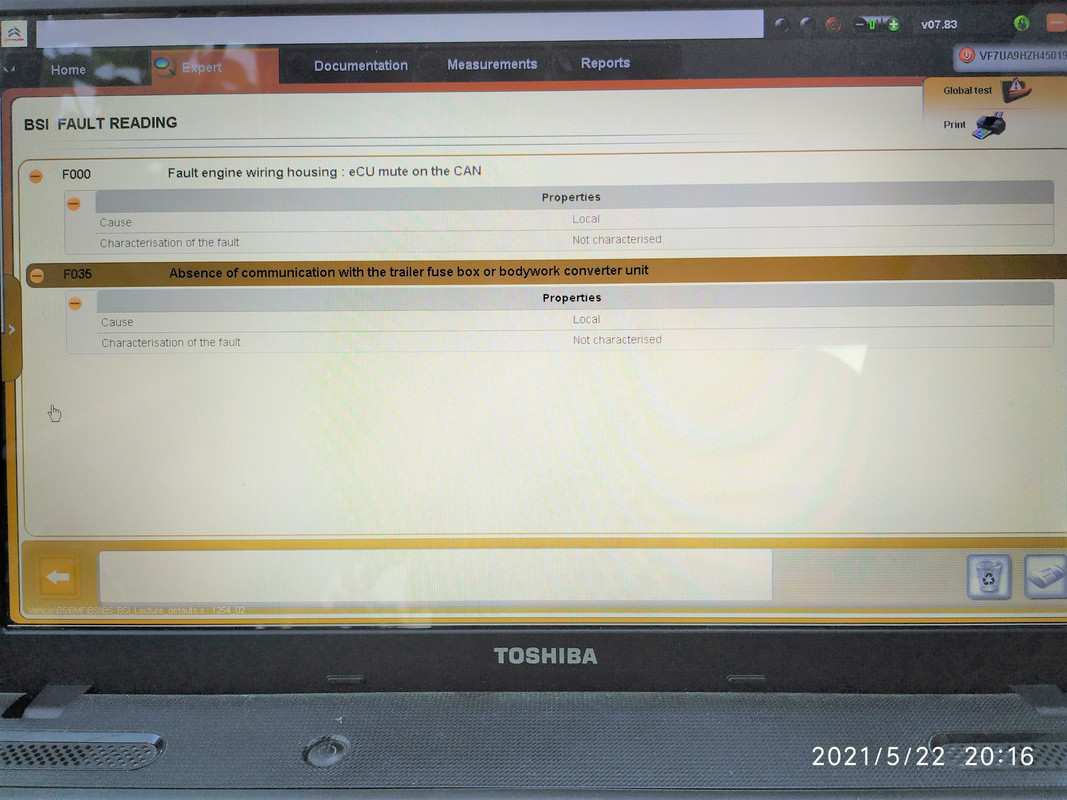

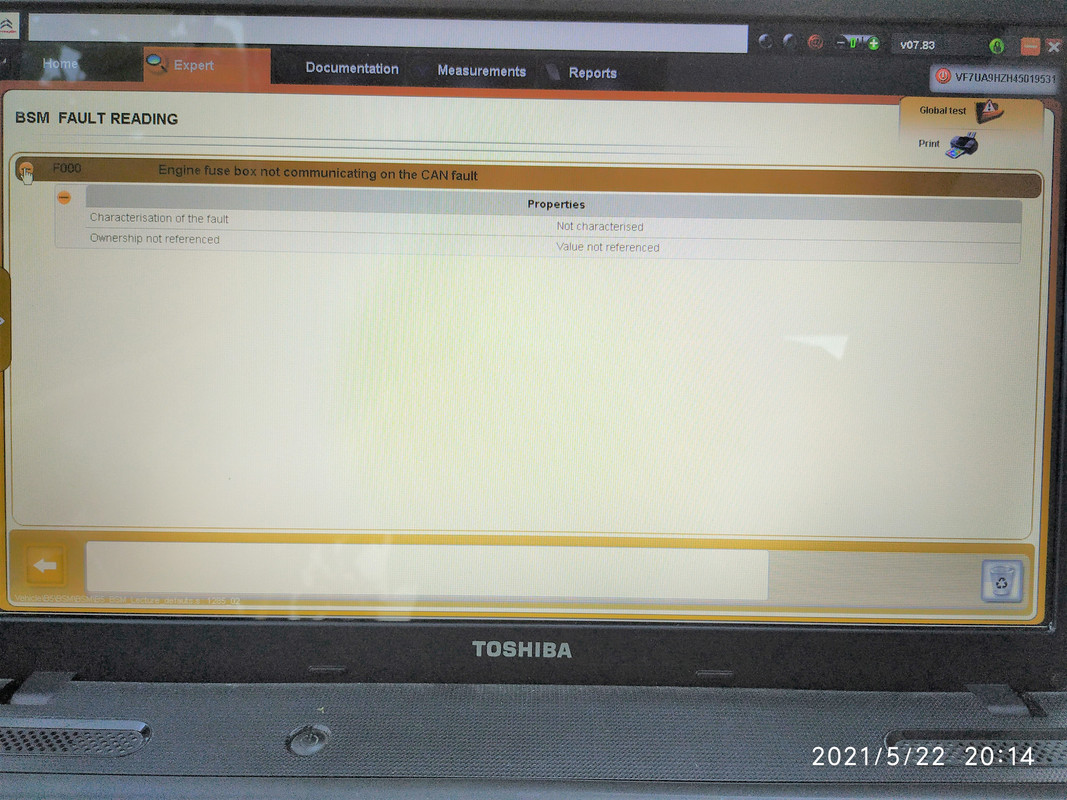

I connected the diagbox and I had these problems in the photos below which I believe are not related.

Does anyone know what the codes from the diagbox F000 and F035 mean in practice?

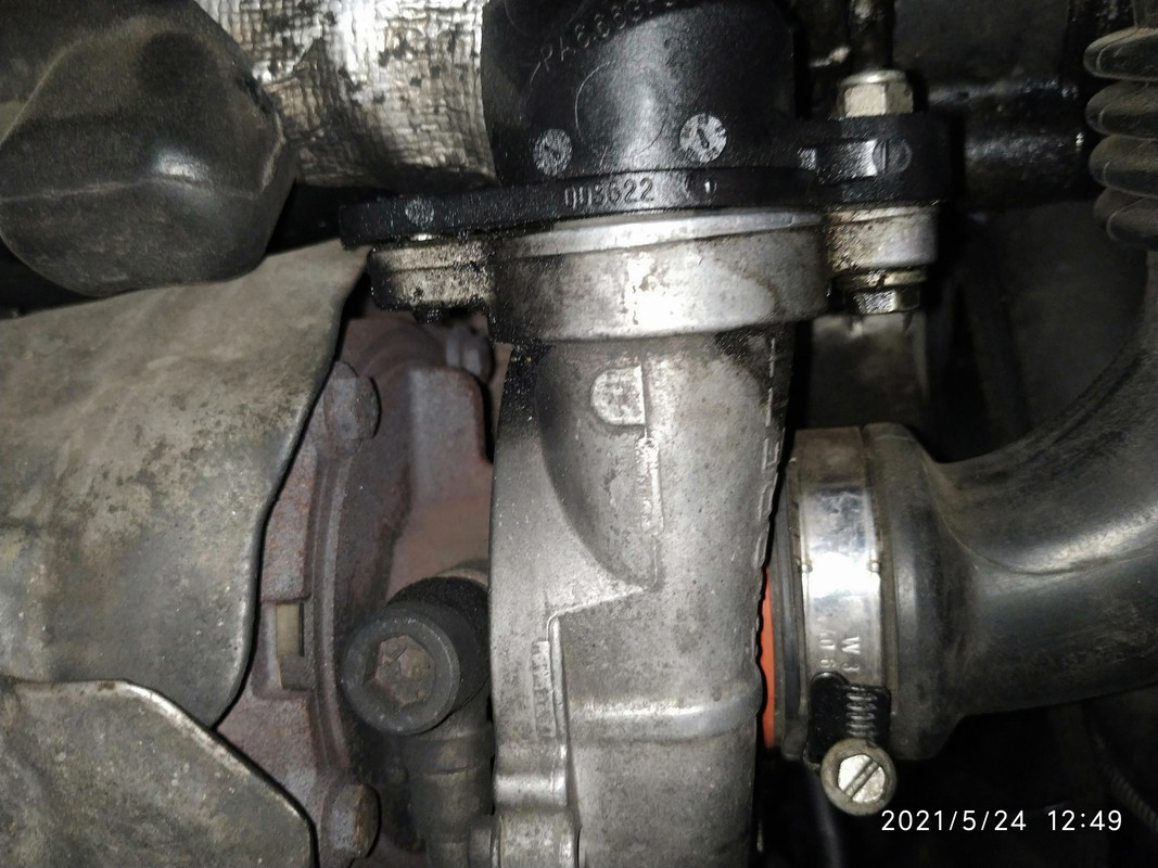

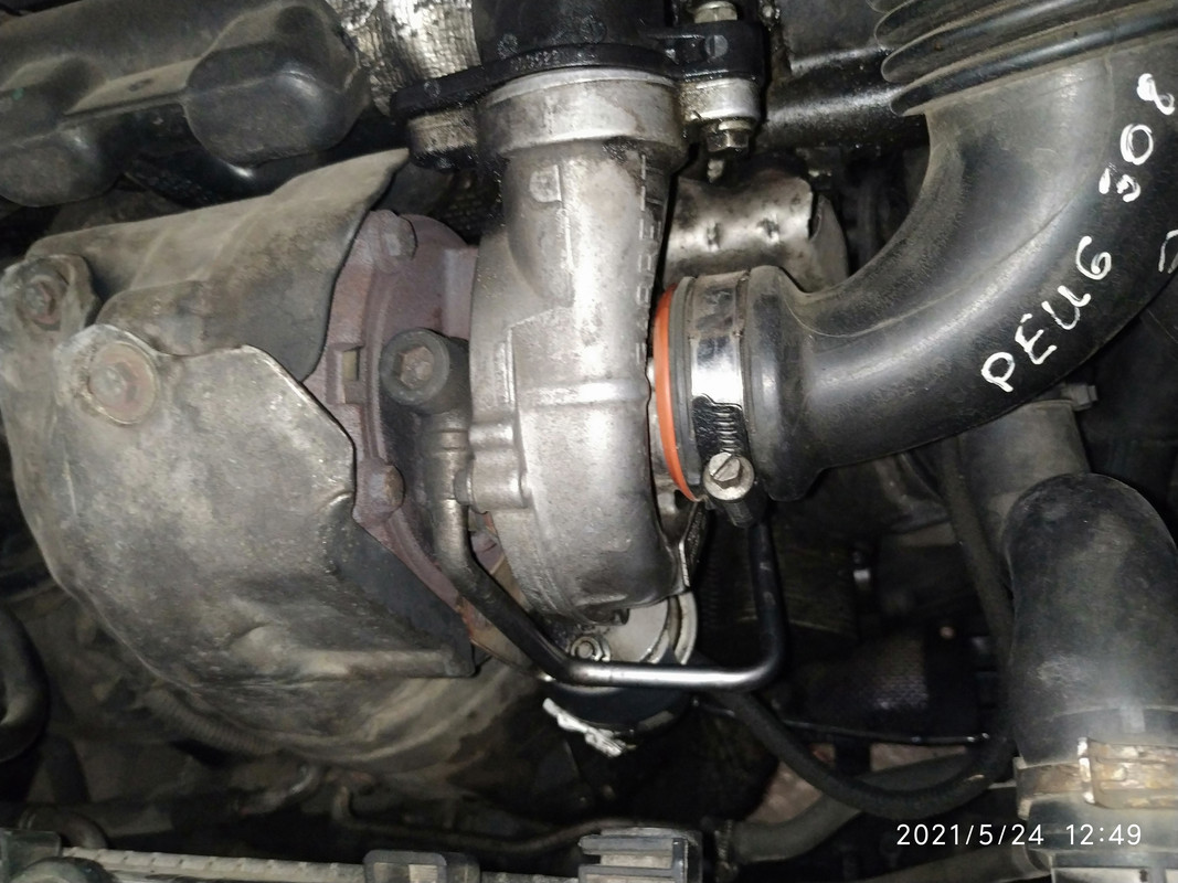

I decided to remove the metal protection and as you see in the video, the smoke comes from the connection spot of the exhaust with the turbine. And true enough, when it warms up, there is no more smoke.
Is there any kind of flange ( gasket?) in there? I tried to tighten or to loosen the screw on the necklace but it was impossible. Do you have any ideas?
