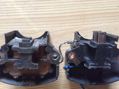

Took the alternator off and went off to the shop. They didn’t have one and after phoning some other shops said to leave it with them. I thought about it and instead got a brush set and a new belt. Now whilst the man was phoning I was looking at the belt...6 teeth missing. “Hum”, thinks I, “perhaps the belt was slipping, even though it wasn’t noisy”. Get home, replace alternator and pop on new belt. 14volts.
It’s great news! I think the battery is ok too, will see how it is overnight. I’ll keep the alternator brush set anyway.

Balls! Alternator dead again. Maybe it fancied a little holiday. Back to trying to change brushes. Sigh!

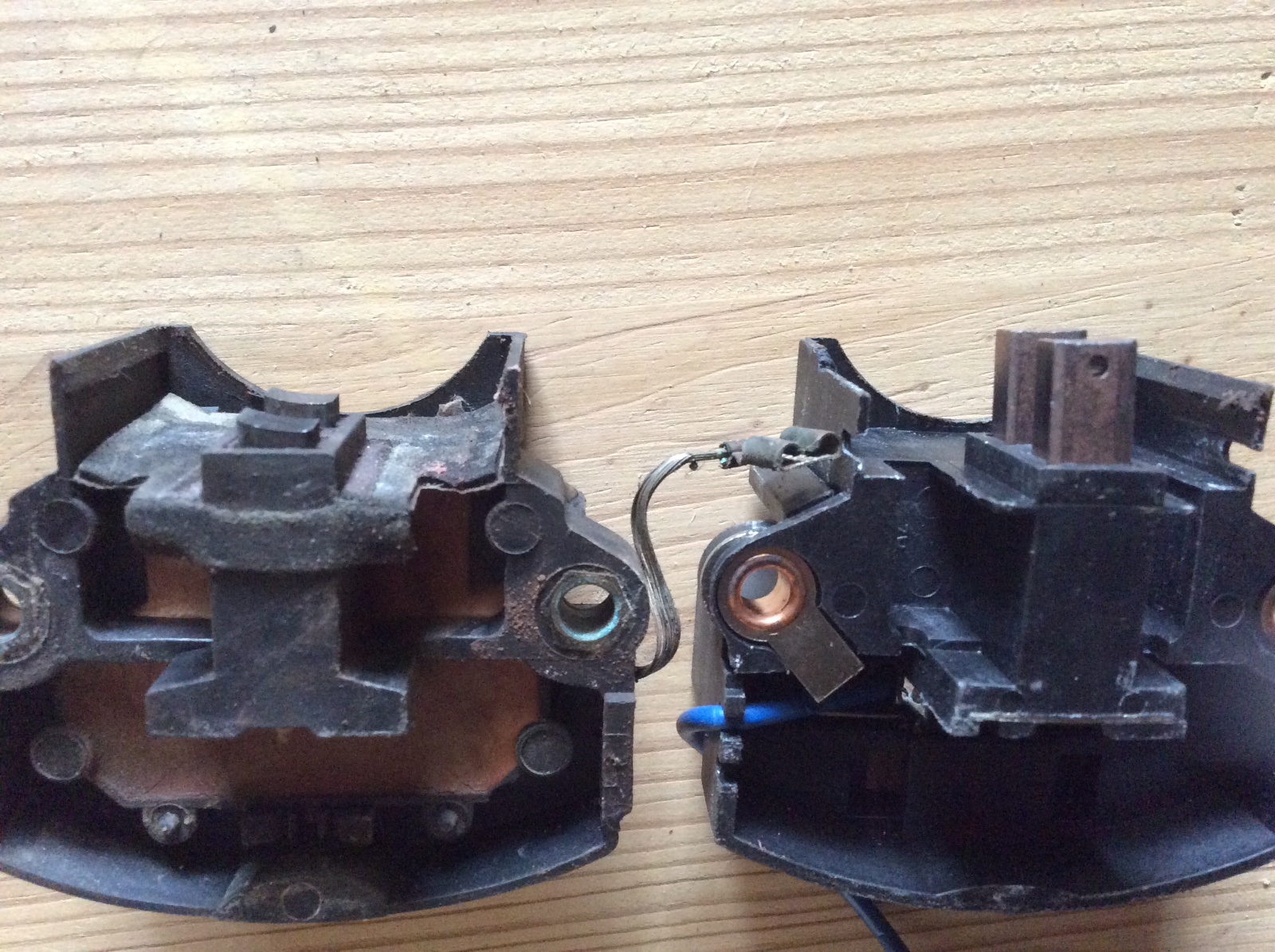

Brushes look worn. Changed them and the alternator is charging again, for now. Nice to have an easy job, on a relatively clean engine, trickiest bit was getting 16mm bolt (16mm?!?) past a bit of bodywork. How lovely to have a cheap repair too.
