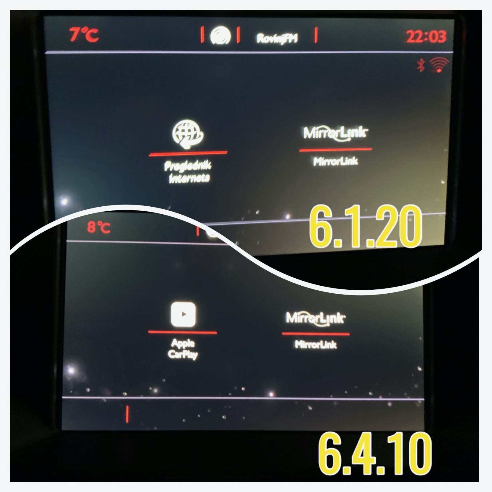

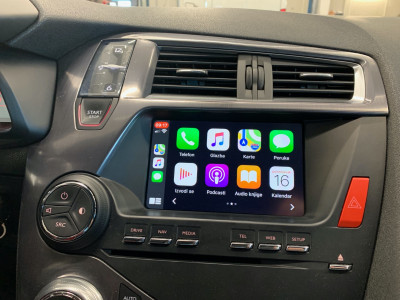

When I bought my DS5 (from June 2015) it had factory fitted SMEG+IV2 on 6.1.20 firmware. No CarPlay at the time.
I upgraded it to the latest 6.4.10 firmware and CarPlay icon apeared on the screen (instead of Internet browser) but had to see the dealer for activating the function (10 minutes job).
Was a great improvement and gave another level of functionality to the car!
